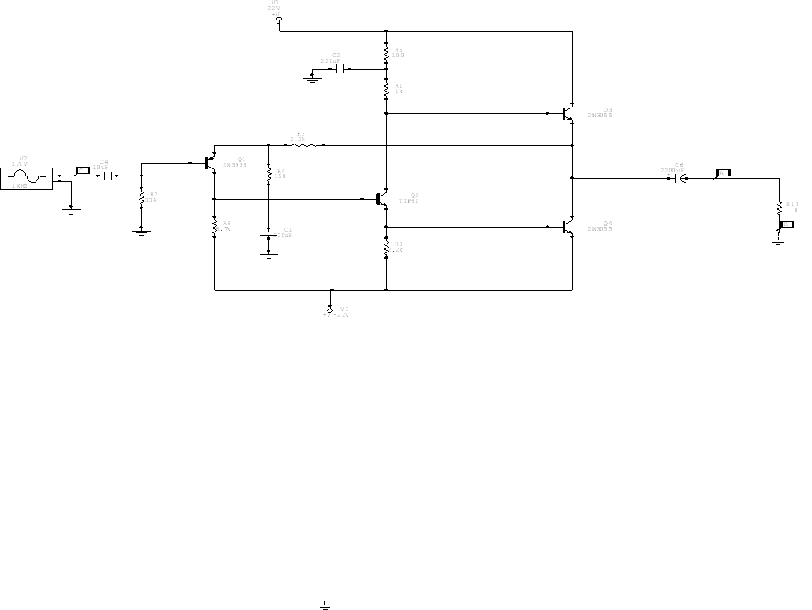

I run my JLH's on unregulated supplies and have no audible hum or hiss unless I put my ear next to the speakers which are composed of 2 94db/w 12 woofers,klipsch k400 mid horns rated around 104db/w and a panasonic 5x9 horn tweeter at 102db/w per speaker. The only time I find a problem with noise is when I turn on the ac and it draws a large initial current which drops the supply a few volts then back. Attached the scematic that i use which is a very mildly modified 69 version.
jerluwoo said:I run my JLH's on unregulated supplies and have no audible hum or hiss unless I put my ear next to the speakers which are composed of 2 94db/w 12 woofers,klipsch k400 mid horns rated around 104db/w and a panasonic 5x9 horn tweeter at 102db/w per speaker. The only time I find a problem with noise is when I turn on the ac and it draws a large initial current which drops the supply a few volts then back. Attached the scematic that i use which is a very mildly modified 69 version.
What voltage are the rails, what Iq and how much capacitance?
I'm hoping to get away with 60mF and 3A Iq, which I estimate will give about 500mV ripple. I've never seen a figure for PSRR for the JLH, any ideas?

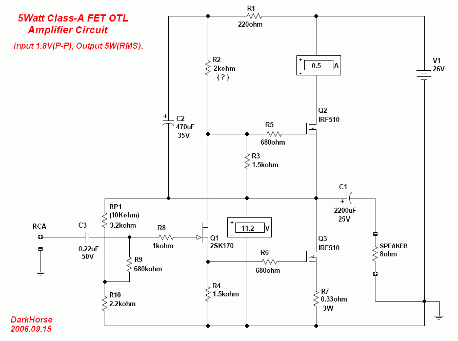

DarkHorse said:What About This Class-A(B) Mosfet AMP?!
Does that really say 6% at 3.5 watts?
Hi,Nelson:
I was wrong with the Iq of Ouput stage,Because IRF510's GM about 1S or a littel more above 1S,so I should adjusted it to about 0.5A(Iq),it can proccess more output power and decrease distortion.
I build the last version last night,when I finish the work, it was too late(midnight),even today is sunday,but I have my overtime job...
only can wait for tonight,I can carry on my project of this small amp.
the circuit I build:
