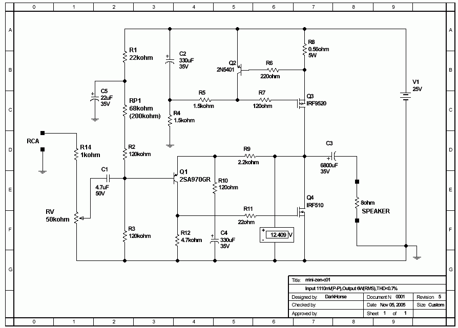

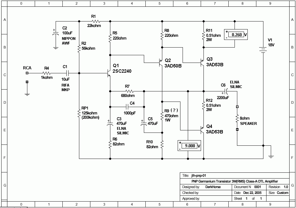

hi,everybody,I'm back...
many days and night I researching the "SIMPLE" amp circuits.
mini-zen2 is one of them. I draw the schematics and build one,
it's fine,it sounds good!
and I examined that the bass can be process.my experiment is the R10's value is important.
certainly NFB also has great effect.effect your hearing sound...
so thank you all who let me know that JLH1969 can process bass well...
enjoy!
WINCO
