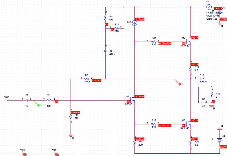

Here is my implementatio of the PLH.
a few observations:
a) the amp porformed very well and tracked the JLH1969 well.
b) the gain is quite sensitive to the phase splitter used. I got 10x gain with irf510/610, but only 4x with other irf540/p140 and mje15032. Not sure if it is a model problem or there is something special about the irf510/610.
c) the use of a current source as the load helped improve the gain. However, disortion goes through the roof if the amp is not biased in class A. the bootsrape network offers comparable performance but allows the amp to be biased in class AB. To me, that is a superior arrangement.

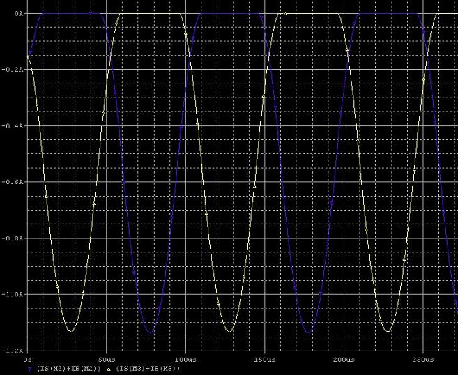

tlf9999 said:a chart of current going through the mosfets.
Nice class AB operation.

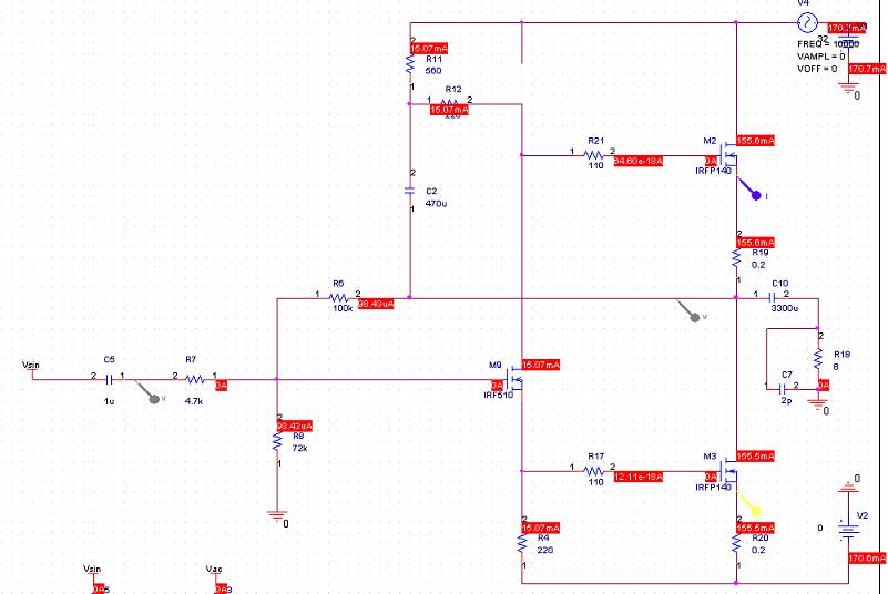

played around with the input stage a little.
With IRF510, the gain starts to dip at 10khz, and phase shift is quite excessive: 70 degrees at 100khz. However, distortion is almost non-existant.
With 2n5551, the gain stayed flat all the way to about 100khz. and phase shift is about 30 degrees at 100khz. However distortion is just shy of .5%.
I am a little torn between using a small signal mosfet and a fast BJT. I will try to listen to both this weekend and see how they sound.
