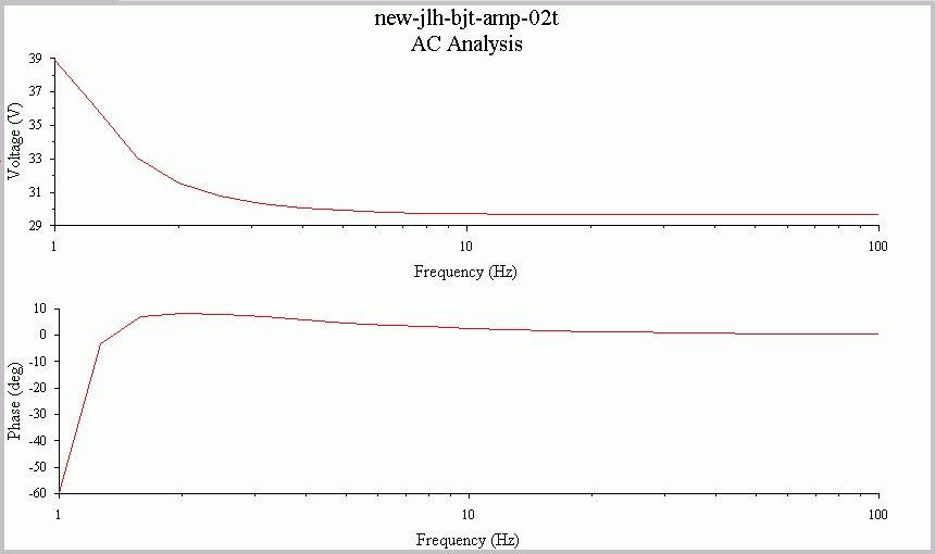

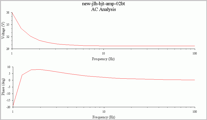

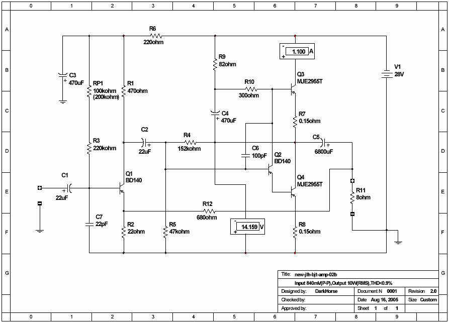

Hi,Mr.Graham:
I do simulation with my circuit lastnight,and I got almost same result like yours,so I find that the Q1's base conection has something unreasonable,so I make some modification to it,now it's output curve and phase offset is more reasonable.and I don't really know why you not accept it's low frequency response,but I think it is OK in this range(10HZ~100KHZ),because most speaker was not good at process bass,this amp let bass be a little strong can make your listenning be satisfaction.
compare to JLH1969's weak bass,I like this more...
and what will happen while I let 2*C within the NFB circle?
TIM or time delay?you had said you build the amp like this topology,you have experience to tell me about it,thank you!
have fun!
WINCO
this is AC analysis of 24V PNP version:

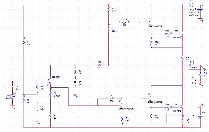

hi,tlf9999:
I feel surprise too,why your & some other's JLH1969 can process good bass,but some say it need very large output capacitor...???
what I have build and unsatisifly is this(you can see it's input stage & NFB same to JLH1969):
http://www.diyaudio.com/forums/showthread.php?postid=682527#post682527
and this is output graph:
http://www.diyaudio.com/forums/showthread.php?postid=686717#post686717
my CD is SONY D-EJ955 walkman,I don't feel it has problem with it's line out...
from the graph,you can understand why I surprise,because they are on the same way,so I surppose that the JLH1969 can't process good bass...
wait for your reply!
regards!

DarkHorse, your circuitry should work. my initial observations:
a) the gain is very large, at ~40x. If it is driven by a portable CD player (that usually output more than 1v on lineout), you may have reached clipping -> excessive high frequency which sounded dry -> appearance of weak base. Try to dial the gain back a little. I would set it in 10x range -> use a 1k resistor for R5.
b) One problem with MOSFETs is that they need adequate Vds. I have found that you need about 5-10v for they to work comfortably. so in this case, i would look for about 10v peak output -> suggesting a 10x gain for the circuitry.
c) I am not familiar with the jfet used here and I would suggest that to be safe, you use some resistors here. I would replace Q3+rp2 with a 4.7k resistor, Q4+rp3 with a 3.3k resistor. This will set the DC output to about 18v.
d) make sure that jefts are working in the right operating range. I cannot simulate them so I couldn't tell.
For comparison, here is my version of JLH1969. It has worked very well for me.
Like yours, it runs at 36v rail. the input stage is a little hotter than yours. the output stage uses two transistor drivers because I am using much beefier MOSFETs and those drivers wouldn't be necessary if you are using irf510.
- JLH 10 Watt class A amplifier
