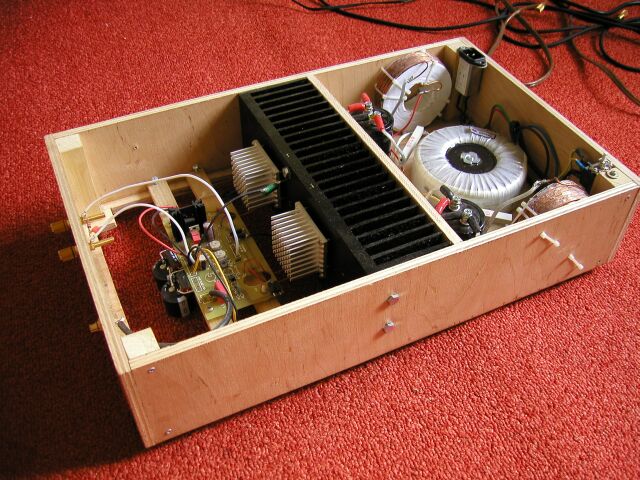

Finally had some pictures taken of my JLH'96 variation
Featuring slightly modified schematic an my work in progress LC filtered power supply....
Ergo
Breaking in JLH for ESL
I'll call this 2002 JLH 15W Class A.
Just finished, bias at 3.2A, no DC offset problem, after 2 hours power on the DC measured at output is -0.1mV on one channel and -1.2mV on the other. Transformer gets rather hot.
Initial impression of sound quality compare with my dismantled 1996 JLH; When listen to the Shefield Lab test CD, big improvements. Other cds the bass is very detail and solid, especially those quiet/distant recorded drums do not get smear by the main loud passage. But the vocal does not have the tube sound like voice as my previous 1996 JLH. The top end/ high frequency is getter more open up/ dynamic everyday pass. It's been only 15 hours listening time so far.
Chris
