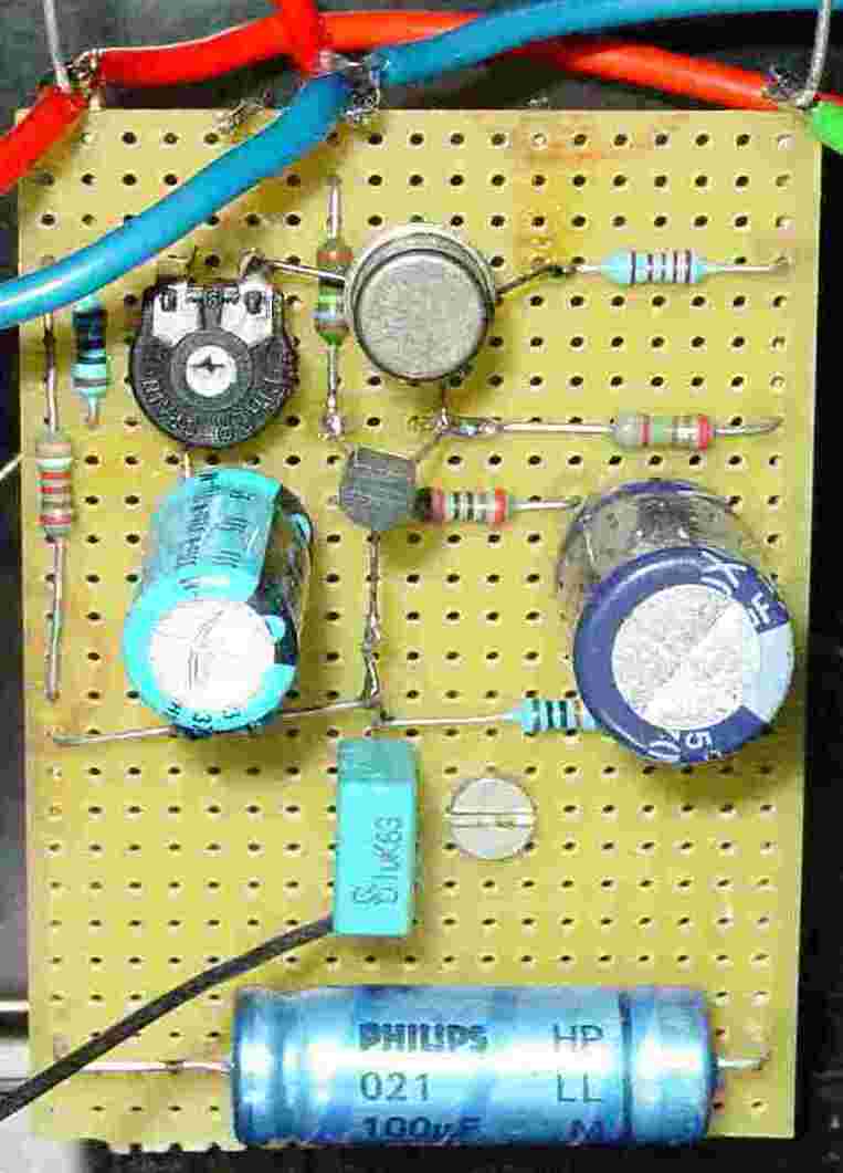

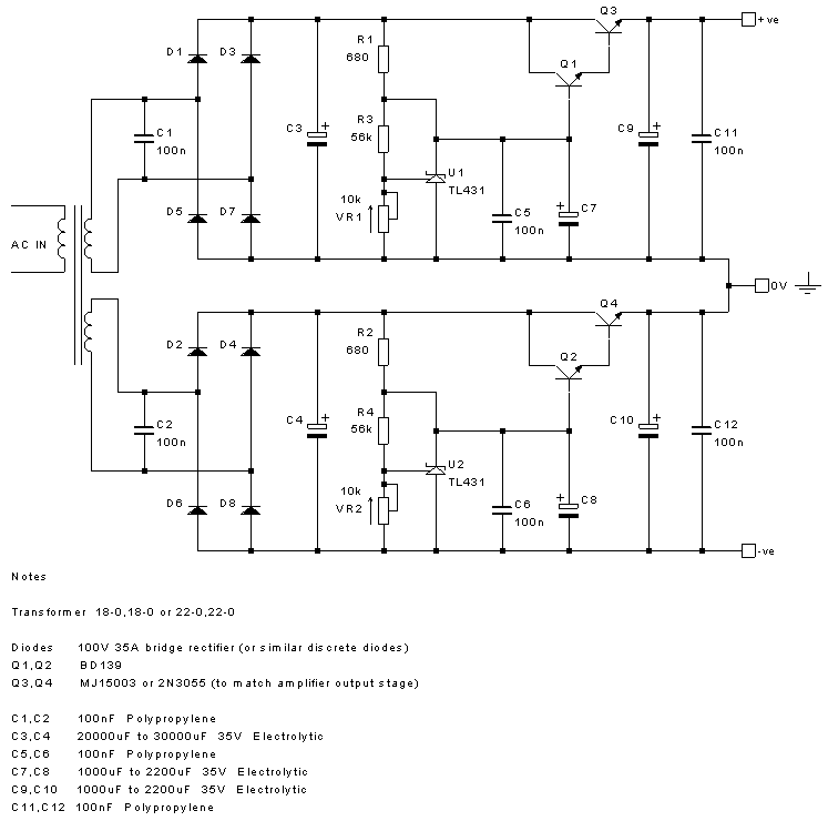

chris ma said:NickC,
Sorry I lied, the transformer I am using is 300VA 22-0-22 not 18-0-18 as stated previously.
I used the variac to bring the amp up slowly and monitor the components and the heat along the way, so I get a rough idea what gets hot and what not in the first place. Most of the time people get burn is the unexpected contact, like I tend to burn myself when I change hands with the soldering iron, just grab the metal part of the iron instead by mistake.
How is your project coming?

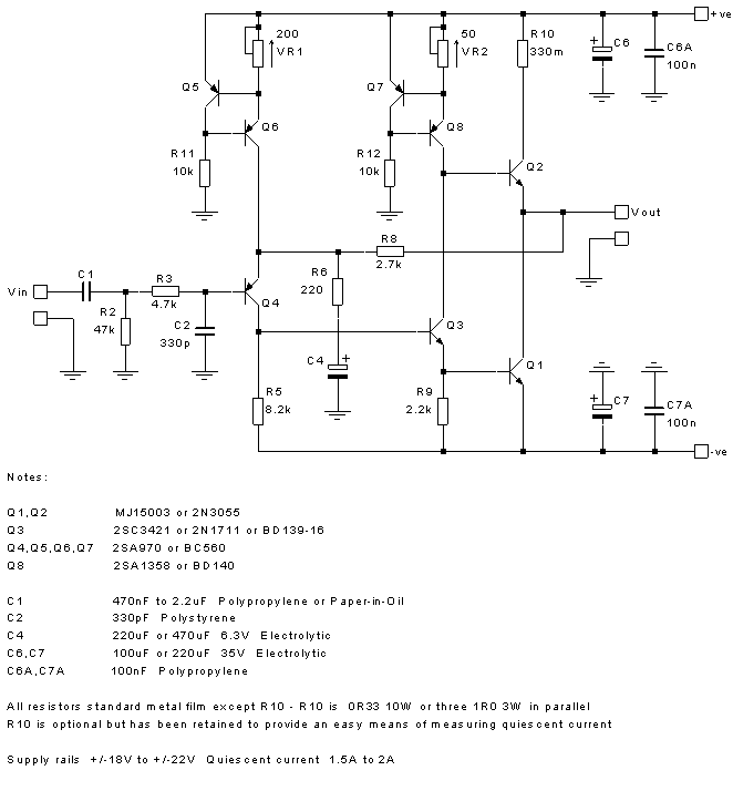

JLH 1996 version modification results.
I think I will elaborate a little on my previous post in this thread.
The following is a list of the modifications that, with considerable help from Geoff Moss, I have carried out over the past year on the 1996 standard version of the JLH, and my opinion of the results of those modifications. Each substitution has been carried out individually to enable subsequent and hopefully accurate (but not always positive!) evaluation.
Professionally, I have a very close affinity with the piano, a difficult instrument to record, as well as reproduce. It is my view that any modification that produces a more realistic rendition of the complex and sometimes very subtle structure of the sound of this instrument, will also represent an improvement in the accuracy of the amplifier in general, as has been the case during all my listening trials.
Amplifier.
1. Replace 2N3055 with MJ15003.
2. Replace 2N1711 with 2SC3421.
3. Replace BC212 with 2SA970.
4. Replace 7815 with constant current source.
5. Replace Iq control circuit with bootstrap (Elna Silmic) circuit.
6. Replace Iq control circuit with c.c.s.
7. Remove 470uF Oscon (previously 220uF Silmic) feedback capacitor, replace with link and change VR1 to 200 ohm.
Results.
1. Comprehensive and very substantial improvement.
2. Improved detail and smoothness with better defined tonal colour.
3. Similar to above.
4. Substantial improvement in both smoothness and detail. Improved low level ambience.
5. Less clarity with less tonal variety and focus, sounding more shut-in. This one was quickly removed.
6. Less 'lively', more natural treble with greater 'hear-through' quality to harmonics. Less 'impressive' but considerably more musically rewarding.
7. Greater detail and smoothness, better space and ambience.

Re: JLH 1996 version modification results.
Hi, Tim,
Do you have details on 4? Is it simply a constant current source
from the positive voltage rail to the emitter of Tr4 (which you
replaced with 2SA970)? If it is that, what did you do for the
collector of Tr4?
Finally, what is the Iq control circuit of 5 and 6? I've been
referring to Fig. 3 at http://www.gmweb.btinternet.co.uk/jlh1996.htm .
Am I even looking at the right circuit?
Thanks for posting your results. They are very interesting, and I
may well try building one of these amps before the year is out
using most of your improvements.
Thanks,
Erik

Erik,
The answer to your first question was posted recently by Les. My circuit is the same in most respects.
You are correct in your assumption that the Iq control circuit that was replaced in 5 and 6 is that of figure 3, http://www.gmweb.btinternet.co.uk/jlh1996.htm.
Incidentally, with the (standard 1996) circuit I noticed the most pronounced treble. With the bootstrap arrangement, the treble became considerably less pronounced, but slightly coloured, with a less subjectively extended bass and a homogeneous quality overall. The Iq ccs retained the clarity and open sound of the standard version but with a more organic quality in the treble, and without the detrimental effects of the bootstrap. However, I would imagine much would depend on the choice of bootstrap capacitor.
Tim.
