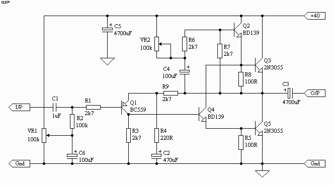

I was looking at Geoff site under the JLH index and click on the, A JLH Class-A for the Quad ESL57, link . The design and PCBs layout looked interesting and I was wondering if anyone out there (or is it in there) had built and/or listened to this verison?

If you are considering the 'JLH for ESL' version for use with normal speakers, the supply rail voltage and quiescent current will need to be optimised to suit the speaker's impedance.
A number of people have contacted me about doing this, but so far the only completed project that I know of is Nick Gibb's original.
As a rough guide, given adequate heatsinking, it should be possible to achieve around 40Wrms into either 4 or 8 ohm or 30Wrms into both 4 and 8ohm by the appropriate choice of rail voltage and Iq.
Geoff

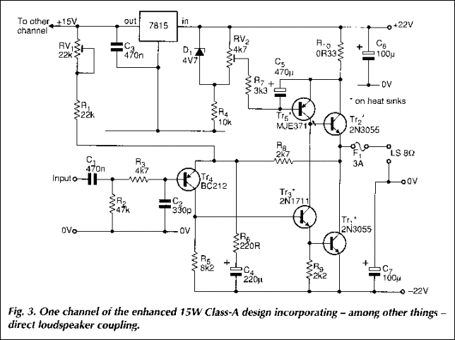

Geoff, I will refer to the schematic I have included:
There seems to be a bit of ambiguity as to the function of Tr2 and Tr5. This is caused be JLH's statement: "the design gave a somewhat lower distortion if the hFE of Tr1 was greater than that of Tr2. This caused the output circuit to act as an amplifier with an active collector load rather than an output emitter follower with an active emitter load." Are these transistors intended to add to the current gain of the output stage or are they supposed to act as a current source. I see in your version for the Quad ESL the two 2N3055s are most definitely configured as current sources.

Yes, Jam, you are right about C4. Harry has used the diagram from the original 1996 Electronics World article which was incorrect. I added a text note under the diagram when I posted the copy on my website pointing out the correct connection.
Yes, Nelson, the DoZ does bear a strong resemblence to the JLH. When Rod was developing his BJT alternative to the Zen he found that the best solution was to revert to a 30 year old design.
Harry, as I mentioned earlier in this thread, I believe that the comment you quote from the 1996 article must be read in conjunction with Table 2 in the 1969 article. The measurements that JLH made on the original 1969 amp clearly show that the best distortion figures occured when the output transistors had a matched and relatively high gain. JLH realised that, at the time the article was published, many constructors would not have the luxury of matching output devices due to availability/expense. He therefore tested transistors with different gains and found that lower distortion was produced if Tr1 had a higher gain than Tr2.
I will now throw the cat amongst the pigeons and say that simuluation indicates that a lower THD is achieved by having a higher gain for Tr2, though matched devices still give the best figures. So far I have preferred to believe JLH's measurements rather than simulation but if anyone has the necessary test gear to check out which is correct I would be most interested to hear the results.
The output stage of all versions of the JLH is basically that shown below. I have always been in somewhat of a quandry as to how to interpret the method of operation. Tr3 clearly acts as both a voltage gain stage and a phase splitter. Doug Self describes the circuit as Tr1 being a voltage controlled current source with Tr2 being the current amplifier. However, JLH refers to an amplifier (Tr1) with an active collector load (Tr2). Perhaps someone who has had some formal electronic education can enlighten me?
You mention an ambiguity regarding Tr5. All this is doing is replacing the constant current source with a current source that is set by the output stage quiescent current. This removes the output stage quiescent current dependance on output transistor gain which of course will vary with current and temperature.

I thought I had one till I looked at this circiut...... I wonder if a shootout between a version of this circuit with a true CCS and a true phase spliter quasi-comp output stage is in order. As the circuit stands I find it problematic in terms of output device matching and repeatable performance. I actually wonder if Mr. Hood truly understood the design.

That's a pity, I'd hoped you were going to enlighten me! I have another reference to this topology, gleaned from Wireless World in the early '70s, which stresses the need for matched output devices and which has one or two interesting variations. One of the variations is a very simple, three transistor, Class-A, unity gain op-amp power booster.
I'm sure the performance is repeatable since many thousands of these amps must have been built by now. Since setting up my website, I have yet to hear anything other than favourable comments about the sound quality, even when compared with the likes of the Hiraga, Leach, Zen, Aleph and many highly regarded commercial designs.
