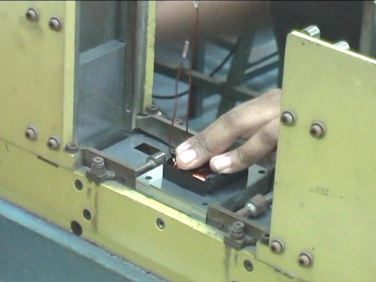

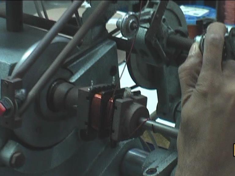

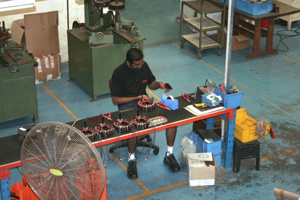

It's convenient to use a toroidal transformer for centre-tapped windings because they are generally wound with a folded pair of wires that inherently form a closely balanced pair with typically low resistance. That's not so easy with an E-I laminated transformer, where the windings are wound individually, one over the other or in sequence, along a divided bobbin. Operator variations also become an issue as they creep into the mix of power supply matters, so the decision to use one form of rectifier or another could also depend on the type and quality of the transformer you have.
Hi Ian, when the secondary are wound together it is called Bifiliar and the output voltages and current and resistance are exactly the same. I owned and sold majority share to the "workers" in one of my companies that made transformers (in order to retire). All transformers are wound on machines since the very early days and used counters to verify the precise number of windings. The toroidal winding machines (behind the guy that is attaching the fly leads) date out of the early 50s, and the process remains the same still today. EI and R core transformers are wound onto a bobbin, the primary separated from the secondary, then assembled into the E and I core plates loaded into a magazine and alternatively pushing an I core then an e core until filled. The only way to get the exact same characteristics of each secondary is by means of Bifiliar winding, else each secondary would have a different resistance and also inductance.

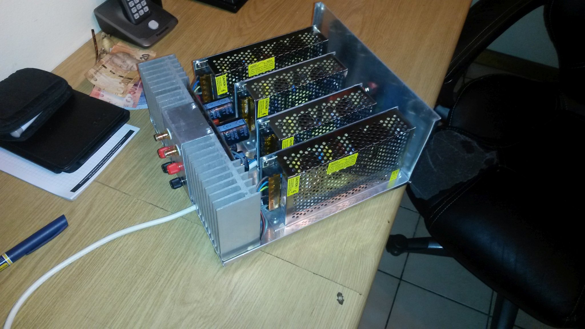

Here is one of the earlier JLH 1969 I converted to split rail and including class H using four SMPS's in order to preserve heat sink cost as well as increase power when required to some 40 watt. The power is switched between a 12-0-12 VDC and 22V-0-22VDC during high peaks. It worked amazingly well and preserved the class A operation at high power while the heat sink remained relatively small. These SMPS costs 1/8 of that of a heat sink for that amount of power.
I would like you to think about how you can do this with some block diagram, then we can all discuss this and develop the schematic for this application. It may be useful to many JLH fanatics lurking here, expanding what they already have. Spoon-feeding is too easy. Besides, it remains in line with the JLH thread. No disrespect intended, Veysel.
Thinking out of the box is something that I always encouraged, and I do not want to become the only contributor here.

Hi Nico Ras,
1. detesting the need to switch between the power supplies lower voltage to higher voltage and vice versa, and
2. switching the power supplies fast enough.
Re 1. Switching from the lower voltage current supply to the higher voltage current supply - perhaps this could be accomplished by comparing the voltage of the lower power supply to the voltage of the signal. Then, setting the threshold low enough so that the signal with highest rate of change would still not clip before the switch, thus arguably solving 2.
The disadvantage is that the switching may occur even when not necessary.
Re 1. Switching from the higher voltage current supply to the lower voltage current supply - perhaps a comparator with hysteresis, so that the switching would not occur when the signal varies about the threshold.
Kindest regards,
M
I have been thinking about it, although not "out of the box" because I am not very smart, and I think that there are (at least) two issues:Thinking out of the box is something that I always encouraged, and I do not want to become the only contributor here.
Kindest regards,
M
