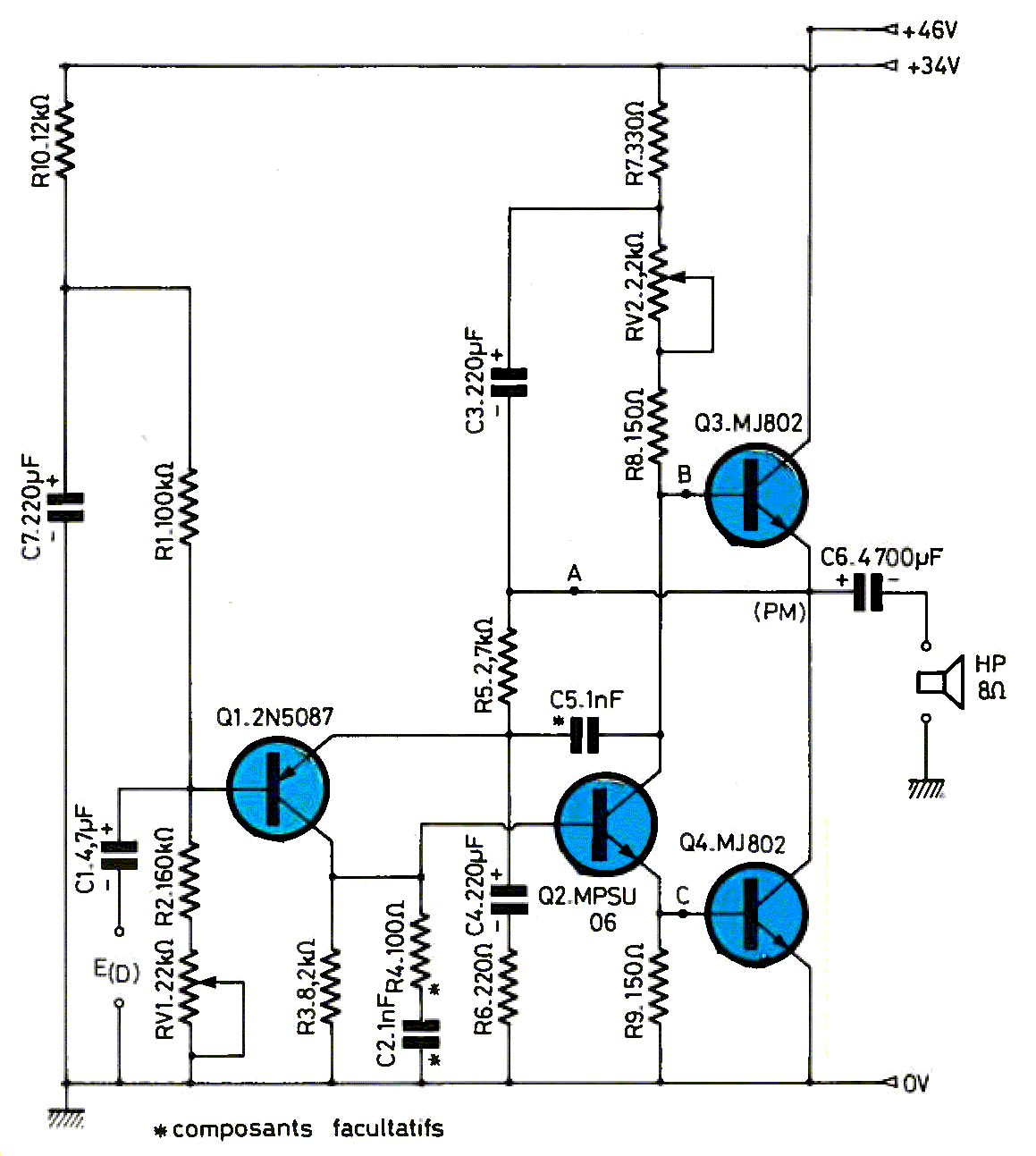

AjohnL, keep in mind that a capacitor multiplier does not replace the energy stored in high value capacitors, the instant energy has to come from somewhere upstream. You can only see it as a voltage drop with higher time constant. The capacitance is not really amplified by the gain of the transistor, although it might seem so. On a class AB amplifier, the capacitance multiplier has virtually zero effect. It is useful in class A when the current is virtually stable it will reduce PSU ripple. While used on an AB amp it may reduce hum at very low volume, but the amp sound will typically fall apart when high power peaks are a sudden requirement. I would suggest using a well selected reservoir cap that can produce the peak current, followed by a capacitor multiplier to smooth out the ripple.
I'm not convinced about the use of capacitance multipliers. Connecting a capacitor to the base of a pass transistor could, under fault conditions, dump its charge into the transistor, which would then most likely pass a huge current which might destroy it.
I agree with Nico too that it needs a current to establish a useful working state, but for reliability I'd recommend good old large capacitors.

John_ellis, I would agree with your statement and yes you see many amplifiers that decouples the front stages from the output and sometimes even have a higher voltage on the front than the output since these are very sensitive to any voltage ripple. The output normally has a gain of less than 1 would you hear the 70mV ripple modulating the output running from a simple capacitive filter, I think not.
cnbb, if you set up the power supply as suggested, then there are two obvious problems. The 1st is that you will never swing the output high enough to get the designed power from it, the 2nd is that any modulation on the output section will affect the driver section adversely. Unless you intend to use two separate power supplies, which is not a bad idea. Therefore, the frontend should have the higher voltage so even if the power stage drags the supply down, it would not cause the front to run into clipping. I hope it makes sense.

What I have done many times with amp power supplies is the exact same as mentioned above, but I always used a toroidal transformer since it is very easy to add a couple of windings (which is thin since it is low current) to generate the higher voltage for the front and driver end, Usually about 10V, in other words create a 10V tap higher than the power section supply. You will notice a marked difference in amplifier distortion as a bonus.

I would use the e.g. 46 VDC and adjust the resistors accordingly.

That is why Hood suggested it but obviosly there will be a voltage drop. It's not my fault that some one called them capacitance multipliers. How they work is pretty obvious really. The load on the smaller cap is just that needed by the darlington arrangement, For this use it's a pretty sensible option. The alternative would be a regulator,useful in class
This is a series active filter (BJT or MOSFET).some one called them capacitance multipliers
As a series regulator without stabilization (can be added).
