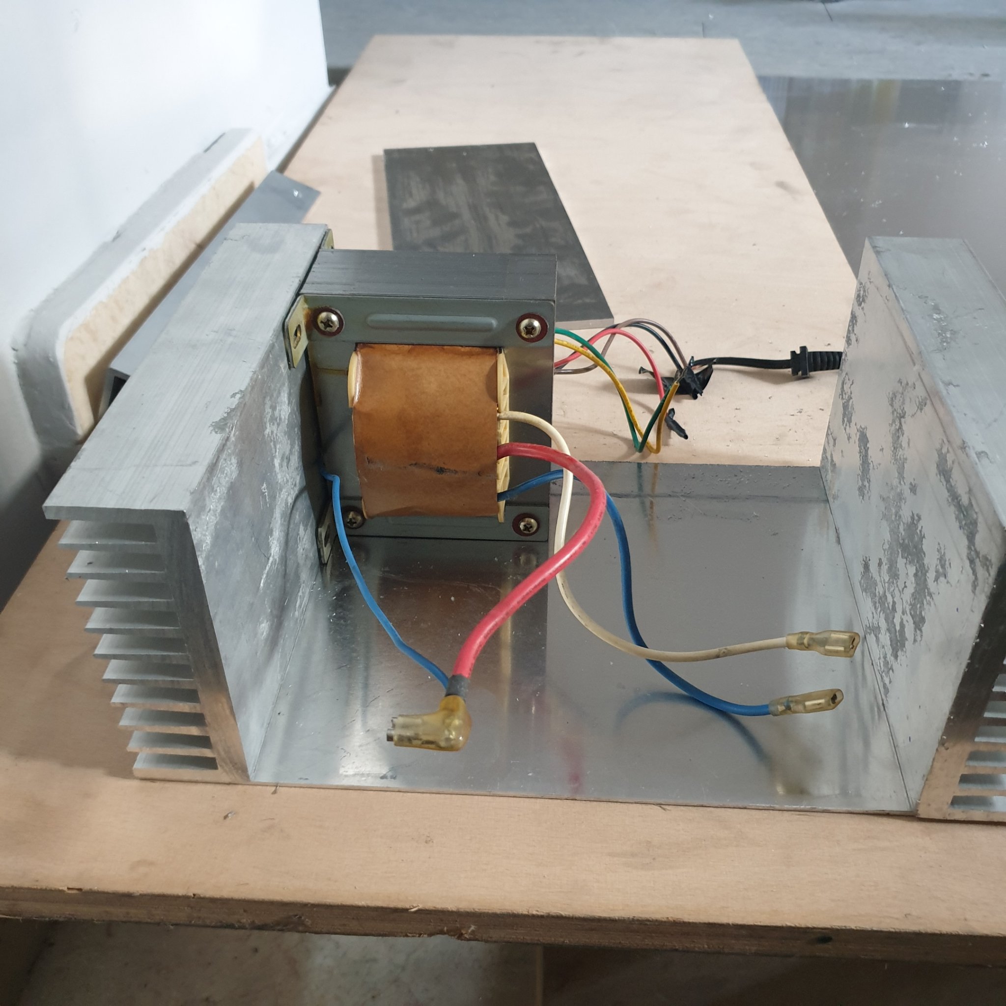

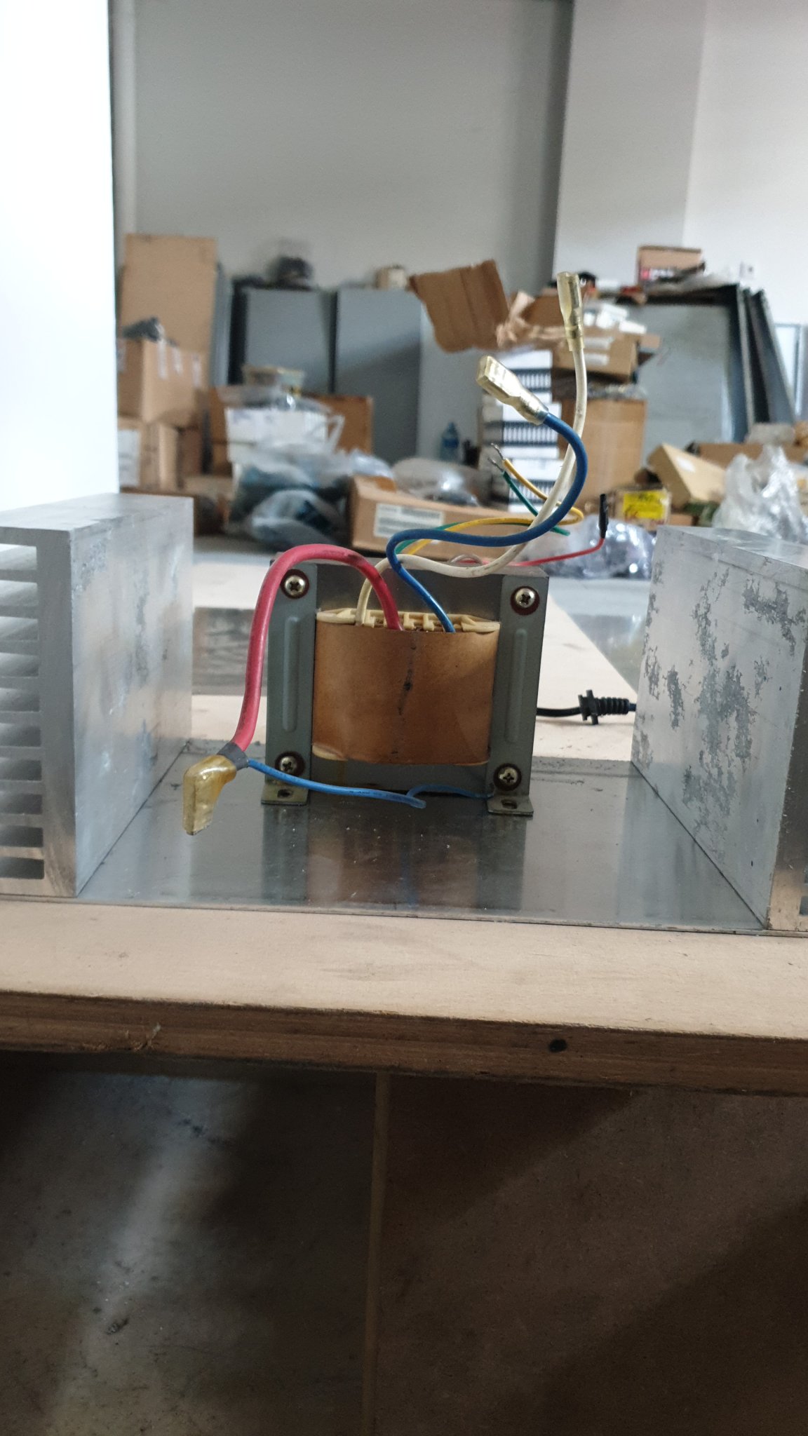

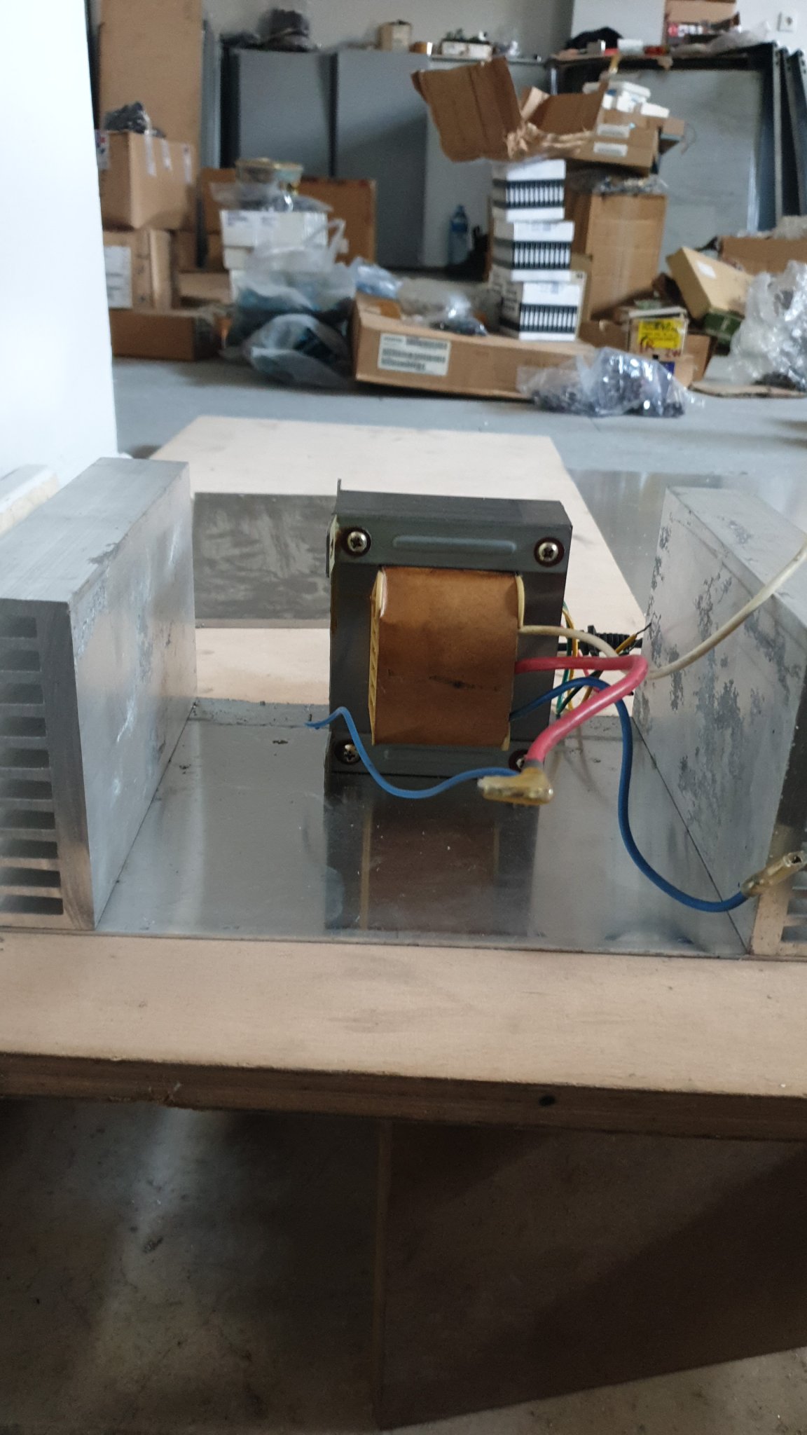

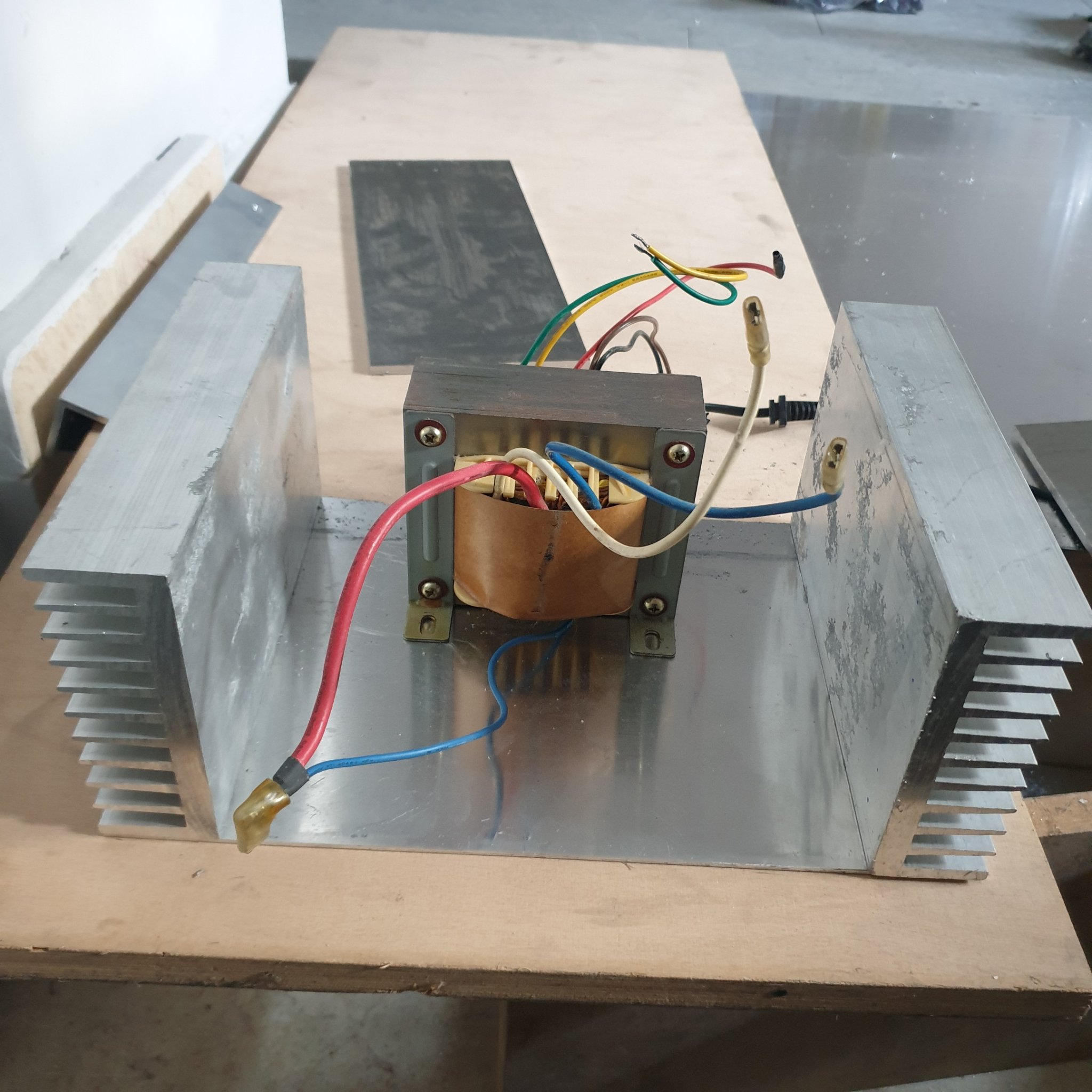

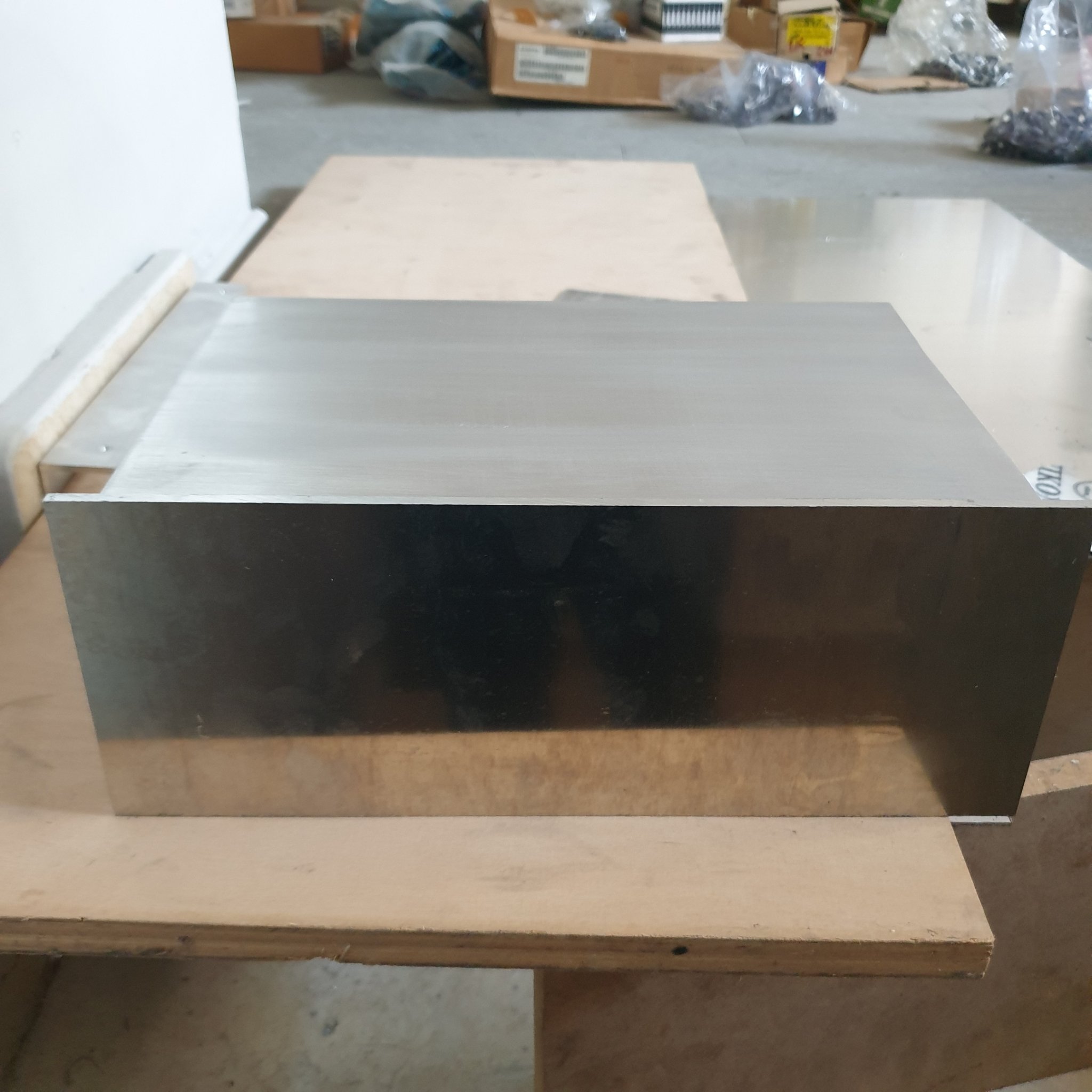

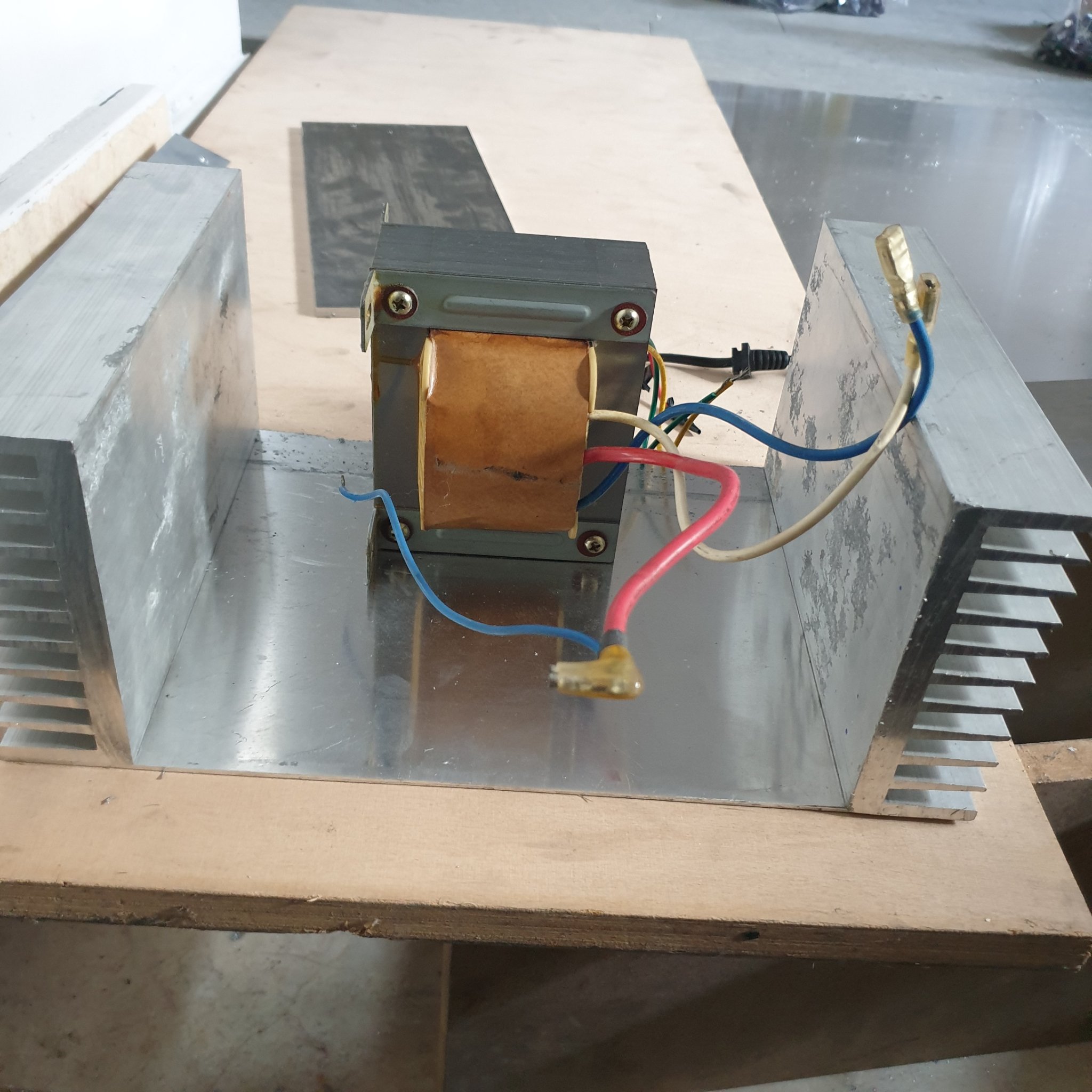

What about transformer position and location? I read vertical positioning the transformer reduces emi radiation by 4dB. Maybe isolating with thin aluminium sheet and make a room for transformer be better for shielding because it radiates more emi than toroidal transformer.Does touching top plate make magnetic loop? Maybe do not do because it is not stell.
Always think a picture worth many words , since you using aluminium as an enclosure, you may have a problem with Eddie Currents, personally I would insulate all panels & heatsinks & link them all together with a star earth connected to transformer then to your utility earth input to the enclosure.

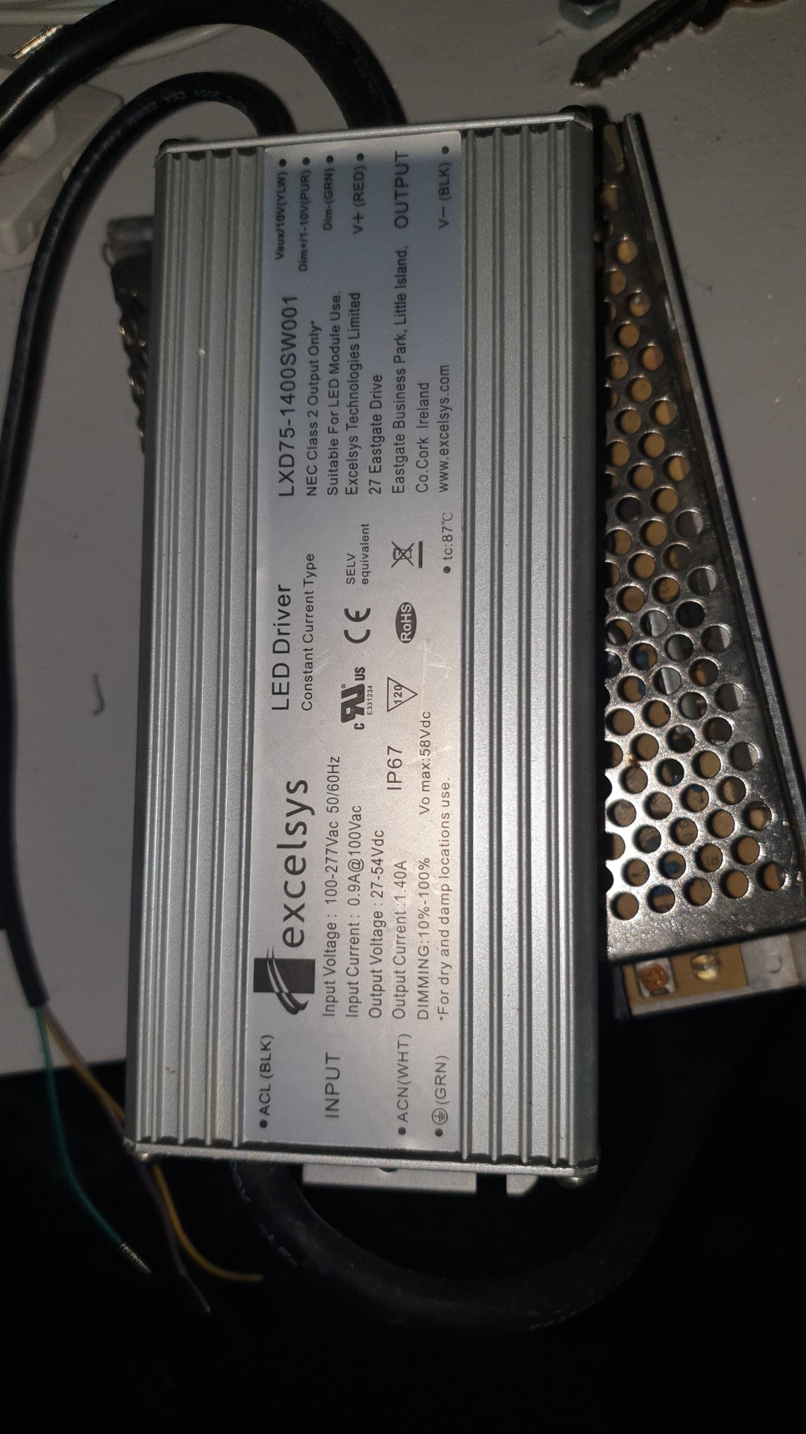

Your PSU would need to have only a fixed voltage output to make it a regulated power supply for an amplifier. You already know that the amplifier needs to draw a variable current, according to the fixed DC bias current+the AC instantaneous audio output current. Otherwise, if you have a continuous fixed DC current, you won't hear much audio. The specified transformer rating could be used to determine how big the PSU needs to be for whatever output voltage you require.
I think we can assume that for LED power, the 1.4A PSU limit is actually the maximum continuous output current rating of the power supply. If you use most of that current just to bias the amplifier, there would be little audio output, since that requires additional, modulated current capacity to drive the speaker with the full AC signal voltage also required.
