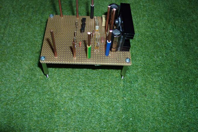

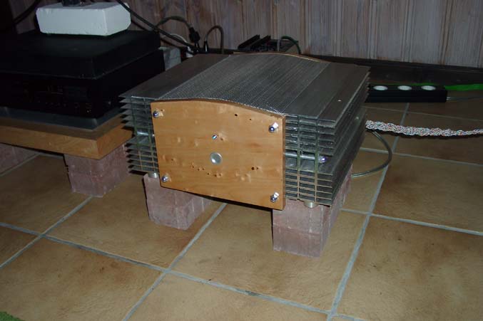

Here some pix of mine...

information....
this is the last attempt of building JLH.
I build 5 jlh`s last months.
with different parts quality:
1: standard part quality 30 watt
2: standard parts quality 10 watt
3: 10 watt w. audionote resistors/all transies matched
4: 10 watt w.dale resistors all /transies matched
4: 10 watt w.vishay s102k resistors/ all transies matched
Toroid is a 800 VA one per side
PSu is a capacitance multiplyer (no pic yet availlable) with Elna cerafine and BlackGate kapacitors.
The last one is the best - perhaps the Psu made the last difference.
All in all a very special amplifier, hard to beat in sound quality of any ready made expensive transistor or tube amp.
Thanks to all who helped me in building this amp.
Ralf

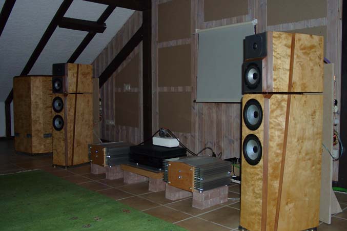

Holy Smoke Ralf,
5 pairs of JLH in a month! I did one pair in 15 months! You are going to beat Peter Daniel's productivity
:cool: ;
Congrates!
The two PSU I experienced so far, one is the exact layout of the regulated psu in the original JLH for ESL with very good parts, the other is the CLC standard parts. I prefer the CLC psu since they both provide the about the same sound quality, but the CLC psu runs a lot cooler and a lot cheaper, though it is also a lot bigger in size.
Can you show us the cross over board of your speakers, they look impressive!

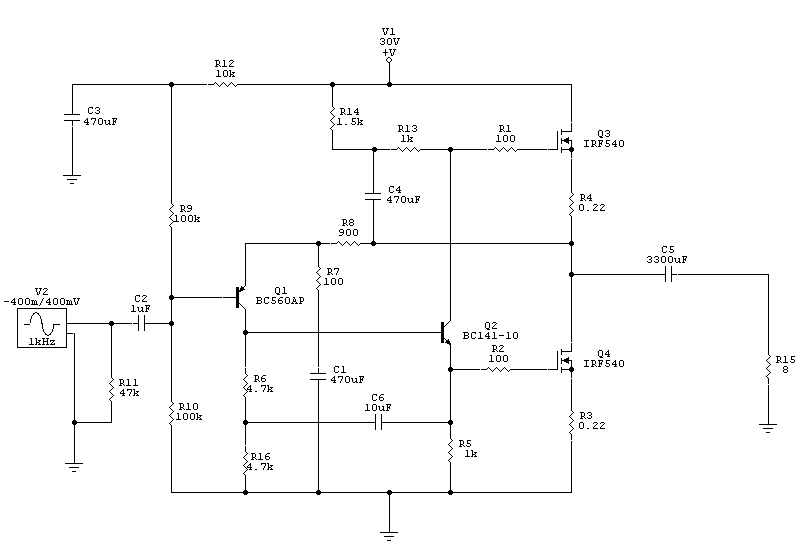

I did simulate quite a few versions of CCS to replace the bootstrap and I found no circuitry that will yield better THD figures.
That's weird... The MOSFET's are high impedance devices and voltage driven.. so there's no need for either a CCS or Bootstrap, .. it doesn't need current (or much less).. but there is a need for a voltage swing at the upper MOSFET gate.. .. this all seems very strange to me.. Are you sure that your amplifier works OK, have you checked the current swing through both MOSFETs.. they should be mirrors of each other... I think you just made a SE amplifier instead of a Push-Pull .. that would explain your low power and early but gracefull clipping...
Could you post a schematic with component values?
isn't that precisely what the bootstrap / CCS does for the upper MOSFET? providing high voltage gain for the driver.
at low Iq (for the driver), the upper half of the waveform distorts heavily: it is more like a triangle than a sine wave. This is very similar to if you feed the amp with a high frequency signal (like over 250khz). I suspect that it has something to do with the high gate capacitance of the IRF devices and at high frequency the capacitance starts to suck current away so if you idle the driver at high current it you minimize the impact of the gate capacitance (via its "current").
Best regards,
Thijs
it is post 515 in this very thread. the only thing changed is that gate stoppers for the mosfets (220ohm vs. 0.22ohm in the schematic).

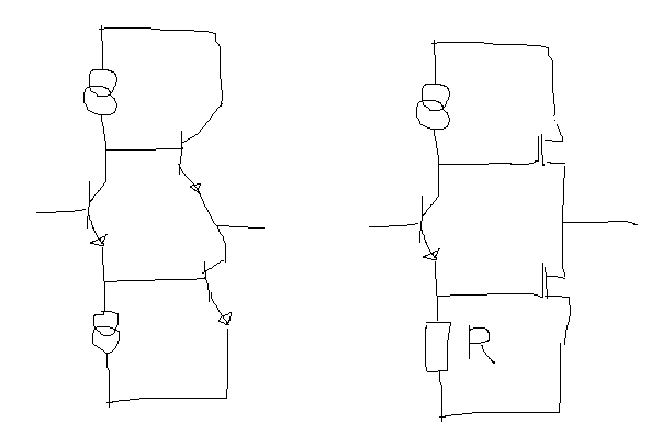

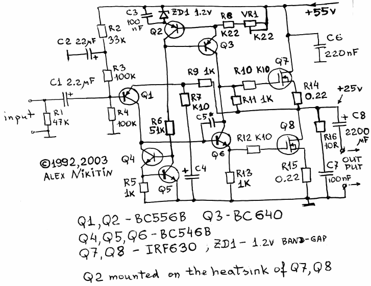

tschrama said:
I really hope someonemore knowlegbeble can comment on the BJT/MOSFET exchange in a JLH 10W Class A 1969 amplifier... it makes my head spin.. :spin:
Hi millwood and tschrama. I think I can feed you some information on this circuit and post here my own version of MOSFET development, somewhat based on JLH class A idea, which I've designed in 1992 and this amplifier still working quite happily in my daughter's room :) . Thought my amp was not built as class A, it could be easily converted into a proper class A amp by reducing the supply voltage and increasing the idle current - no other changes are needed for the circuit. I did publish this circuit in 1998 in the "Radiohobby" magazine as an illustration to a further development of it (a version of this later circuit could be found here: http://www.diyaudio.com/forums/showthread.php?s=&threadid=14320 ). The sound of this amp is very sweet... .
First, thought, a couple of buckets of cold water :) for millwood:
Your circuit loses a main attraction of JLH - it's symmetry. JLH is a proper push-pull circuit, working on the balance of the currents, as output bipolar transistors controlled by their respective base currents, and the driver redistributes the currents according to the signal. In your circuit, lower MOSFET is almost a current source, so the circuit is essentially an SE one. MOSFETs controlled by the gate-source VOLTAGE, so JLH way of control does not work. Also your circuit could be thermally not very stable and quite sensitive to the power supply variations and ripple.
Have a look at my circuit here and ask questions :) - I would be happy to answer.
Cheers
x-pro (Alex)

Hi x-pro,
Thanks for your reply. Indeed I has some concenrsns similar to yours, but I don't have it comppletely figured out yet... I really like the way you explain the topology .. redistrubuting current ..
I'll have a look at your circuits and I'm sure I have some, several, dozens of questions...
Mean while I have drawn the 'JLH 10W Class A Triangle output stage' (lets call it triangle in short) in simplified form to analyze.. one version fo BJT (assume equal Hfe) , and one for MOSFET (assume equal transductance)
I'll attache a drawring... maybe it helps ... maybe not.. :confused:
