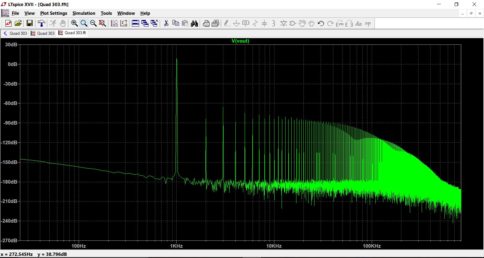

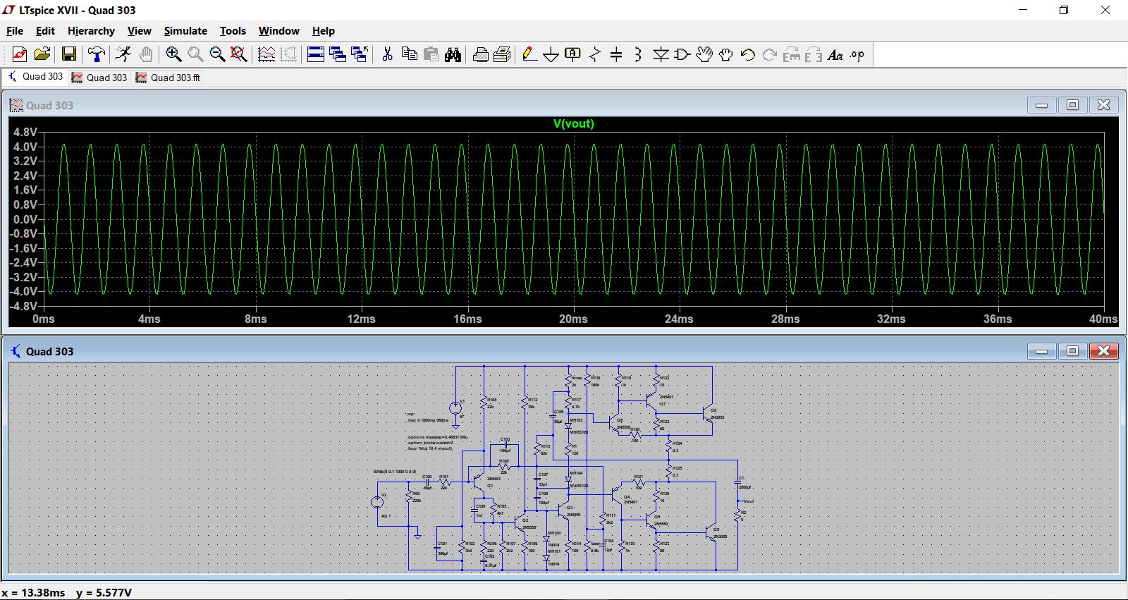

I have an old sim of the 303. Not outstanding was always my conclusion. This is at just 1 watt output, bias at 10ma (ish).

Quad Spot: Measuring distortion with software
