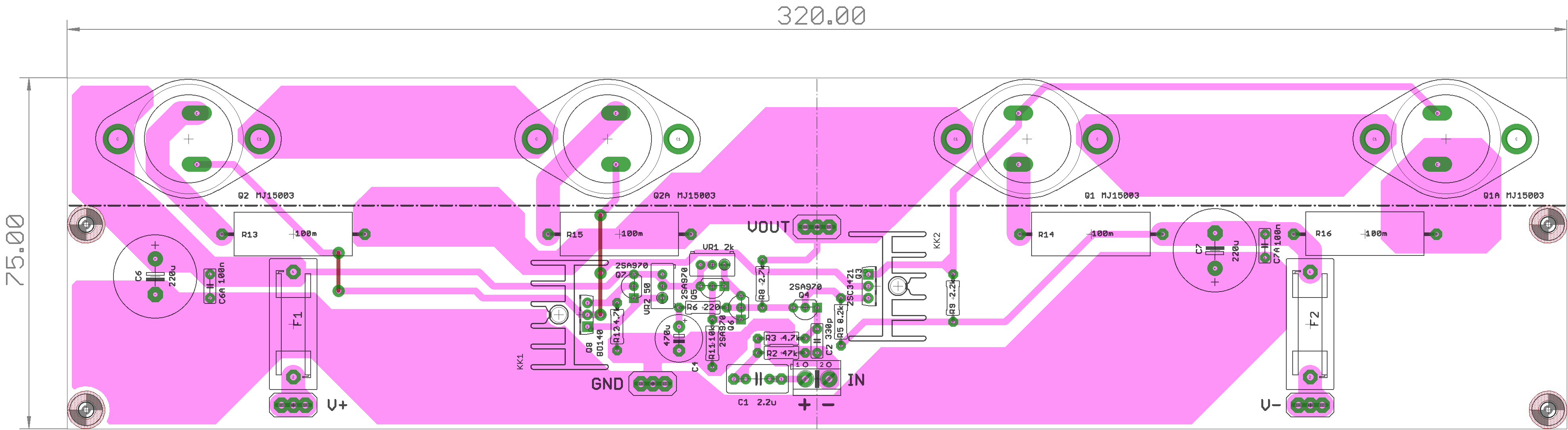

I hope some other people interested to build these amp not just me. We could do a small GB in that case, Otherwise only home brew PC boards.
It would be the best if you could make it about 32Cm long
Hi Gabor,
You are welcome.
Whats the supply voltage and how much heat its gonna dissipate? In my view 320mm long PCB would be too big and will have very very long trace lengths and may not be an optimized design.
Like the F5 layout that I did based on people's suggestions, would be more than sufficient to dissipate for this amp also.
Have a look here http://www.diyaudio.com/forums/pass-labs/307664-f5-layout-4.html#post5083531
It more or less emulates the DIYA store PCB dimensions. Ofcourse its single sided and with its limitations unlike the DIYA store 2 sided PCB's.
my2c, however, if you still like to go with 320mm PCB, I am ok with it.

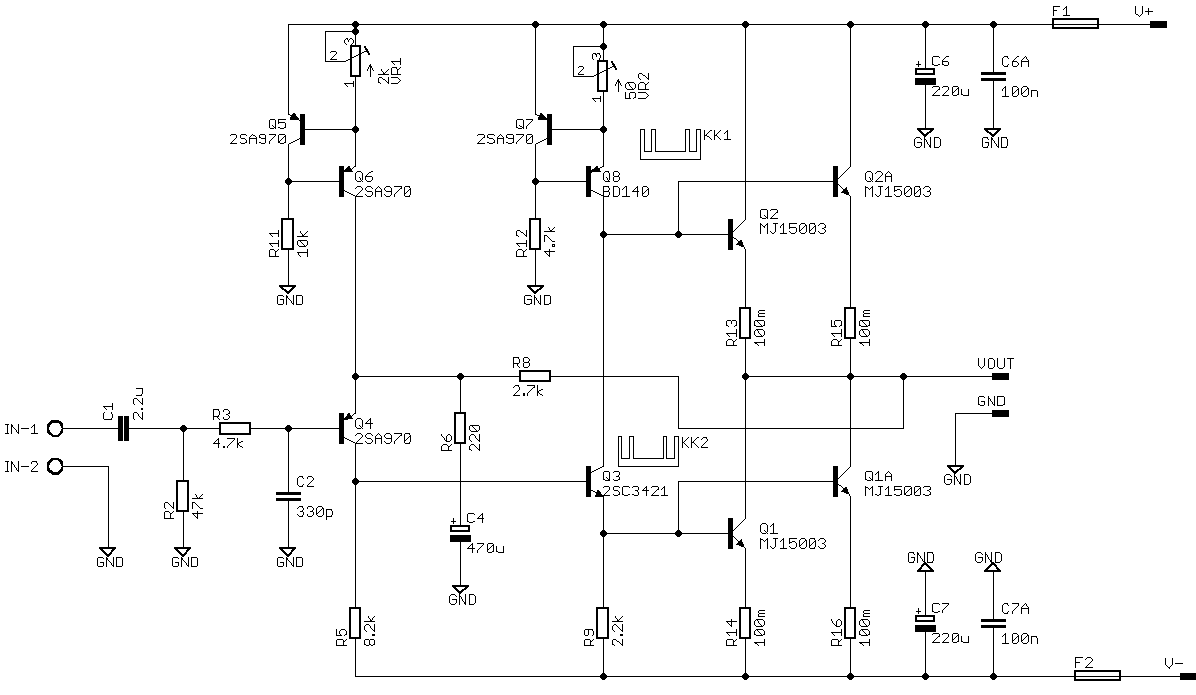

I attached the circuit my previous post. Dissipate - depend on the rail voltage one chose. I attache it again
That F5 you designed it look nice but these has 2 pair power transistor and if we stick to the TO-3 type (metal can) that takes up a lot of room.
I would still prefer long PC board like the original First Watt amps. If we must use wires to connect the transistors we can get that type of PC boards on Ebay very cheap ($12 pair free shipping) and already tested and built several by people.
What is in my mind something like these (see the attach) if is not to difficult
These way we could use some heavy duty L or T shape aluminium bracket for the TO-3 transistors
Only if is not to difficult to lay it out

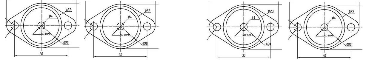

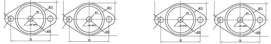

I attached some pictures from my heatsink and the best would be a long (32 or so Cm) type of PC board layout .
If one must use wires to connect the power transistors for better dissipation no need for a new design.

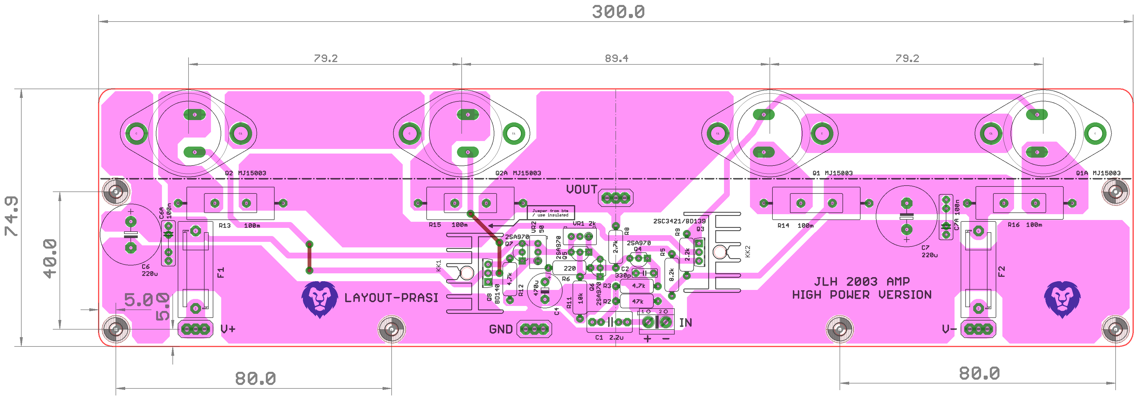

Dear all,
Here is a very rough draft; can someone tell me about wattages of resistors ? also whether TO-220 type heatsinks will be sufficient for Q8/Q3 ?
As I was afraid some traces that go to the base are too long. what can be done about it?
Any comments on layout welcome.

The heat sinks should be fine. I am curious why you selected the2Sc3421 instead of BD 139-16. Both works but in my opinion BD 139 sounds "nicer".
Regarding the length of traces, I don't think they will be a problem unless there is a big transformer in close proximity radiating large magnetic field. If it is a toroidal then you may need to wind a mu-metal screen, but don't worry about it until it becomes problematic.

Just a suggestion from me...
Give the opportunity putting footprint for MPC74 non inductance resistors in emitter resistors position .

Hi Prasi
It is definitely a great start, just waited to see if other people interested on the PC boards...
I have a couple request
Please keep the emitter resistors as long how it is now and if you can make it somehow so those who prefer the non inductive plate type of resistor they can use it. I would like to use these. I read some feedback they are great resistors..
10 X DALE LVR-5 0.1R 0.1 OHM 5W +/-1% NON-INDUCTIVE RESISTOR | eBay
The other think if you can make some more room for the input capacitor, some exotic caps are large for example these in in my mind.. But any 100V 2.2uF decent MKP caps has some size to.. 2 X 2.2 uf 450VDC MUNDORF M-CAP® EVO OIL Capacitors 2.2 uf (1 pair) | eBay
If is not possible we can mount the capacitor on the RCA connector. Not always the best idea but most of the time acceptable.
The other think and these in totally my fault, I went after the size of the heatsink.. Hard to get 320mm clad board. Can you reduce it to 300mm. Usually they sell it 300mm or 12 inches.
You can leave the two in the two power transistor on center where they are now just move the one each side (the first and forth) 10mm toward the center.
Thank you very much!!!
About the small resistor sizes it look like all 1/2W types.
Dale or PRP are 10mm the half Watt type.

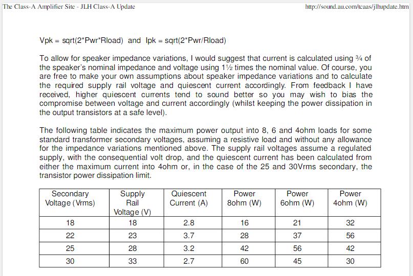

I have a question to you If you would be so kind
I have 3 at hand transformer for these project
1 2X28V 800VA
2 2x24V 500VA
3 2X20V 500VA
Which transformer would be the best.. The reason I ask because the amp biased into full Class A and here we no longer calculate based on the usual 1/3 rating..
Please if you would be so kind let me know your opinion...

Thanks guys for your suggestions,
here is how the fine tuned current version looks like (both type resistors can be fitted). Next question is how high can one go for rail decoupling caps? I have 7.5mm p x 18mm dia cap there right now. If 220uf is mandatory, I can put additional pads. Vishay RN60D can be fitted easily in the current version.
PCB sized to 300mm x 75mm, by only moving extreme transistors by 10mm. I have tried to fill it by copper as much as possible.
One related question, I didnt get answer by searching google. How thick the 4 traces connecting the ground pour to the pad should be, for high current traces?
regards
Prasi
Edit: regarding the mundorf cap, fitting that on PCB itself may lead to compromises in i/p section and grounding. Could check the possibility of fitting it in the same pads but somewhat hanging outside of PCB?
I prefer to use Wima / Epcos film caps in that position. barrel sized polyprops go in xover in my builds.
