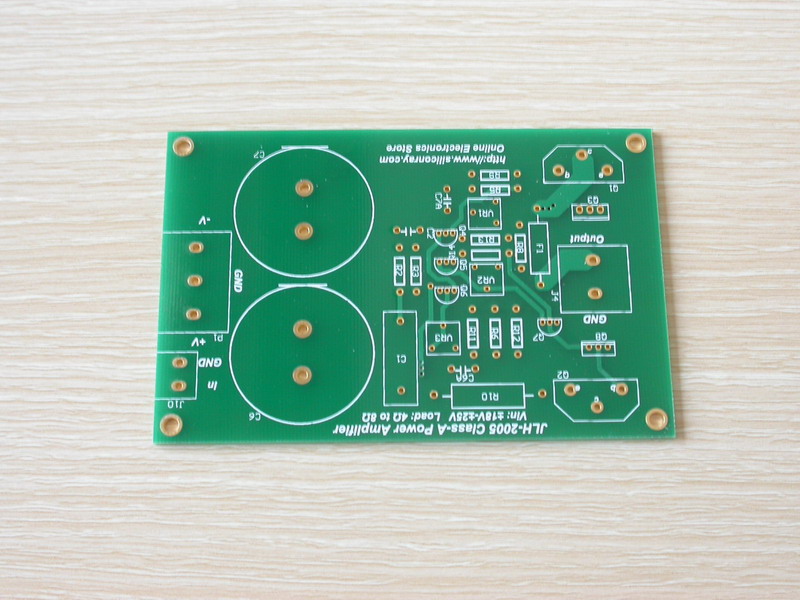

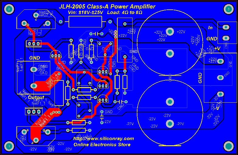

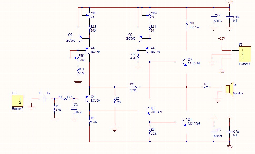

Added resistors in series to VR1 and VR2. If this circuit and pcb layout is OK I will make a small batch and offer some free boards for members.

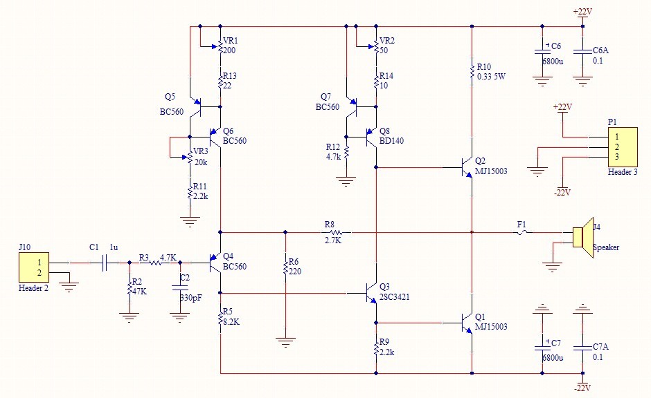

Testing Result
Got one soldered today. Overall the result is positive. Found some problems:
1. The VR1 should be 200Ohm (it was 2k on the schematic I posted before)
2. R13 should be 22Ohm (was 200Ohm on the schematic I posted beofre)
3. Pad hole of for BD140 is too small
Others are OK. I use BD139 as subsititute of 2SC3421 because it's hard to find. Supplied with +-18V, quisent current about 2A, 8Ohm load, the sound is quite good.
updated schematic is attached
problems on PCB will be fixed.
Keep on supplying free boards.

I am a bit concerned for the SOAR of Q8 BD140...
On the downswing, current and voltage here are
simultaneously quite high.
Not so much to blow this device instantly, and
maybe fine for half wave duty, but your peak is
well outside the lines for continuous DC...
Figure as much as 250mA if traditional 2n3055
were abused as output devices. And -48V peak
voltage at this collector. Then look the BD140
spec sheet... Maybe the lower base current of
MJE15003 saves your bacon? I'm just sayin...
With 4 ohm speakers and less capable outputs,
the bias required could take Q8 completely off
SOAR and into oblivion!
Q3 is under much less stress, even though the
current and voltage peaks are same. They are
happening in opposite phase... Here I wouldn't
hesitate to use BD140's compliment, BD139...

Maybe TIP32C in TO220 for Q8?
If you gotta fix the pad size anyways....
