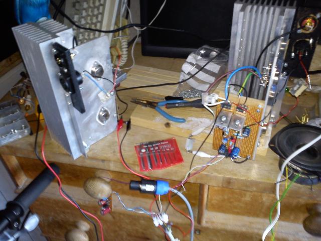

Just a brief update. Have built two modules, JLH 96 with MJ15003s. Module has its own input and output sockets (I'm using Speakons so it's harder to short the output), just requires power and 12V from a regulator for setting DC offset (might mount that in the module too). Needs a lot of tidying up (I need to use solder and heatshrink instead of chocblock for some of the joins :) ), but pretty good for a work in progress so far.
Going to get them cooking and ensure they have similar DC offset and Iq, then I'll have a listen in stereo for the first time !
Well, heard them last night in unison. Listening rather quietly (they're still in the garage - where I could annoy the neighbours), so Iq was about 1A. The PSU is unchanged, so 20,000uF per rail shared between the two channels. There is currently very little hum, not drastically more than when running a single channel. the 7812 regulator is feeding both dc offset settings. I had started knocking up a capacitance multiplier, but I'm not sure I'll bother now - maybe add some more capacitance.
I was impressed when I heard it as a single channel, but in stereo, blimey!
Even when the speakers are just 0.5 m apart, the imaging is pretty awesome. Singers and instruments are surprisingly well detached, and central from the speakers.
And this using a bogstandard CD player.
Now to build a chassis for it and the psu.

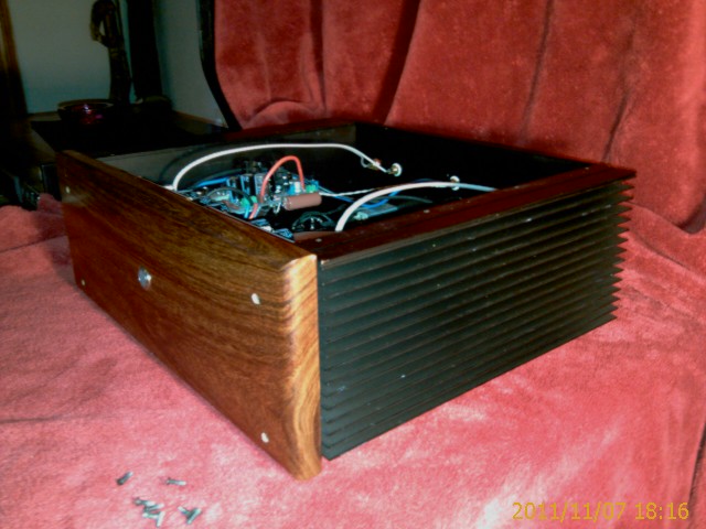

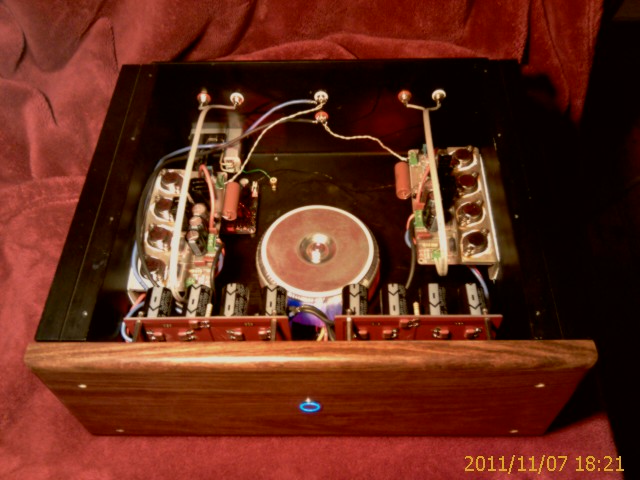

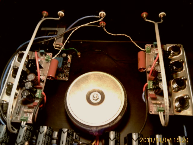

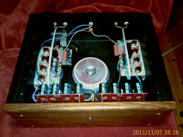

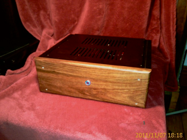

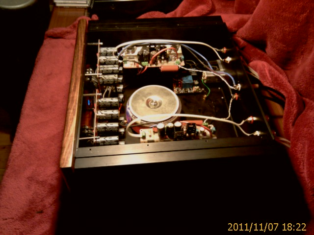

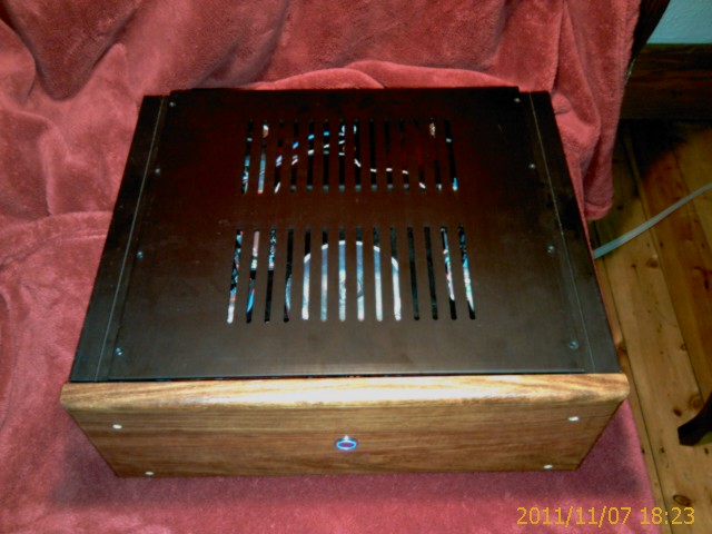

I just completed a high power derivative of the 1996 dual supply JLH design. By completed I mean in a box and I screwed the lid on last night. I actually completed it a while ago and was tweaking / playing with components and variants up to know. My wife said that as long as the lid is open I will never finish it. So last night I finished it :)
I will post some pics here soon. I think it is a very special amplifier and by using a few "exotic" components it has become a superb amplifier. If someone is interested I could list a few of these components.
It is delivering around 50W rms into an 8 ohm load as I have it running on 35V rails and a quiescent current of 2A.
I have compared it to other bought and modified amps with A/B listening tests and it outshines them easily.
Here are some pics taken with my cellphone so the quality is not great.
Components I used that I call exotic aren't really exotic but are not components you will get from the local "Radio Shack" but are freely available on the net. Each component I will list here made an audible improvent, some more than others but changed the amp from good to great.
Starting from input of one amplifier:
Jupiter 6N 26 gauge hookup wire
Russian paper in oil K72 0.47uF capacitor - high-pass filter at input
Silver Mica capacitor - low pass filter at input
Tantalum type resistors in signal path - input filter, feedback and gain resistors
All other resistors Audio grade carbons
Toshiba transistors except output which is MJ15003
CCS capacitor - 100uF Nichicon FP low ESR
Feedback cap 470uF Elna Silmic II
