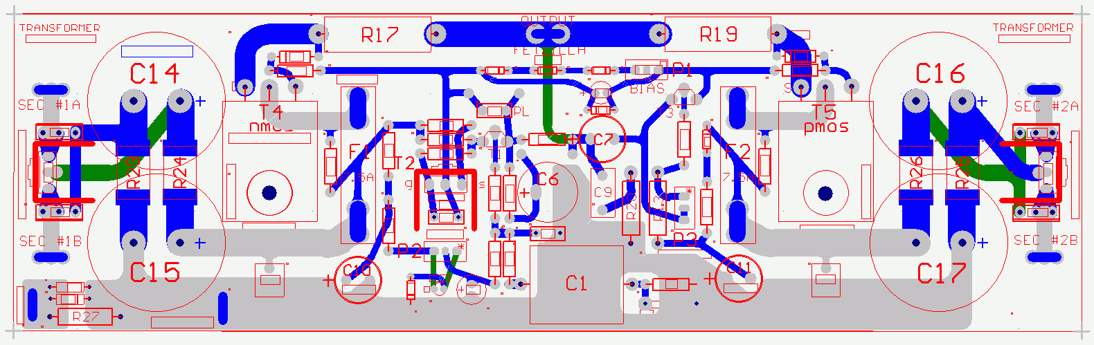

After conferring with Greg, I have attached the pcb design. It is two sided, 230mm x 69mm, for mounting directly above the outputs on a 250mm heatsink or longer. It will be gold immersion, 2mm FR4, with overlays on both sides; premium quality.
If anyone would like one of these boards, which will likely be priced around $USD50 for a pair (including shipping), would you please show your interest on the AKSA forum in a possible group buy? I will start a new sticky there for those who are interested.
The board is along the lines of a recent Aspen product and borrows from its power supply and output stage layout. Many hours have gone into this board. It is a proven layout, works very well, and should be easy to get going. I have left spaces for experimentation with lag compensation and phase lead. Jfets have large pads to help dissipate heat. Diodes used in the power supply are BYC28E-150, UFSR from Philips. Caps are 30mm diam, anything up to 6,800uF each side. Interelectrode resistors are 0R15 2W smds from Dale-Vishay.
The amp is configured for 36V rails, which require a 25-0-25Vac trafo rated to 225VA. This gives exactly 50W at peak, which is sufficient to drive almost any speaker. Remember, this is ONE channel only; the other is identical, but that does mean either two trafos or one with two connections for each secondary wire.

Post #1130 on page 113 shows the last schematic.
BTW, have a look at the layout, Kean, there is a gate stopper on the DN2530, and you might notice something else strange about it.....
I will leave posting of the final schematic to Greg. It's the AC coupled version, and uses 2SK170BL as input device and ZVP3310A as the voltage amplifier.
Hugh

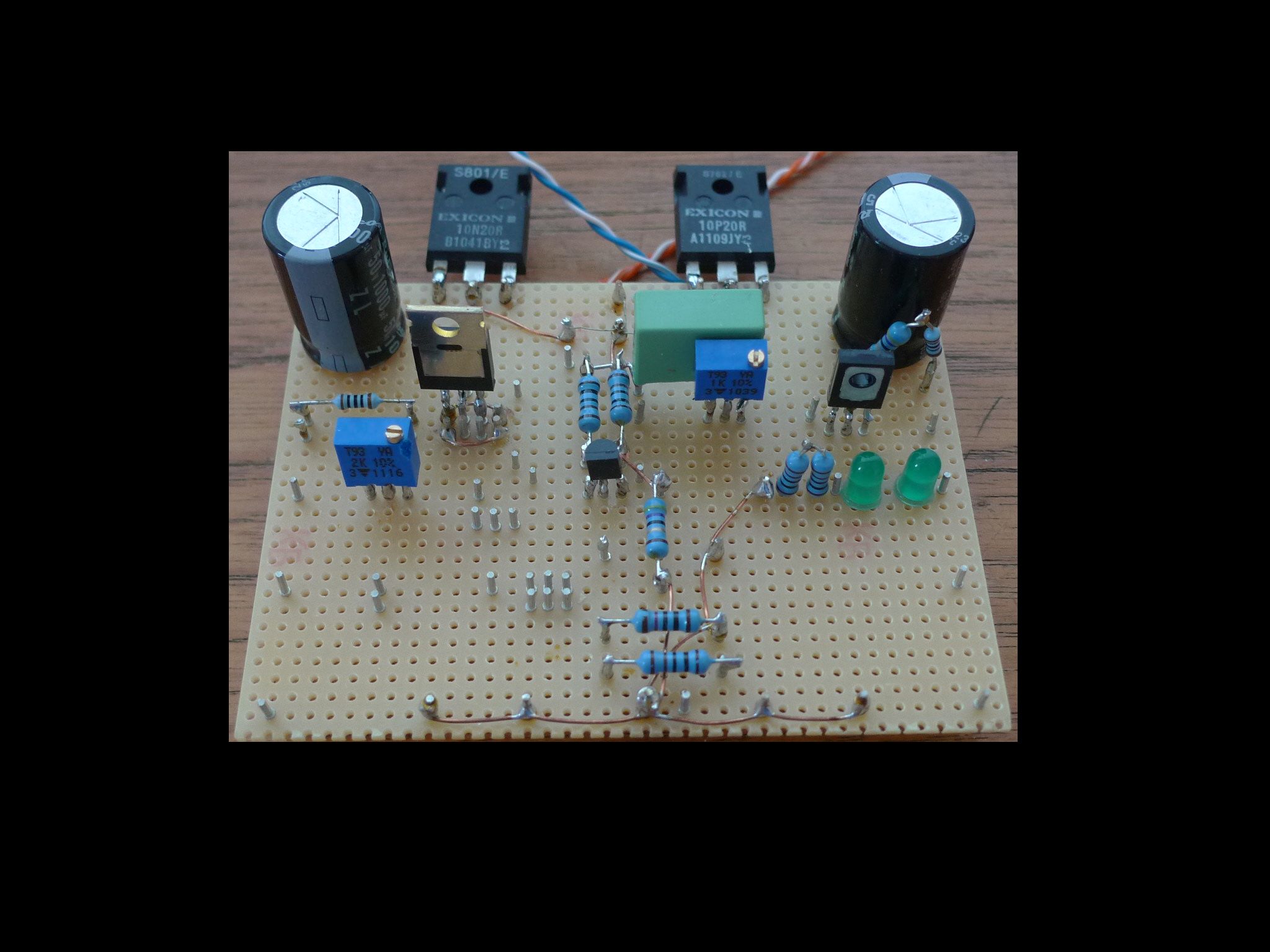

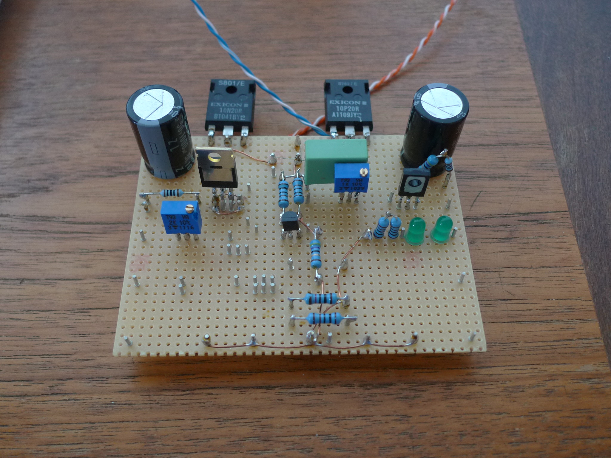

Switched on one board yesterday :) low bias, no heat sink. Looked good & stable on the scope, should hear some sounds today and see some square waves a few days after - building a little sq wv gen kit till my signal generator arrives.
I'll build four boards like this so I can play around with it and compare different versions easily.
When it's finalised, I'll do a PCB and order some premium components.
mike

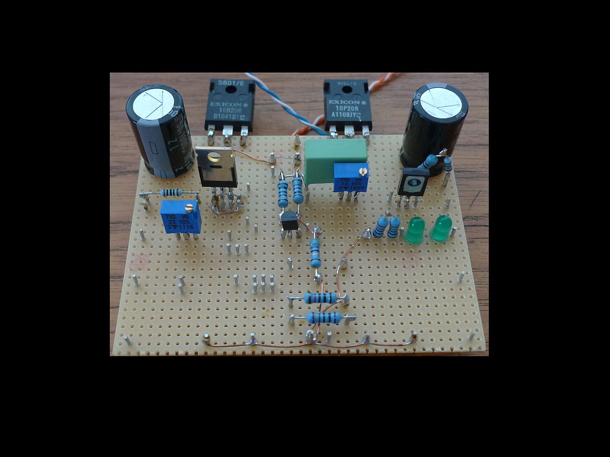

Superb photograph.
Why so big?
Here are two edited examples, one @ half file size and the other at one quarter of file size.
Is the extra detail shown in the original worth a file 4 times as large?
