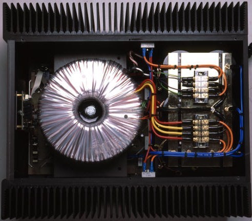

Example piccy :
400W in Class AB and 200W in Class A from 7 pairs of output devices spaced half an inch apart (Seifert KL274 heatsinks, 20" wide and 0.125C/W each)
