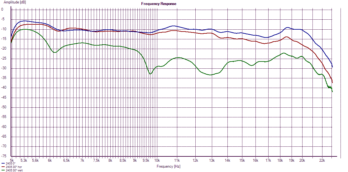

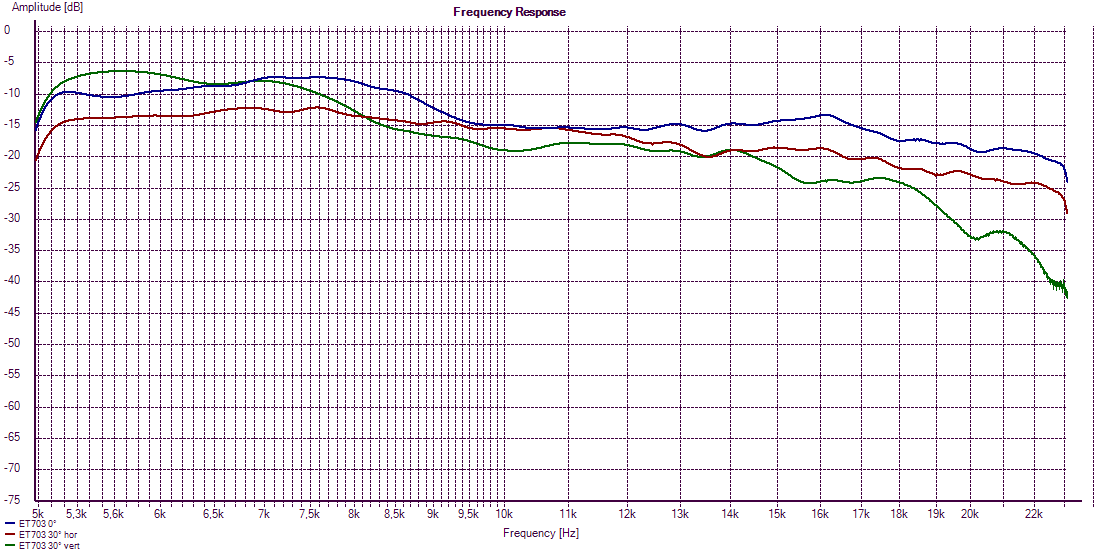

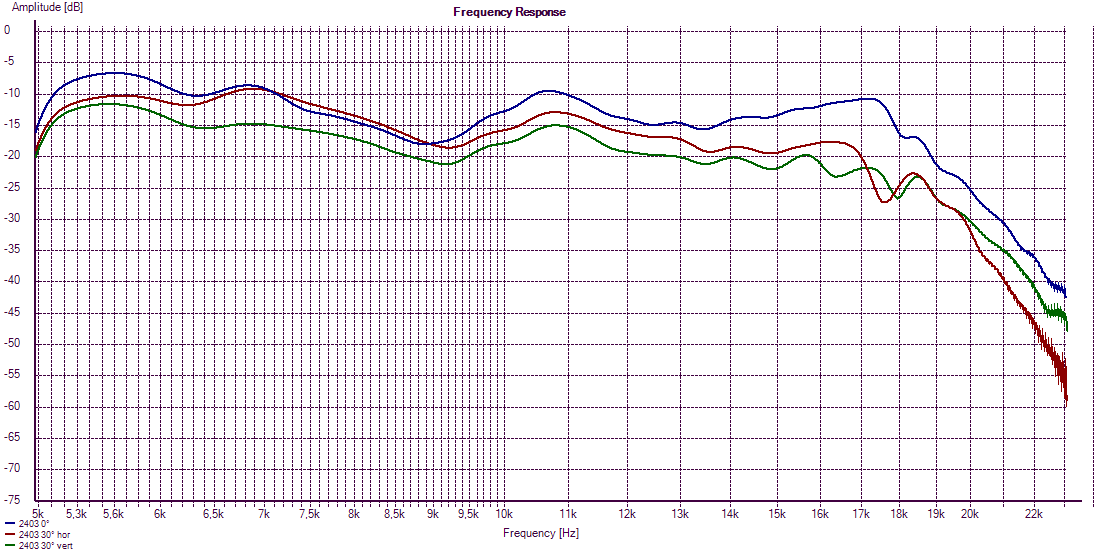

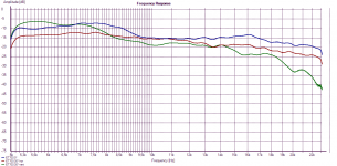

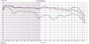

Hi Jean-Michel,
Even without diffraction pattern flip cannot be avoid when one dimension is smaller than the other. It is just a matter of keeping it lower than the intended crossover, or accept some form of vertical beamwidth widening (and loss of matching) at the crossover point (as most horn speakers do...).
As an example, why the slot of tweeters like JBL2405 or TAD TD703 must be oriented vertically is to obtain their largest spreading Inside the horizontal plane.
This is clearly the case for the 2405, as well as the 2403/076 "cat eye" (up to 17kHz), but not for the ET703 (at least not past 8kHz...). Contrary to most pictures that can be found on the web, and the way it was used in the L300 exclusive clone (can't remember its name), the ET703 is best used with the "slot" (horn) horizontal.
Here are some raw directivity measurements (the 30° angle is approximative...) with the "correct" orientation
2405 (vertical slot)
2403 (vertical slot)
ET703 (horizontal horn, ie not the common presentation)

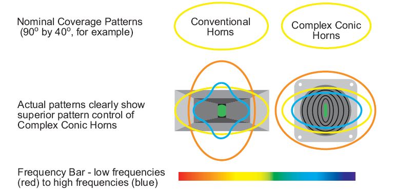

Hello Pos,
I don't rely on simplistic empirical formulas as the one given by Keele in 1975
Understanding Horn Directivity Control Synergetic Audio Concepts
expressing the frequency at which the horn loose directivity control versus the widthor height of the mouth of the horn. It dépends a lot on the shape of the lips of the mouth and the way the wavefront "drag" along the walls of the horn until the mouth.
Even a "wavetank" as in Hornresp can shows that directivity in the low frequencies reproduced by a horn are much influenced by the shape of the mouth and not only by its width / height ratio.
Iwata-JMLC and E-Jmlc horns behave luch more like the complex conic horn described by Renkus-Hein
http://www.fullcompass.com/common/files/14314-trx121.pdf
which doesn't lead to "pattern flip" (see attachment @ Renkus-Hein taken from the document above).
A conventional horn showing pattren flip on left, a modern horn which doesn't lead to " pattern flip" on right, this one having few similarities with the Iwata-JMLC horn).
Best regard from Paris, France
