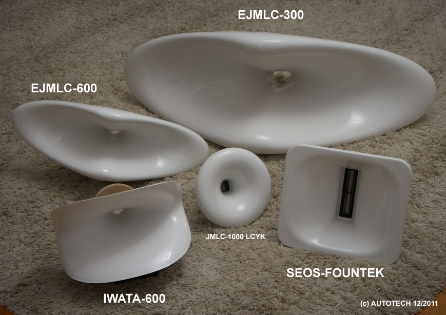

also at the 57 page, it is a iwata inspired horn drawing created by Jean-Michel , wonder...did any person really made that horn ?
this is the one?
Hello,
Autotech commercialize many horns I used to design (BTW I have not commercial interst in Autotech, I give all my ideas in audio for free).
For an example of use of the Iwata 300, give a look to :
http://www.diyaudio.com/forums/group-buys/166312-waveguides-horns-89.html#post2825851
There is also the E-JMLC300 which possess a more controlled directivty.
http://www.diyaudio.com/forums/atta...1324570129-waveguides-horns-img_4255-copy.jpg
Here is a system using that horn:
http://forums.melaudia.net/attachment.php?aid=2480
Best regards from Paris, France
Jean-Michel Le Cléac'h

Hello,
This E-JMLC horn possess an hyperbolical expansion of the area of the wavefronts (with T = 0.707 and Fc = 1000Hz).
I designed that kind of horn to provide a more constant horizontal directivity than the axisymetric Le Cléac'h horn while keeping a very efficient loading of the driver (allowing a better operation of the diaphragm and an efficient reduction of the distortion compared to waveguides).... That's why you can see a kind of beak at mouth.
I was puzzled when I saw that, few times after I designed this E-JMLC horn, the horn of studio monitor from SONY used such a feature, see:
http://www.audioheritage.org/vbulletin/attachment.php?attachmentid=13498&stc=1&d=1141815765
Even if Jack Zagaja measurements show that the directivity is very constant inside a 60° angle until 15kHz, allowing a wider listening zone, I don't call myself that horn a "constant directivity horn". There something very special about that kind of horn : the horizontal profile varues a lot with the cut-off frequency. IMHO the better shape is obtained with a frequency (around 300Hz) and in that case I think the angle inside which the directivity should be more constant could be reach 90°.
See attached graph.
But in that case the horn is very large and it will be very difficult to unmold, that's why Jack Zagaja asked me to calculate a first model usibng Fc = 1000Hz.
