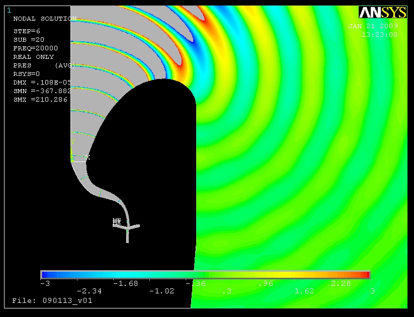

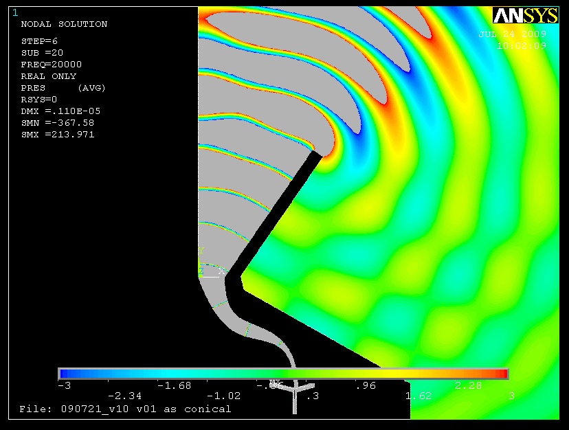

Have a look at this from John Sheerin’s Website
LeCleac'h horn vs Conical Horn
Bill

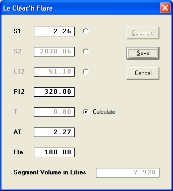

Hi more10,
The Hornresp Horn Segment Wizard can help with this process.
Kind regards,
David

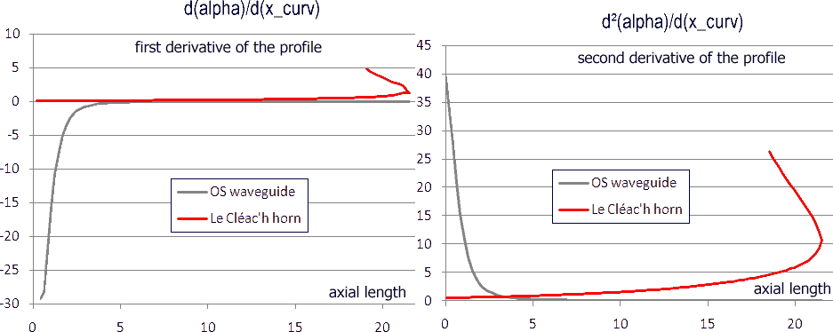

Hello Esperado,
As said by Earl Geddes about HOMs production :
http://www.diyaudio.com/forums/multi-way/103872-geddes-waveguides-534.html
HOM production occurs vhen the tangent angle to the wall of the horn rapidly changes (vs. the wavelength).
Earl Geddes: "The sharper the discontinuity, in terms of rate of change of slope, the more energy there will be in this HOM."
In an OS waveguide most of the "rate of change of slope" is at the throat (in the "quasi quadratic" part of the profile. In a Le Cléac'h the rate of change of the slope is very low at the throat.
See a comparison of both first derivative and second derivative of a Le Cleac'h horn and an Oblate Spheroidal waveguide here attached.
Now about the frequency dependance : in a Le Cleac'h horn the high frequency front waves "take off" in the first half part of the axial horn length in a zone where there is very few "rate of change of slope"
In conclusion I have to say that one of the main purpose of the Le Cléac'h is to provide very low diffraction and therefore very few HOMs. So, "NO THANKS", we don't need any foam inside a Le Cléac'h horn...
Best regards from Paris France
Jean-Michel Le Cléac'h
