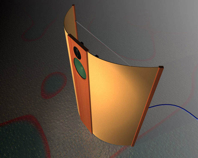

bending new corners
Hi all,
just jumping on this thread when it comes to bent baffles.....
I was playing with that idea also , thinking of a small central baffle to hold the driver and two "wings" made from thin plywood and then bent backwards........using two strings or something to hold them in position. One could even play with the angle by adjusting the length of the strings.
But as I said, it is not more than an exercise and a CAD-rendering.....
Oliver
