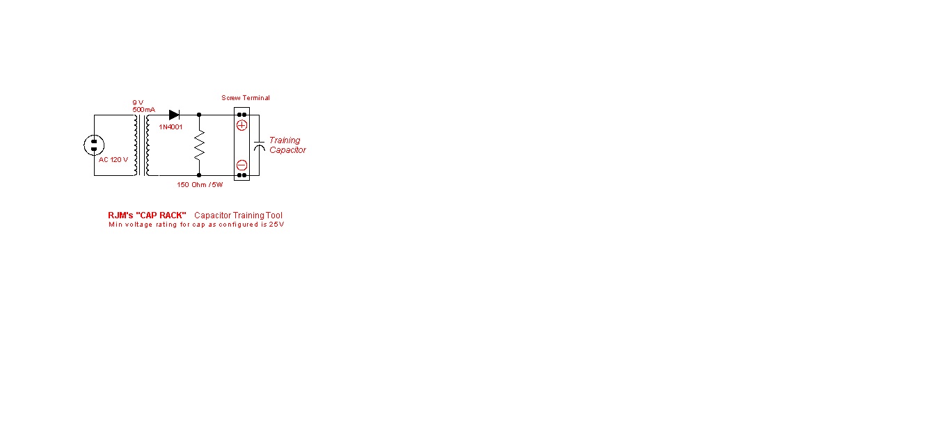

My question is related to Capacitor Rack found on your project page.
I use 9.3V secondary toroid, 1N4002 and 150R 5W ceramic resistor.
I measure 9.4V AC out of trany, but at resistor I see 4.8V DC RMS. Why do I have such big drop? Or it is OK since I have only half/positive parabola cycles.
By calculation, I have 62.6 mA current, so no issue that trany has too much load. Everything is fine with AC when I remove diode and I have 9.2V AC on resistor.

The output waveform isn't DC, it's more of a sawtooth pattern with 60 Hz repetition rate. The RMS value of that waveform is about 1/3 it's maximum amplitude of about 13 V - just under 4.8 V seems about right to me.
If you care to double check, remove the resistor and you should measure a DC value of about 13 V. (Without the bleed resistor, there is no dip of the voltage between diode conduction cycles and the output is essentially constant.)
Yes, you are right.
I used 220uF 35V Ele cap and voltage is stabilized to 10.33V DC now. Thank you.
