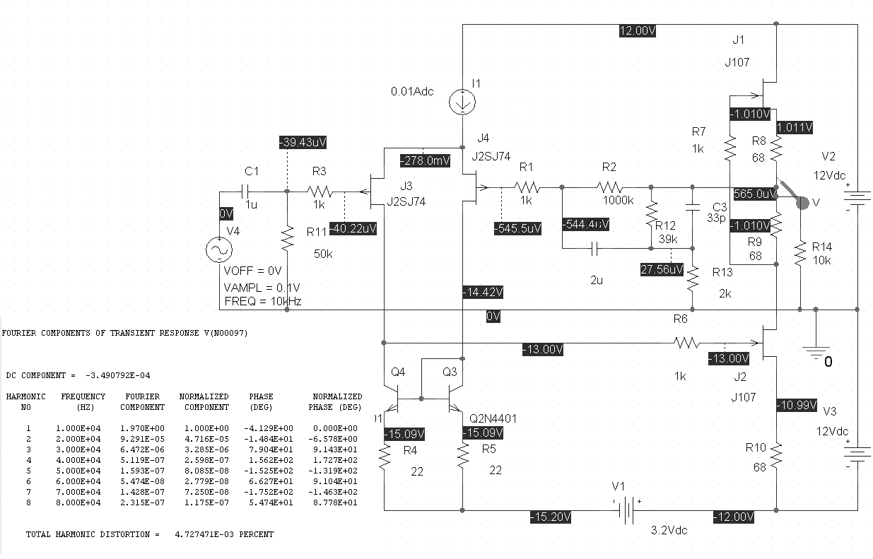

Here is a possible J2MeToo topo simulated as a preamp stage with immediately available PSpice device models. I used the J107 in the output stage, as I have a bunch of them and they are a high IDSS device, relatively speaking. In an actual power amp, I'll probably end up using Zetex p-channel mosfets in the input diff pair instead of 2SJ74 for the needed voltage rating (60V vs. 25V), as I'm using mirror rather than resistive loading. As you can see, the THD and harmonic distribution ain't bad for 2V output signal (20X gain).

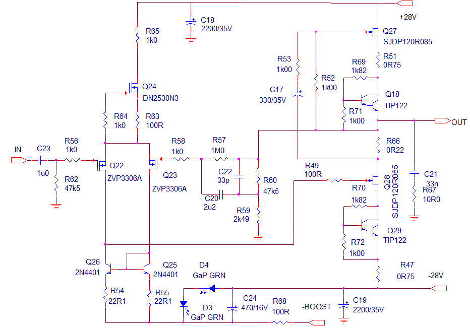

Here is a possible J2MeToo implementation using Darlington Vbe multipliers for extra bias. If I remember correctly, the R085 samples I have in hand required about 5V of reverse bias for a bias current of 1A. To get the 25W RMS claimed by the J2 spec, one would need about 1.25A bias current, assuming you can get 100% modulation of the upper JFET. The values so far are set up to approximate this condition.
I added a little extra voltage on the rails - more may be needed to attain the stated power, depending on the large signal characteristics of the amp near clipping.
I doubled the bias current in the input differential stage to improve gain and linearity. Unlike the J2, this amp is set up for unbalanced rather than balanced drive, since that's all I have in my home setup.
This circuit hasn't been simulated yet. I'll get arounf to it when I can take the time to figure out adding the R085 model to my PSpice library. complicated by the fact that it's tied up with Orcad Capture. Holler if you have comments or questions.

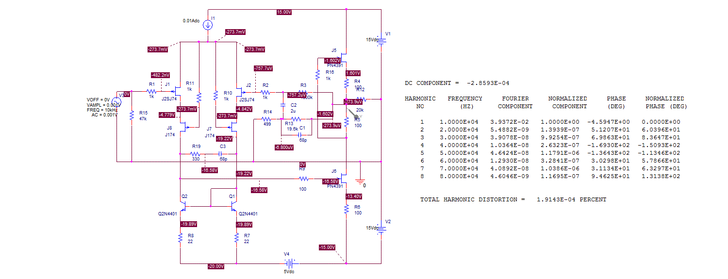

Based on the circuit in post #47, I did a gain cell that I might consider using in a phono preamp. With that in mind, the input differential stage was cascoded to reduce the Miller capacitance presented to a phono cartridge at the input - definitely a consideration for a MM cartridge. With the cascode, I had to add an extra RC network on the diff stage output to prevent full-tilt oscillation. The included pic shows the current schematic along with the output harmonics for a 0,001V, 10kHz input signal. Though the THD is low, the 5th and 7th harmonics stand out, quite different from the non-cascoded circuit shown in post 47. I fear listening problems from this preamp. Comments?

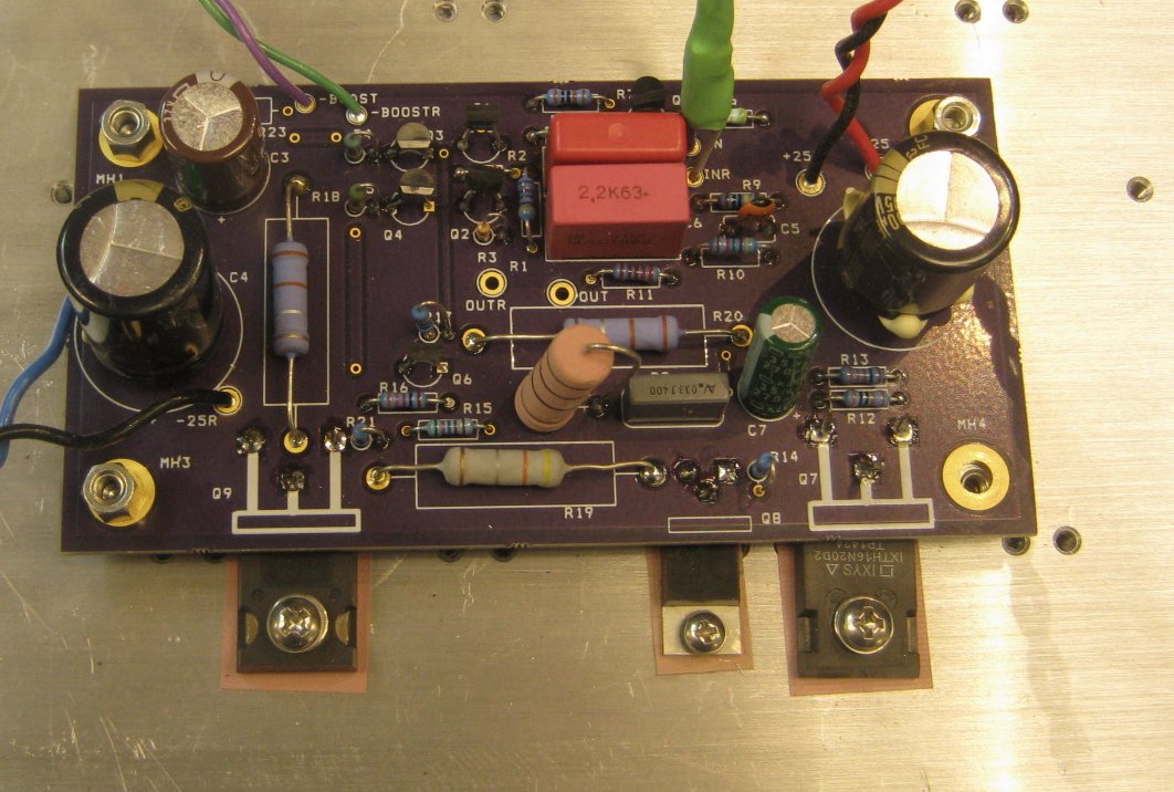

I'm building an amp using a fake SIT and an Ixys 200V topside modulated current source similar to the circuit in post #32. I'm calling it "Aleph Mc SIT", and hopefully it'll make a showing at BA16.
Here's a pic.
I ran up one channel this afternoon, and the amp draws about 1.6A of bias current - somewhat hot, but survivable I can tweak that down a bit. The output offset is ~20-odd mV - good enough for government work. I also ran a gain phase plot.
Here's a pic.
After fixing a couple of bonehead mistakes, the other channel is now running, and it's time to think about how to box this amp up. I have toriods coming from Antek, and alumina washers from the Mouse. Both will be useful.I also have a couple of ideas for generating a floating bias supply for the topside depletion mode current source to get rid of the Darlington and enable bias adjust with a trim pot, but not for this go-round.
