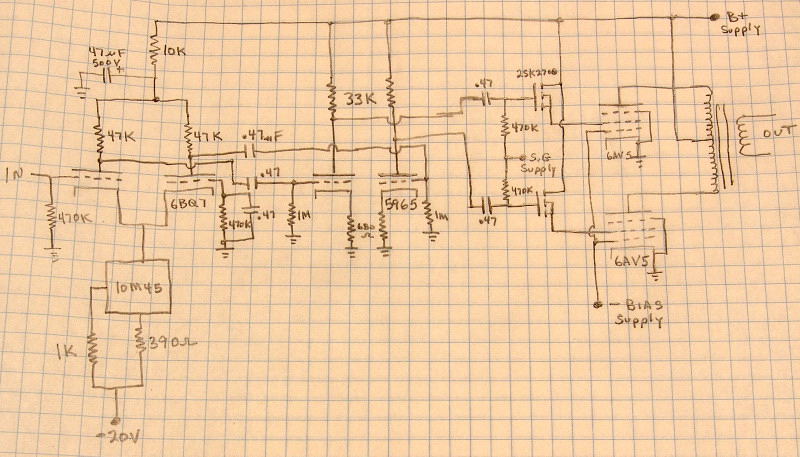

What is screen drive? Is there a schematic I can look at?
here you go....
http://www.diyaudio.com/forums/tubes-valves/143135-screen-drive-push-pull-ideas.html
http://www.diyaudio.com/forums/tubes-valves/198420-6l6-807-ab2-triode-screen-drive.html
Screen drive implies that the audio drive signal is applied to G2 instead of G1. You won't find it in tube books, and it is sill relatively experimental. There have been a few commercially made screen drive amps (Berning comes to mind).
Screen drive has the major advantage of high efficiency. This can be exploited to get big power out of small tubes. The disadvantage is that very large drive voltages are required with grid current being drawn. It is easy to over dissipate the screen causing a fireball inside the tube.

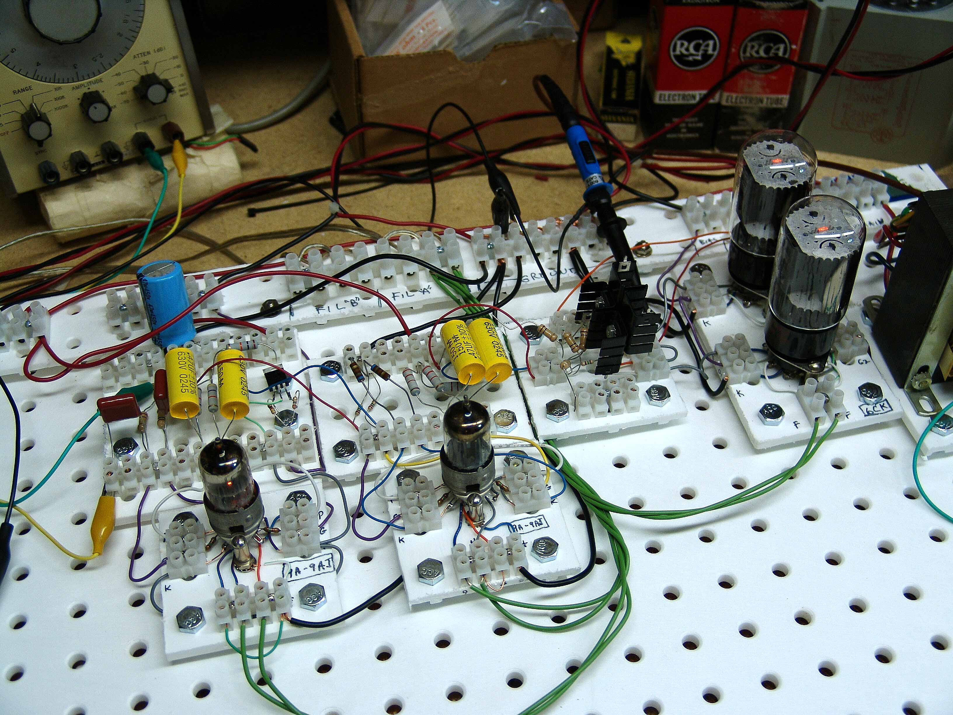

Here is the schematic for an experiment I made several years ago. It is also at the bottom of this page:
6AV5GA testing
Search through the "tube sale at AES" thread. Some screen drive experiments there sucked 125 watts out of a pair of 98 cent tubes for a while until I tried to get more blowing the screen grid out of the tube.

That's a really nice breadboard idea.
A few more details are here. A few other forum members have built them too:
