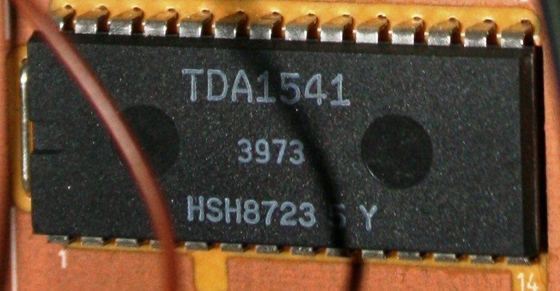

This is how the TDA1541 (from my Phillips CD-473) typeface looks like. Year 87, non-A. Notice the specific "A", "4" and "7" in name and datecode. But not in the middle serial (at least not in what I have).
