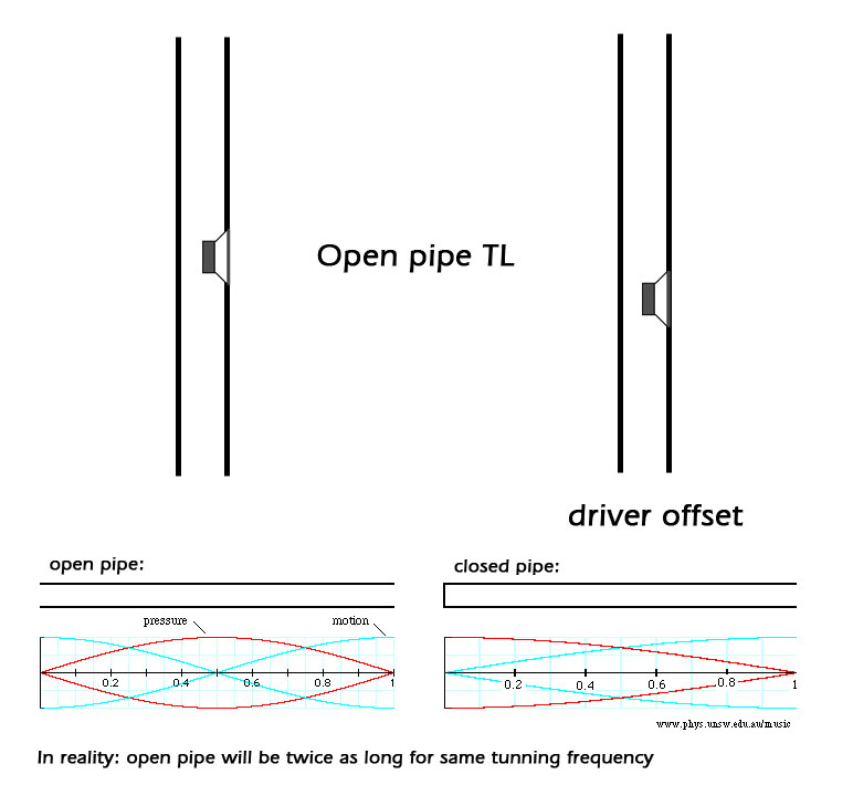

Is there such a thing as a TL opened at both ends ?

Do you think there are any programs that could be used to simulate it?
You can come plenty 'close enough' in HR by doing an offset driver TL, then terminating it with a 0.01 cm length/0.01 cm^2 area. This somewhat smaller than a pinhole will be much too restrictive to affect the sim or real world performance assuming you have a drill bit small enough to test it. ;)
Ditto for doing plane wave tube [PWT] sims.

A tapped horn is not an opened pipe - it has one end closed; the difference is in the way the driver sits "inside" the enclosure.

I'm going to repeat: the purpose of the thread is to locate projects/designs and the theory for a variation of the transmission line, the difference being the fact that the pipe has no closed end, both are open to communicate with the outside environment.
Yes I'm afraid people have been going off at tangents because of their paranoid fear of the alien creature you are describing. It's perfectly clear to me what you are after. Has GM's idea of a way to simulate it have any possibility in your eyes?
OK, sim it in HR as a closed tube [plucked string modes] for 'close enough' or use AkAbak.
GM
Hornresp will not make a good enough simulation because - this was mentioned before - this pipe has double the number of harmonics, so for example a 50 hz pipe will also resonate at 100, while a closed end pipe will skip this one and only resonate at 150 hz; and the nulls will be different for sure.
