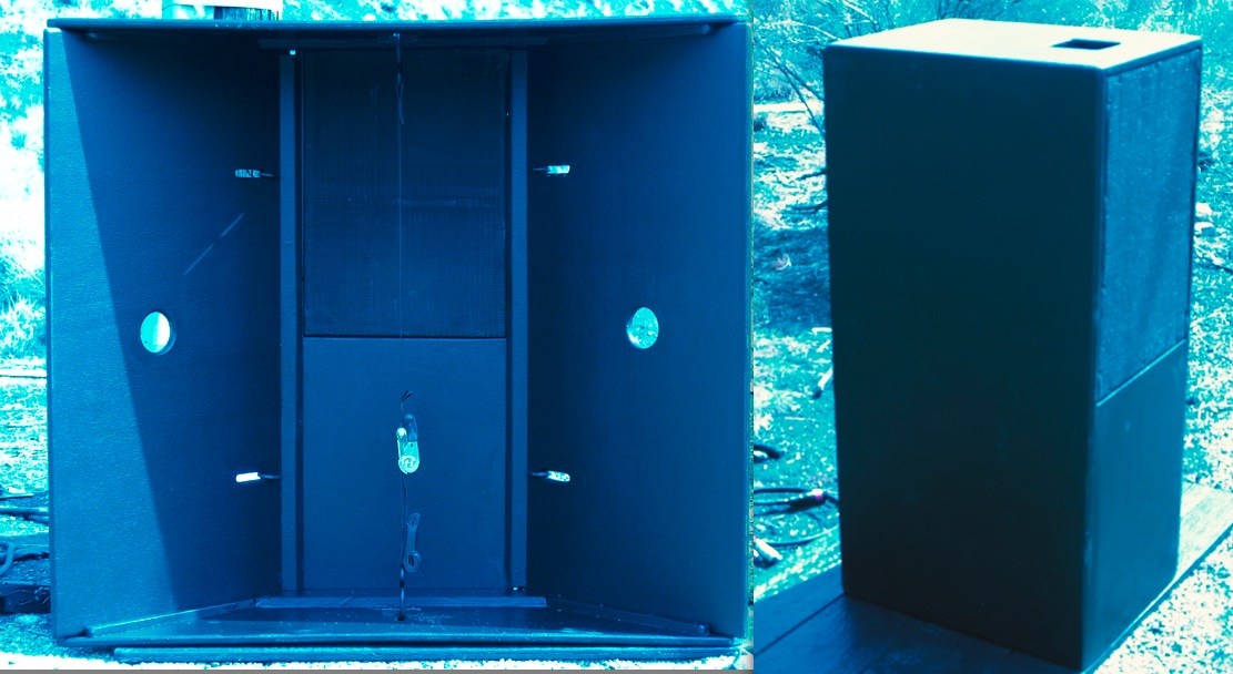

The Domino did not do as well in the LF as the sims predicted, but is a potent cabinet nonetheless.
If the bass below 50 Hz is more important to you than the bass 50 Hz and above, I'd suggest a slimmed single Lab 12" or 15" version of the Keystone
http://www.diyaudio.com/forums/subwoofers/185588-keystone-sub-using-18-15-12-inch-speakers.html
otherwise the Domino is a real killer for the size, 45 x 22.5 x 17 inches.
