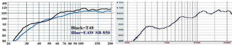

Actual measurement of BFM cabinet:
vs claims:
djk, It looks like you're trying to say that BFM is being misleading and I don't think this is really the case. Does Bill mention how his measurements were acquired? Do we know how these two measurements were taken?
These two measurements look very close to each other to me.
Me too. The LMS plot was done with a Titan48 that had the extended frequency throat mod. So the two cabs are different.
Thanks for that added info davygrvy. There is definitely a difference between the two plots but not as significant as it would first appear. To better illustrate this I've cropped and combined the two graphs to approximate the x & y scales.
