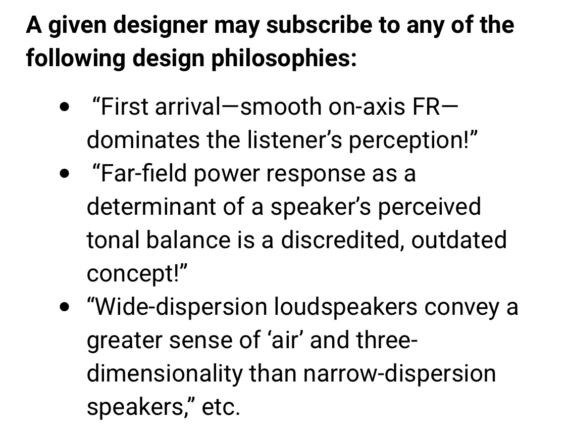

Where did you get this?A relevant statement,
https://www.audioholics.com/loudspeaker-design/comb-filtering - I literally pulled this from an old post in the thread, and luckily was able to google search the text and find the source... It appears this is more of a snippet of the article that had other points to be made.
One of the things that caused me to question your screenshot is the exclamation points. Occasionally I find, people who deliberately overstate the importance of on-axis frequency response may be trying to avoid looking at other things. Perhaps I'm wrong..
Then regarding the second point. Referring to the AR-3a as having a 'good' far field and then implying the DI is all wrong, seems to invalidate the point. Easily dismissing the relevance of vertical response even though it does contribute to DI, and saying it's all about the on-axis.. seems to be putting the cart before the horse.

Your comments about the AR-3a are over my head. Regarding the bullet points, I think the author was relaying what some designers hold on to... The Next paragraph is the conclusion
This article seemed to be fitting given my design choice of a Rising DI that leads to a dry HF presentation.
Regardless, there is no reason the designer can’t achieve exactly what they intend to accomplish.
Conclusion
Both comb filtering (acoustic interaction between widely-spaced multiple sources) and acoustical interference (the acoustic aberrations that emanate from a single source employing multiple drivers) are acoustic artifacts that can impact the nature of reproduced sound as it is perceived by a human listener with two ears. Although the audibility of these phenomena when listening to complex, highly dynamic source material played in a fairly “live” environment while in the critical or far field may be somewhat limited, they are, nonetheless, audible, sometimes detrimentally so. Dealing with potential acoustical interference issues of multiple drivers in the same loudspeaker cabinet is something any serious designer should be concerned about and not just brushed off as a measurement artifact that doesn’t have real world implications. The important thing is for speaker designers to have clearly-defined goals (near- vs. far-field optimization, to what degree they feel wide high frequency dispersion is important, etc.) and to intentionally take the awareness of these phenomena into account when developing their loudspeakers.

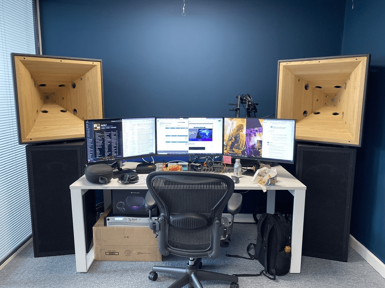

I think that I've had good results with my system because of the large sizes and deep tunings, deep XO, making my flaws less detectable, whether it be fault of the Ear, Room, Large Wavelengths or all 3. My design is using a single driver on a low F horn which is, according to @weltersys, an old school approach. Old doesn't have to mean bad. I think that at the top of the food chain of loudspeaker design, as we choose different approaches, we start trading one distortion for another. Leaving one design, not better than the other, just different.

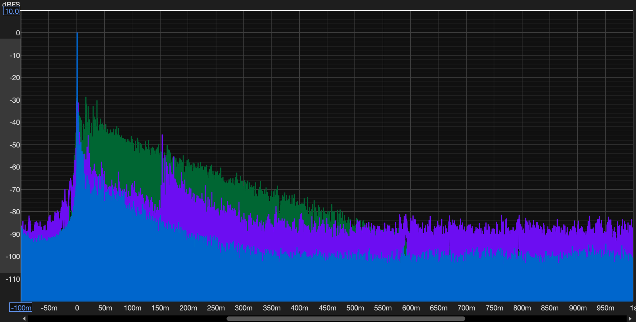

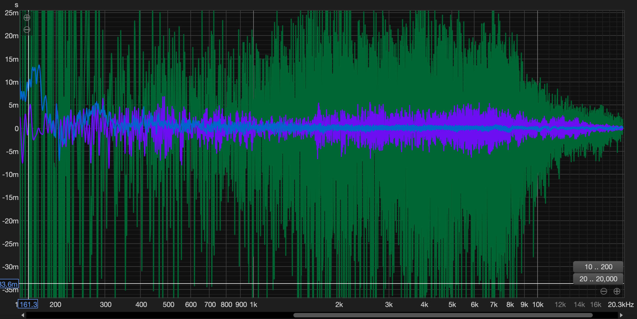

Green-ME464, a diffraction horn, showing why such a thing is a not a piece for sound quality
Purple-Syn10, a synergy type design, showing that the reflections created in a multi entry horn only serve to lessen transient clarity
Blue-E-Tractrix, Arrivals are very tight in comparison, showing what I believe to the be a clear advantage of a traditional horn over multi entry and diffraction approaches
Those are all the outdoor measurements I could find atm, I have at least one more on my main computer which is having an overhaul atm.
In the conclusion the author is speaking generally, you have to go back and read the rest of the article where it talks about some the audible issues.
The impact of multiple redundant arrivals, on perception, is a complex thing. Flaws can be hidden by the room or by listening position, or other design choices like Directivity, X0's and redundant drivers, and what spectrum the "flaw" has been caused, for example.
The Article also speaks on issues of a loudspeaker seen in the nearfield, a loudspeaker that has been designed to perform well in the far field (Ar3) and suggesting that they are still a problem, in the far field? So the Author definitely is concerned about off axis performance, in my opinion, no matter the listening distance or on or off axis listening.
