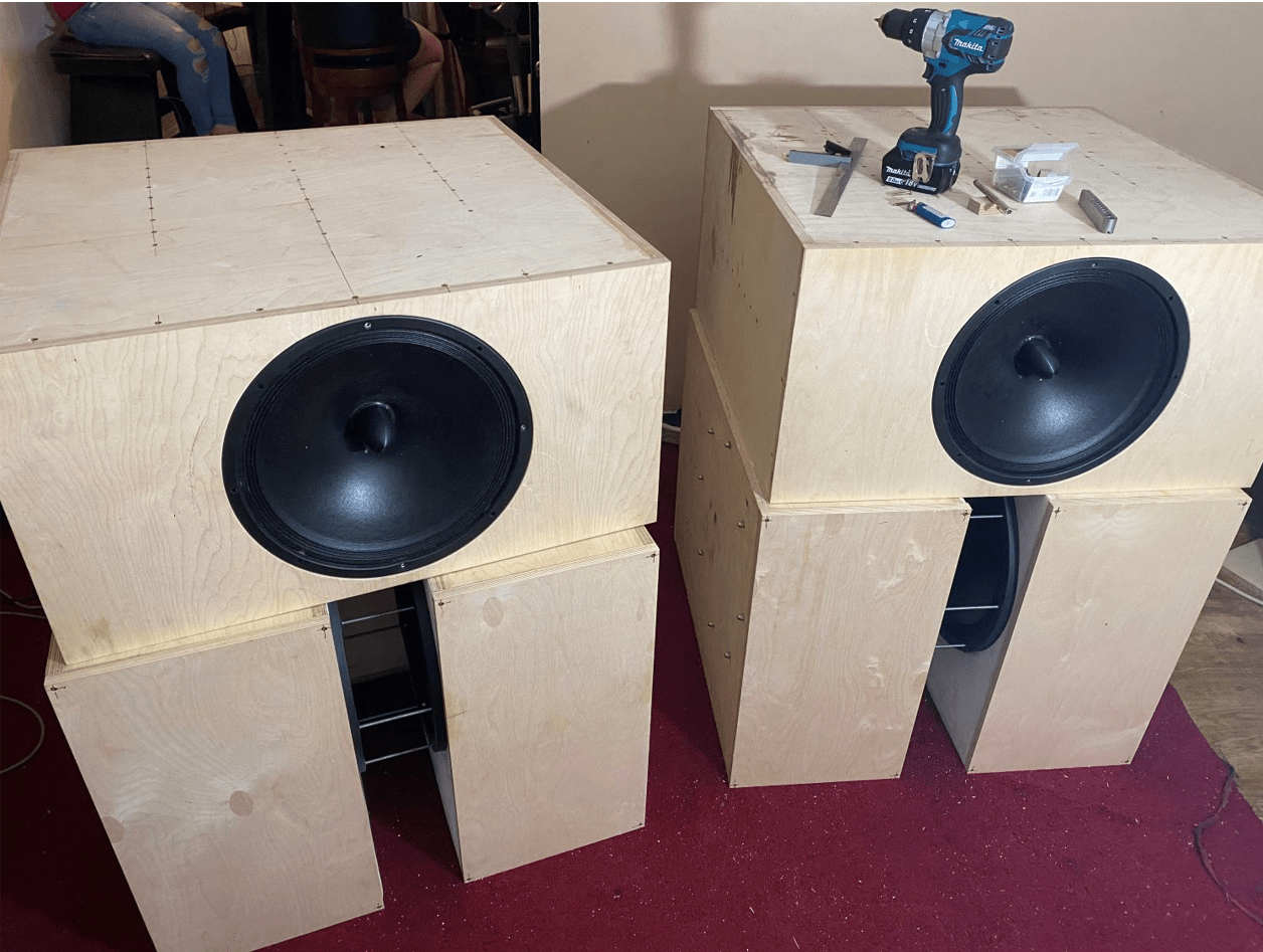

Why do you guys keep ignoring the 15" driver I have, yes, I did try a 400hz crossover., and a 600hz, etc... At that time I concluded that 200hz sounded the best. I also compared the 15" to the dual 18"s and concluded the only difference was that the 18"s had more LF extension. I tried tone burst in the area that the slot should be acoustically loaded, and there was no notable difference between the 15" and slot loaded woofers that I recall.
I would like to try a MTM with a Constant Directivity Waveguide. I will likely, try it, one day.
With current setup there are advantages. Having the Woofer at the floor, (I flipped the PPSL cabinet as seen in the above) provides the best FR, in an untreated room, that is, outside of soffit mounting which puts the woofer, so much at the floor it is in the floor.... Covering down to 200hz on a single axis, provides incredible imaging, the vocals only break single Axis Character, on the most extreme Material, ie Barry White :ROFLMAO: OK!? Barry broke the Facade, otherwise, the majority of vocals sound as if coming from a single axis, when the Horn is crossed over at 200hz at 36" inches.... At a distance farther than 54" this was not possible with a 300hz or higher XO. I started at 600hz, and kept going lower and was like yeah I still prefer 200hz xo. with just 2 acoustical axi's to recombine, and at such a low frequency, a seamless crossover, is very easy to achieve.

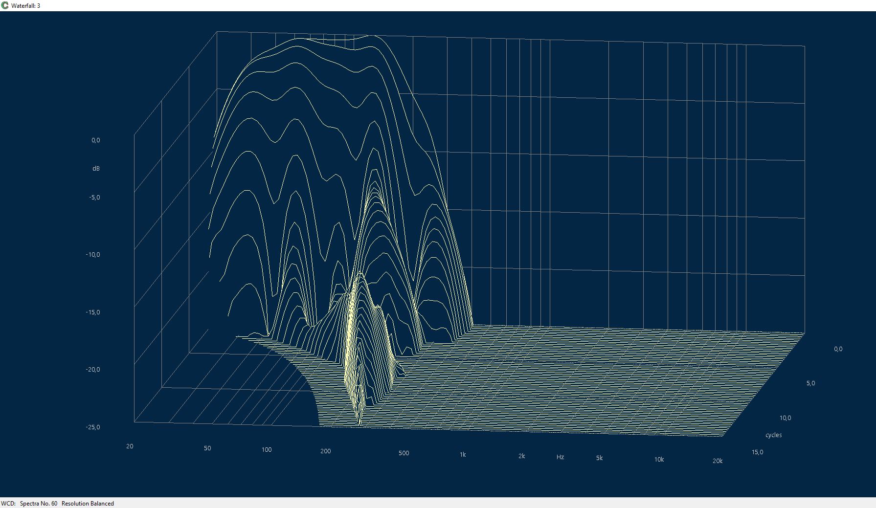

For all my own findings @camplo, your setup cannot work well.
Even with the biggest elliptical LMH woodhorn and the Celestion AXI2050 driver, your slot loaded woofer mounting work only for a subwoofer crossed with less than 85 Hz. In the kick bass frequency range you get really bad resonances, that's physics.

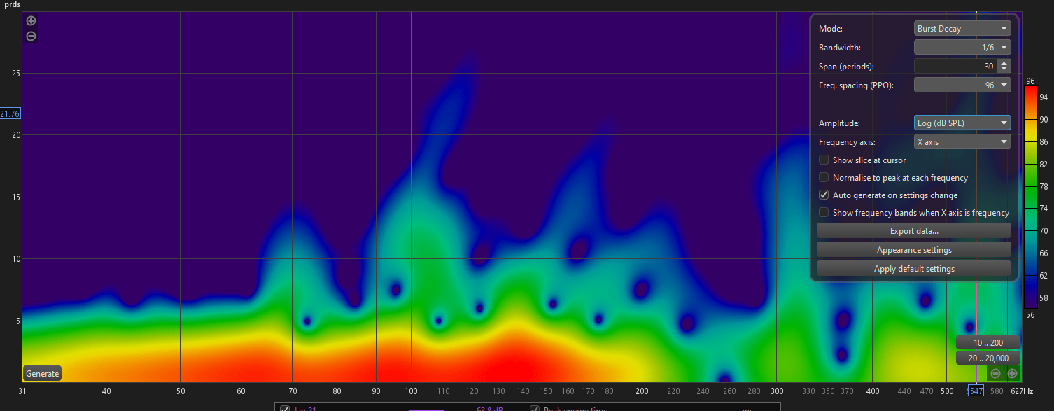

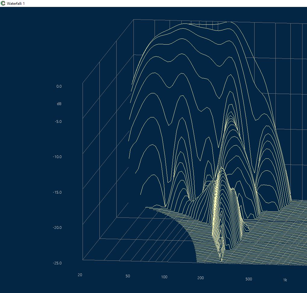

Here a Clio Pocket WCD (Wavelet Cycle Decay) measurement with a big 21 inch bass i use where i tried the slot loaded setup.
Massive resonances for frequencies above 200 Hz.
You will need a third way for the two kickbass octaves between 85 Hz and 340 Hz.
Celestion FTR15-3070c CB in a non rectangular cabinet for reduced cabinet resonances will work, very low distortion levels in the kick bass range.
Well, this is only my humble personal opinion, nevermind - Stefano

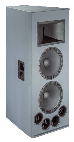

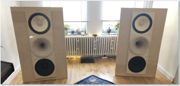

With two 15 inch or 18 inch and a large horn 2 and a half way could work - like this here:

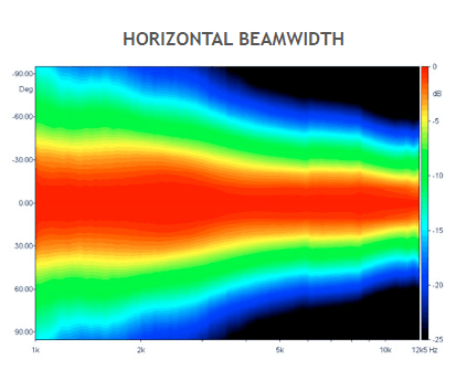

large horns with no diffraction like the elliptical LMH horns beams up to 30 degrees in the high frequency two octaves from 4 to 16 kHz
I know its awesome the clarity that is had without a bunch of arrivals at my listening position. I calculated the beamwidth at my intended listening distance well before I purchased that horn, so there were no surprises for the sweet spot being bigger than predictions had suggested. My predicted nor the actual sweet is too small for me...

Anyway, like I said, not all slots are created equal. This is a 1" measurement of my PPSL in the bad acoustics of the hard floor upstairs, and even then... Wheres the issue>? The room will swamp these measurements....
The GD/Decay issues of the 150hz f6 horn even, because they are already below the Schroeder, are swamped by the room, if high passing the worst of it, wasn't enough.
