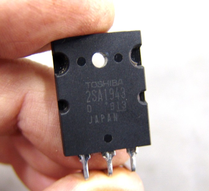

My second unit sounded much better than the first one. Maybe my 2SC5200/2SA1943 pair is fake!!!
I used this time an old stock of MJ802/MJ4502. Much better results.
I will try to find original 2S's.
Has anybody compared these transistors yet?

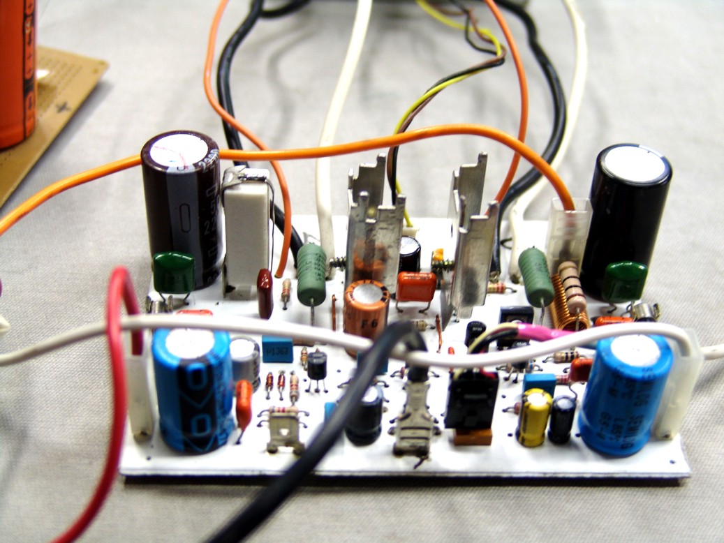

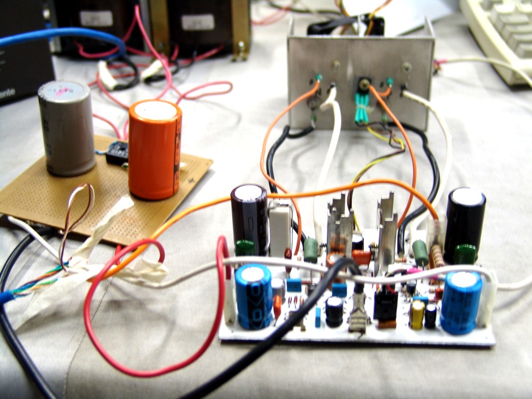

I decided to build an amplifier with parts ready available, that is, reused from computer monitors, PSU, UPS, and some others from my parts bin. The results will be shown here. But the question is: how nice will be the sound quality? Will it last for a long time? Which are the most critical ones that should not be reused? Feel free to post your comments, they are all welcome!

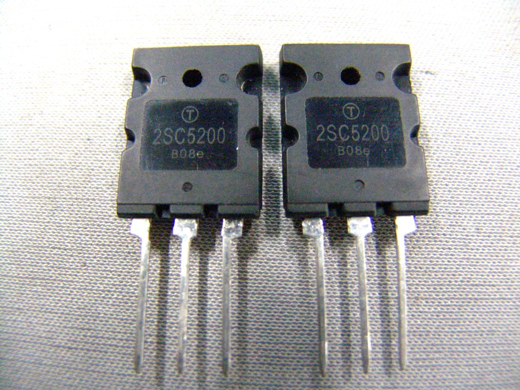

Fake transistor
Where did you get them? A close screenshot would help. Anyways, this won't help much cuz some counterfeits looks exactly as a genuine. Smashing the transistor with a hammer would only help...ermm...cough....just kidding! :D
As you can see in the attached picture, even being similar to original part, it is almost impossible to read anything that is on its face.:D

Gain=8!
The C5200 in Post #8 is an obvious fake. In this application, if a 2N3055 would work without going .poof, so would the fake 5200. But the MJ802/4502 pair are probably better than the fake C5200 - the 802's current gain holds up very well at 15A so you'll get less distortion.
Measured gain is only 8!
Others I have measured around 60.

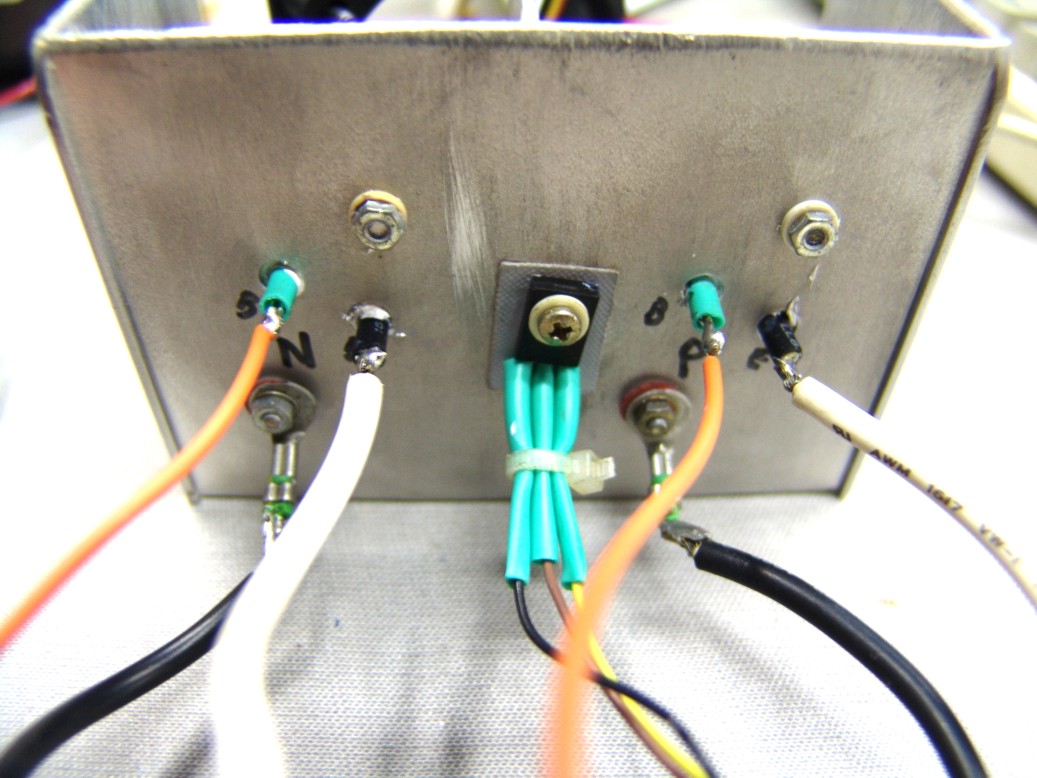

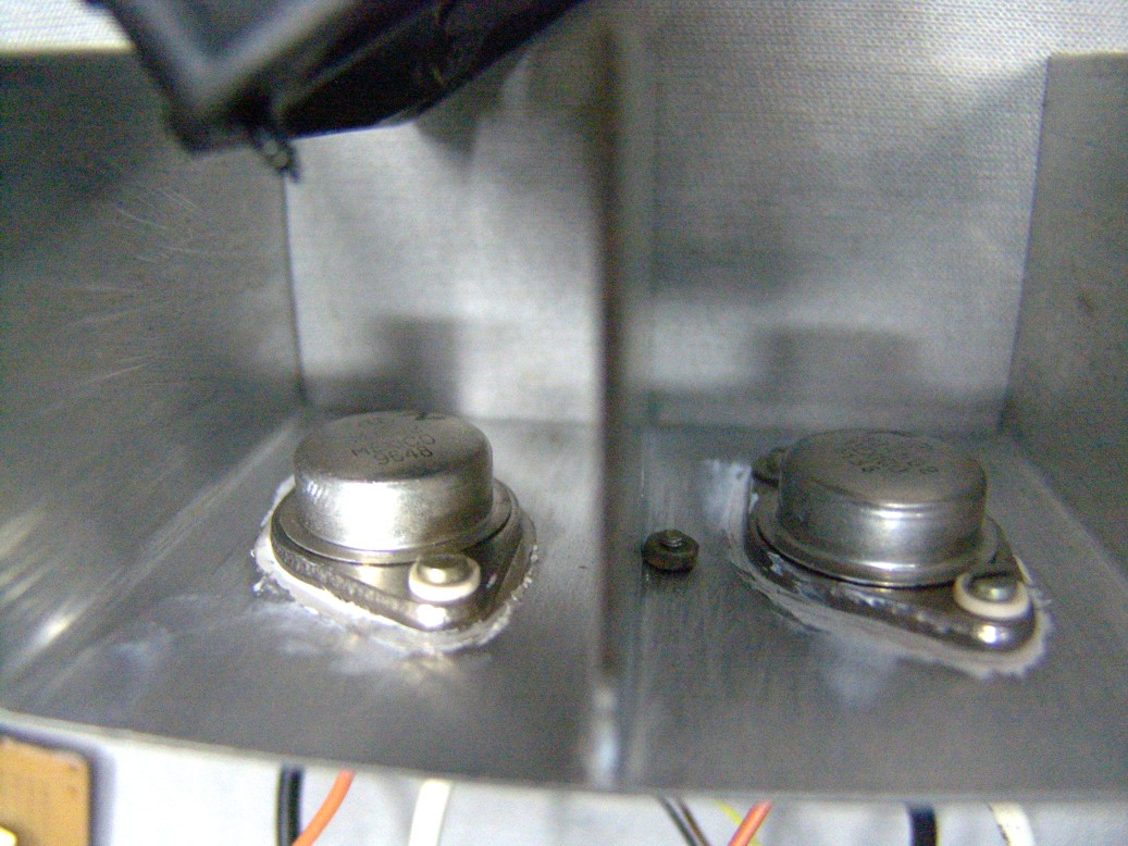

Trying MJ802/MJ4502 output pair
Much better sound quality achieved with these parts than with fake 2Ss.
No, don't laugh that much! The heatsink was home&handmade for testing purposes only! Without the fan, no way...
Touching both transistor faces yields a good sensation!!!:D
Max.

Well, definitely it is! The sound is SUPERB! :eek:
No need to adjust anything than bias! No problem, no excessive heat, only glory!
Thanks to very good project from the forum!!!
Of course transistors were all new, but sometime I will try with some old used parts.

WTF on earth are those resistors paralleled with a diode? strange combination :p
