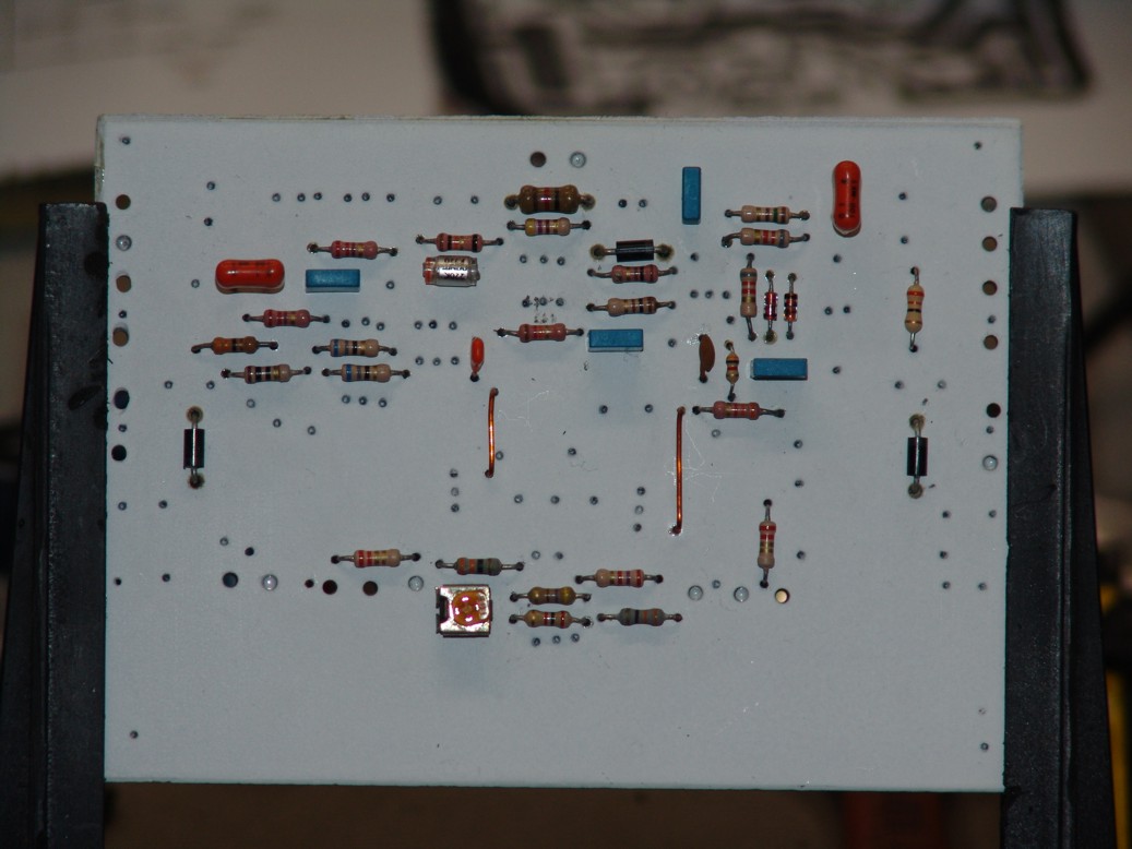

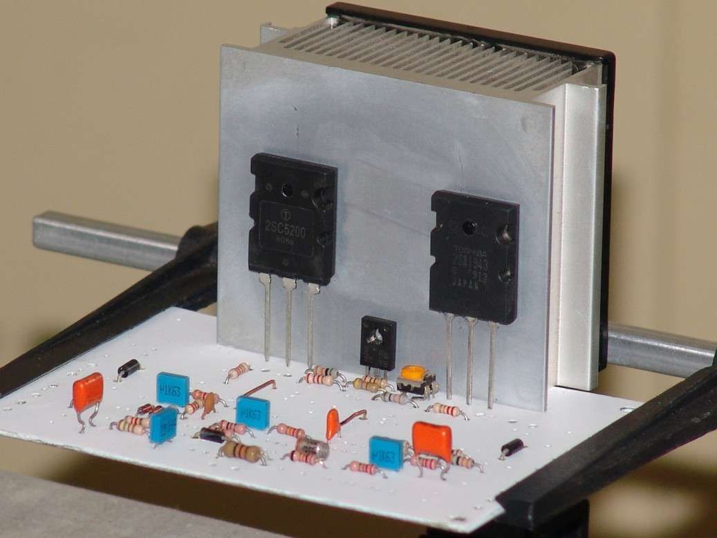

First pics from homemade junk parts amp
Maybe pictures were too big. These are small versions.
Max.
