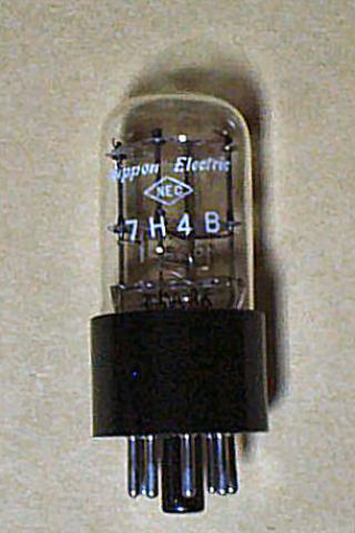

Please comment on constant current for tube's filament using
Amperite Ballastic current regulators like 7H-4B etc.
You could find some helpful informations and discussions on certain website(http://tubeaudio.netfirms.com/top_UltimDIY.htm) concerning this topic.
I have not myself use them in my circuit so I haven't got the first hand experience of these tubes but somehow the informations I got are very positive!

Mikewong said:Please comment on constant current for tube's filament using
