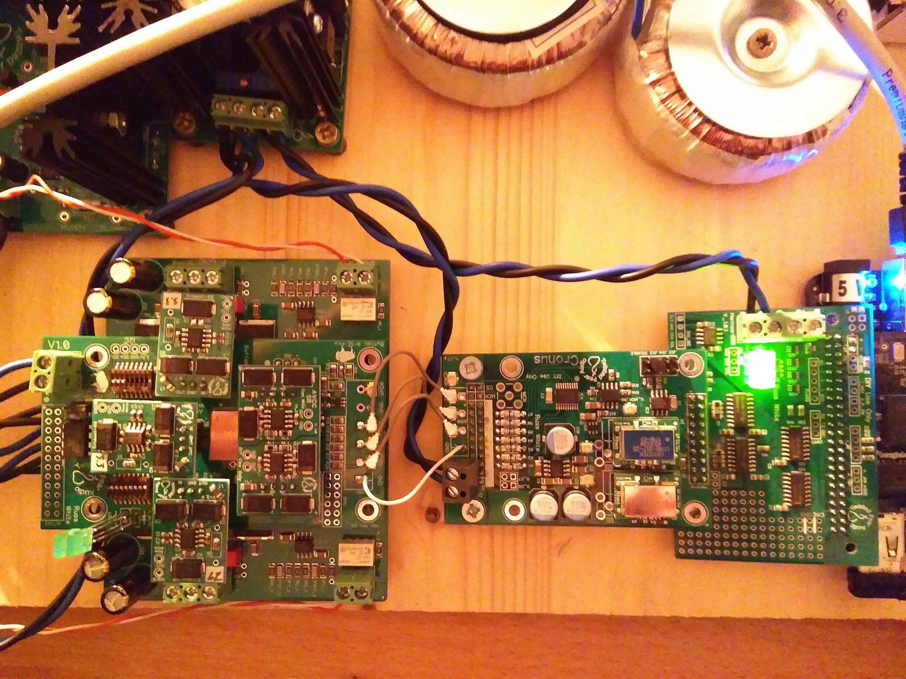

Thanks for your replies!!
Is the output of the LCDPS staying at 5V? It may be running out of current. At some point you might want to replace the small value resistor (I think it's 1R) on the LCDPS with a jumper - so that you don't have a huge voltage drop after it. Only do this if it is actually running out of steam :)
You may also want to use a more stout supply like the Centaur. Centaur was purpose designed for higher current loads like this application.
So far the LCDPS seems to suffice. The output stays at 5V.
Also you should install the indicator LEDs on the B3SE-pro - so you can see if things are locking and/or auto-mute is on.
I installed both LEDs. The A_Mute LED just lights up briefly when turning the Buffalo on. After that both stay out.
Also - make sure you set the dip switches for PCM/DSD input.
See here:
GitHub - twistedpearaudio/Buffalo-III-SE-Pro-On-Board-Firmware
Switch 1 - Position 1 should be off.
I have completely overseen this! While trying to change it, it fell off :-/. I just put in the important positions 6-8 again. The others should be fine with the "off" position. I also checked the on/off state for all positions.

Thanks. This seems to be OK.
I guess that clock signal is correctly routed into BBB, because speaker-test was playing (printing messages).
I suggest you to check voltages on DCK, D1 and D2 pins (relative to their GNDs) on the input and output of the Cronus. Be sure to use matching GND, as they are not connected.
The best option would be check them with an oscilloscope, but a decent multimeter might "work" too.
Check first with AC milivoltmeter. There might be some non-zero voltage - a signal present.
Have you tried your B3 with another digital source than BBB? For example with SPDIF optical receiver. Just to be sure, that B3 works well.
Thanks for your help!
I think I found the mistake: I had no u.fl connectors available and my local electronic store also didn't had them, so I just used a simple cable totally forgetting that the u.fl connector has two poles. I realized it when you said I should measure to their respective GNDs. That should be it, right? I just ordered the connectors. :eek: Sorry...
There is already a gnd connection - so no need for uFL.
I am pretty concerned by state of your switches... This is a first for me - I have never seen them destroyed like yours before :) You will need to be sure that the signal each switch controls is actually low (0V - or closed) or high (3.3V or open) manually - fortunately you have a header there for that.
Cheers!
Russ
Doubtful - u.fl connectors should be fine, but they are not required.
Damn, I thought that was it :).
The top just fell of when I moved one of the switches. When I measure at the GPIO Pins I get the following values starting from the upper left (with respect to the GPIO label):
1: 3.3, 0.0, 0.0, 0.0, 0.0, 3.3 (V)
2: 3.25, 0.006, 1.6, 3.5, 0.001, 0.0 (V)
1: 3.3, 0.0, 0.0, 0.0, 0.0, 0.0, 0.0, 0.0, 0.0, 0.0, 1.5, 3.3 (V)
2: 3.3, 0.0, 3.3, 3.3, 3.3, 3.3, 3.3, 0.0, 0.0, 0.0, 3.3, 3.3 (V) - an the mute LED lighted up briefly when I measured the last three values.
Sorry, I cannot see how the 2 x 8 switches related to the GPIO pins. However, I ensured with a multimeter that the switches that are "on" are actually connected. That seems fine.
I did as you instructed. I cannot see a difference to to power connection. So, there seems to be no signal from the Cronus (?).
No, unfortunately I have no other source available.
One more thing: I measure 10-30mV at the Mercury outputs when its turned on.
Any ideas left? :-/

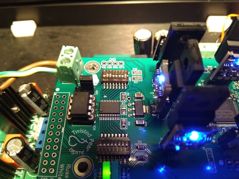

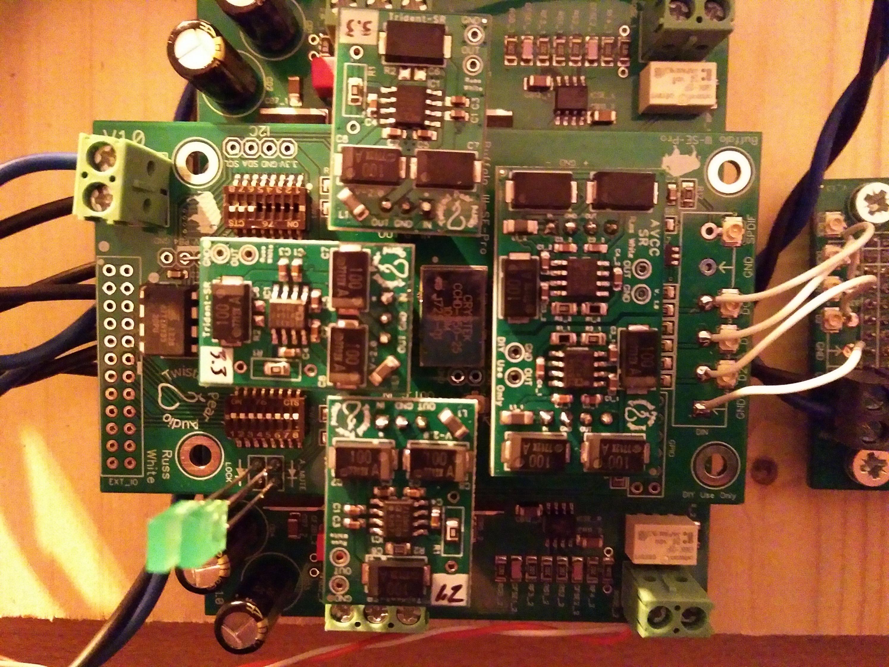

I'm having challenges with digital noise from the BIII-SE-Pro28 board.
When operating either with I2S or SPDIF input then after several minutes then digital noise appears randomly in both channels
Se picture of dip setting for the I2S input. The Sync is ON all the time. I also measured that there are constantly 5V on the main input.
When I turn off the DAC and turn it on again then it works ok for some minute before the digital noise appears again. Unfortunately I can't attach a sound file from this site does not recognize the format.
If I go back to my old BIII then there is no noise and it works nice with same setup including the Voltage regs
Any clues to what is wrong? I have tried a second BIII-SE-Pro board and same problem!!!

Sounds to me like one of your regs (probably 1.2V) is running out of current or getting too hot. This wouldn't happen on the older DACs - they use a lot less current. Also we recommend running that supply at ~1.25V as opposed to 1.2V.
Cheers!
Russ
Hi Russ
Thks..I measured the voltage across the VDD and it was only 1.1v. After connecting external PSU with 1.2v then plays fine 😀👍

So, the u.fl connectors just arrived, but - as you already said - this did not change anything. Still no music playing.
What else could I do? Can anyone interpret the voltage measurements? I take every hint :)
