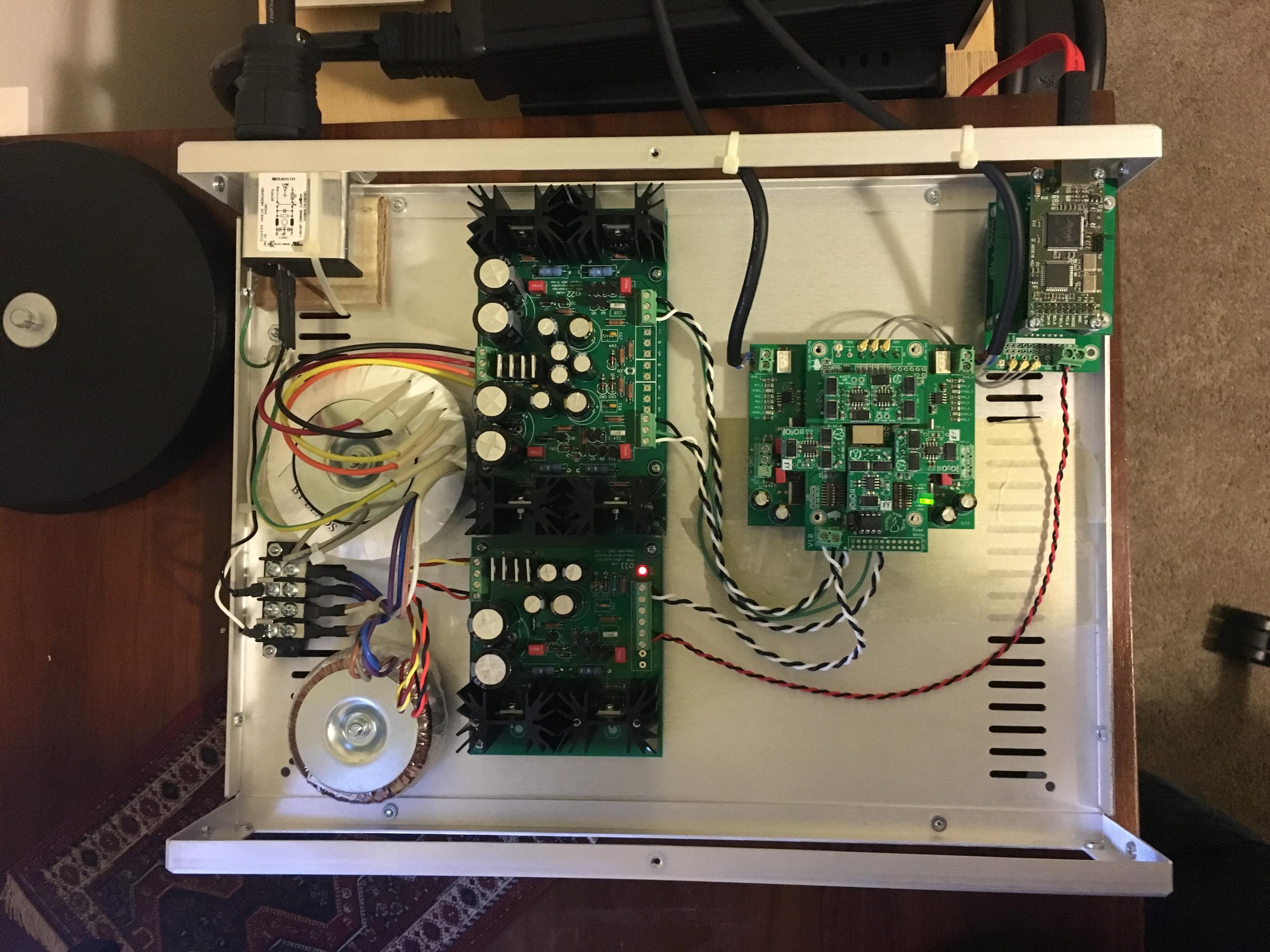

How to wire XLR to chassis?
Hey ... really enjoying the B3SE with Mercury so far, best DAC I've heard! (and I've had quite a few from Ayre, Bryston, PS Audio etc)
I've been using SE, and want to wire up the XLR outs to the chassis.
I'm a bit confused about this though, and need a bit of assistance.
Initially, I thought that I need to use a shielded twisted pair and wire like so:
Mercury GND -> Socket (1) with Shield

I've found this RANE article, and it recommends to connect as so:
Mercury GND -> Chassis
Mercury (+) -> Socket (2) with one wire
Mercury (-) -> Socket (3) with second wire
Socket (1) -> Chassis
(shield seems redundant in this scenario).
Sound System Interconnection
What is the correct approach? I don't currently have anything going to Chassis except IEC ground.
Attaching a pic of my build.
Thanks !

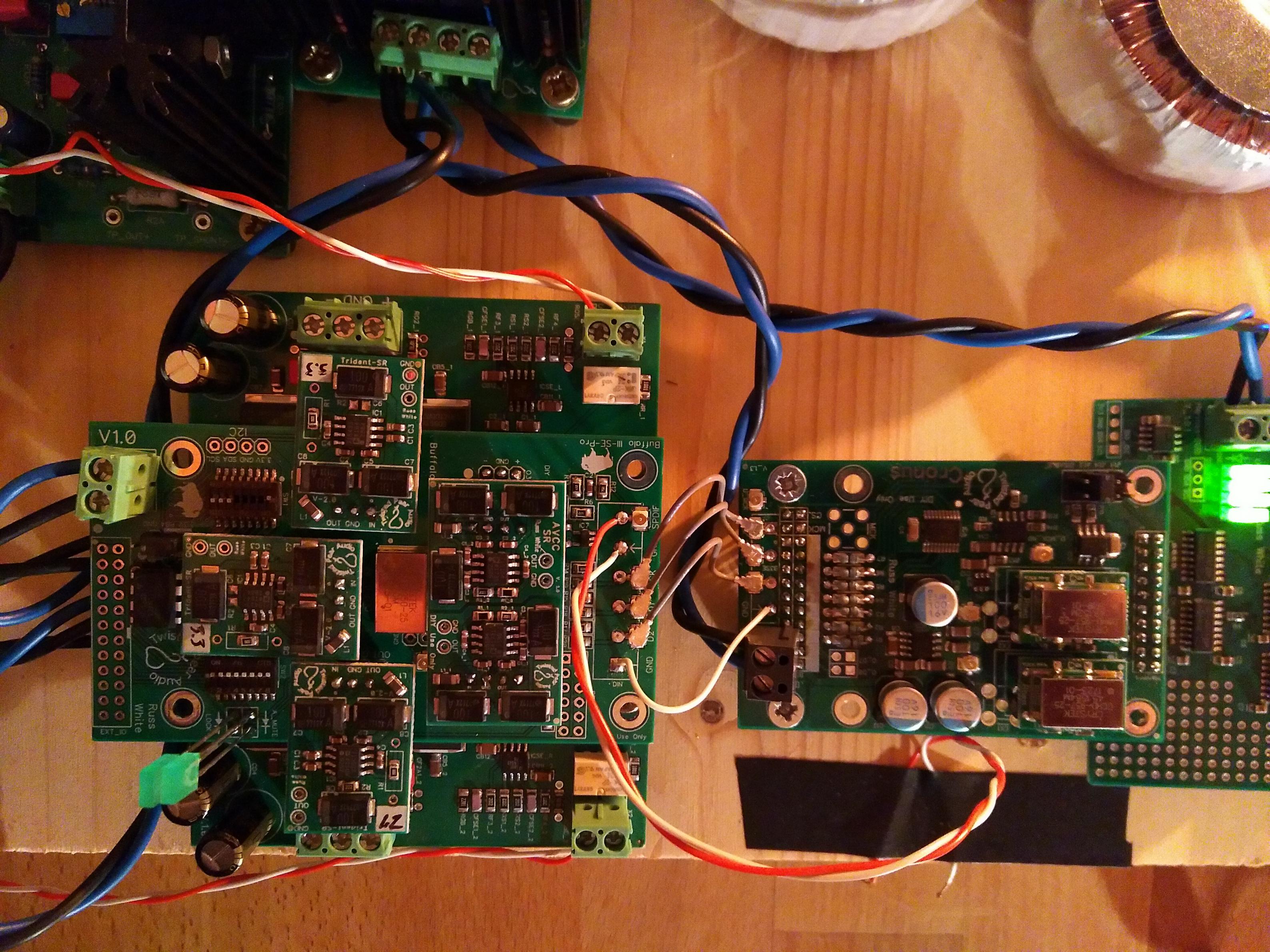

I followed your advice and used the prepared Debian distro including Botic by twluke: https://www.diyaudio.com/forums/twisted-pear/258254-support-botic-linux-driver-258.html#post5515941. Below are the outputs of the commands you mentioned.

I checked everything on Cronus. Looks okay for me :-/. When I run "speaker-test" I cannot measure a signal at D1, D2, BCK.
Still no sound. I attached a picture of the current situation. Happy for every help!

I prefer to use connection scheme number 2 above, this conforms with AES guidelines for wiring "balanced" connections, and I wire all my components this way. Keep the pin 1 to chassis connection as short as possible. I run a short wire from ground of the Mercury to the chassis, and make sure that all chassis panels are electrically continuous, which may require removing some anodizing or paint. Essentially this scheme assumes that your XLR cable is wired "correctly", that is with a twisted pair (or perhaps quad) for pins 2, and 3, and that pin 1 is connected to a full coverage braided shield, ideally with no drain wire. Here is a great paper on grounding, differential signaling, and balanced connections from Bruno Putzeys
