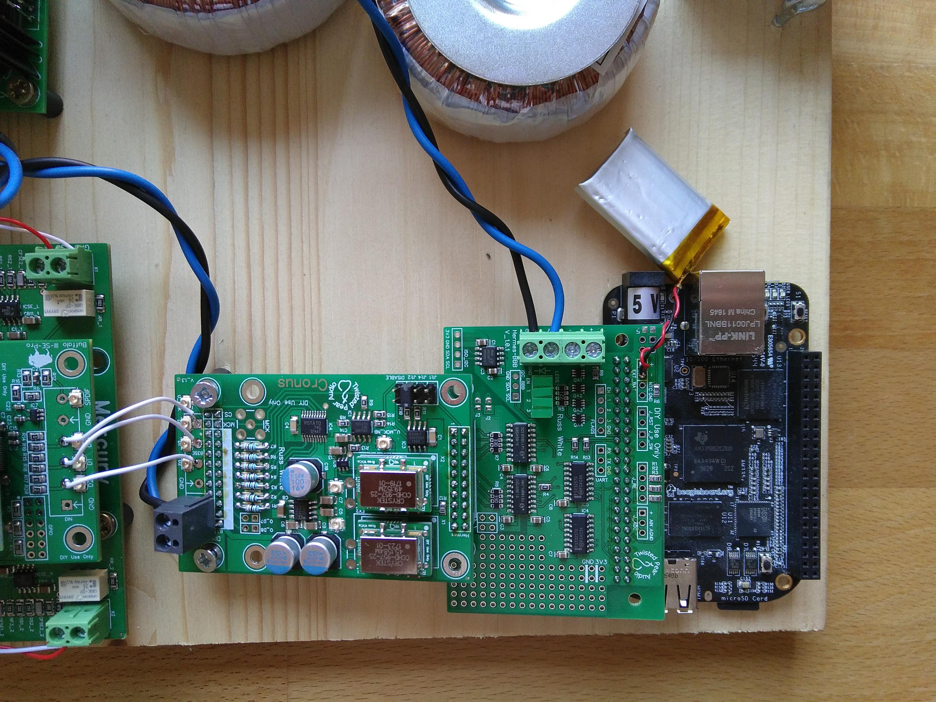

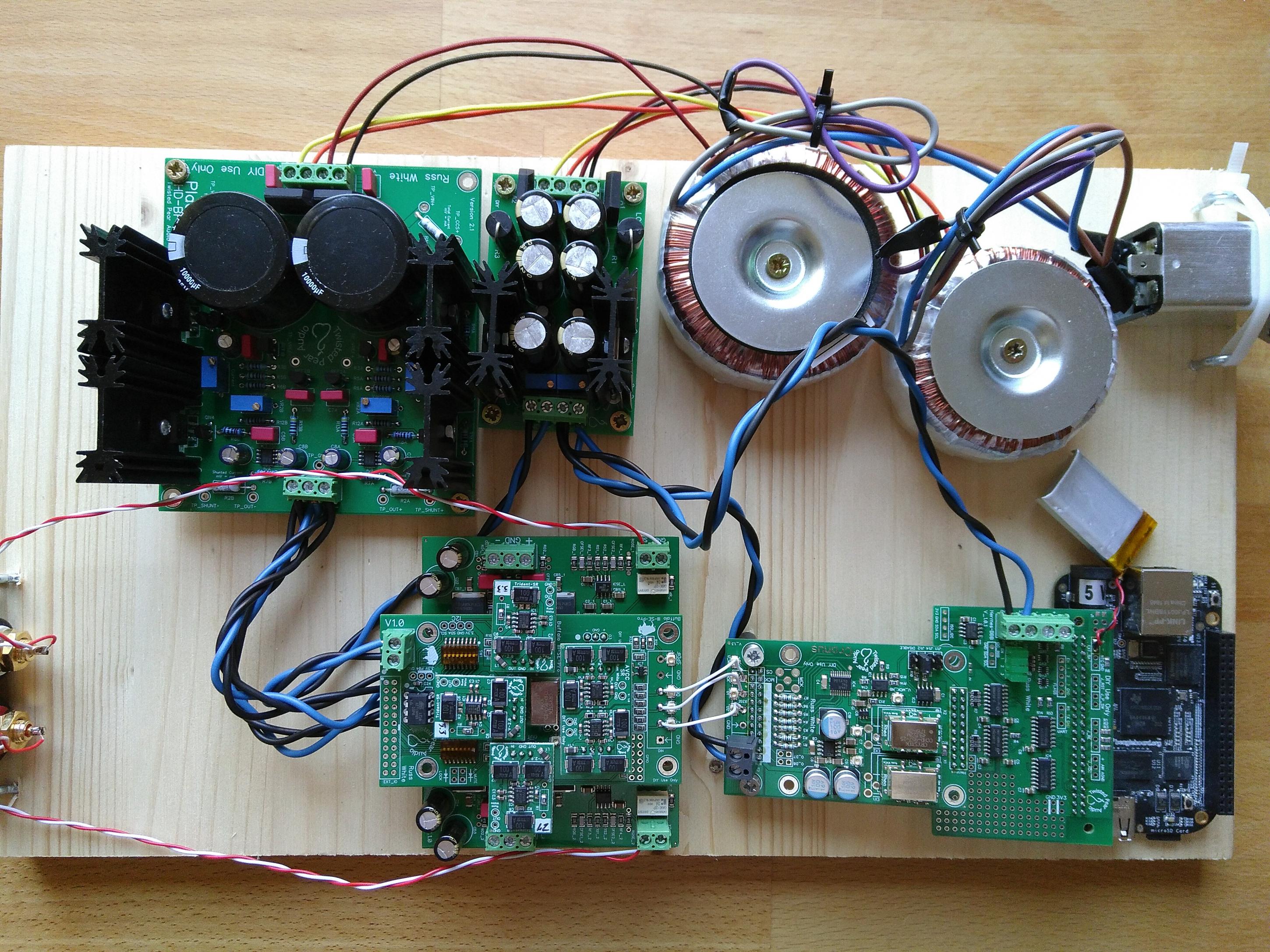

Hey, so I finally got the time to finish a prototype for my Buffalo-IIIsePro38 build.
It took me some time to figure out the exact wiring but in the end I think I got everything right. I configured the Placid HD BP according to the manual and adjusted the correct voltage of 5 volts for the LCPDS. After assuring that the output voltages are correct I powered up everything.
The good news: The relays on the Mercury etc. clicked nicely and apparently nothing blew up! (at least I couldn't see or smell anything)
The bad news: The four LEDs of the Hermes-BBB only flashed for a brief moment and it seems that the BBB is gone now. I am unable to turn it on with its designated power adapter.
Any suggestions how I should proceed? I attached a photograph of my prototype build. Anything obvious that is wrong?
Thanks!

Okay, so much about the correct wiring :-/. So, I will use the "left side" (regarding the photo) of the LCPDS for both the Buffalo and Cronus, use the "right side" for the Hermes. But this shouldn't be the reason for destroying the BBB and the Hermes loosing its power, right?

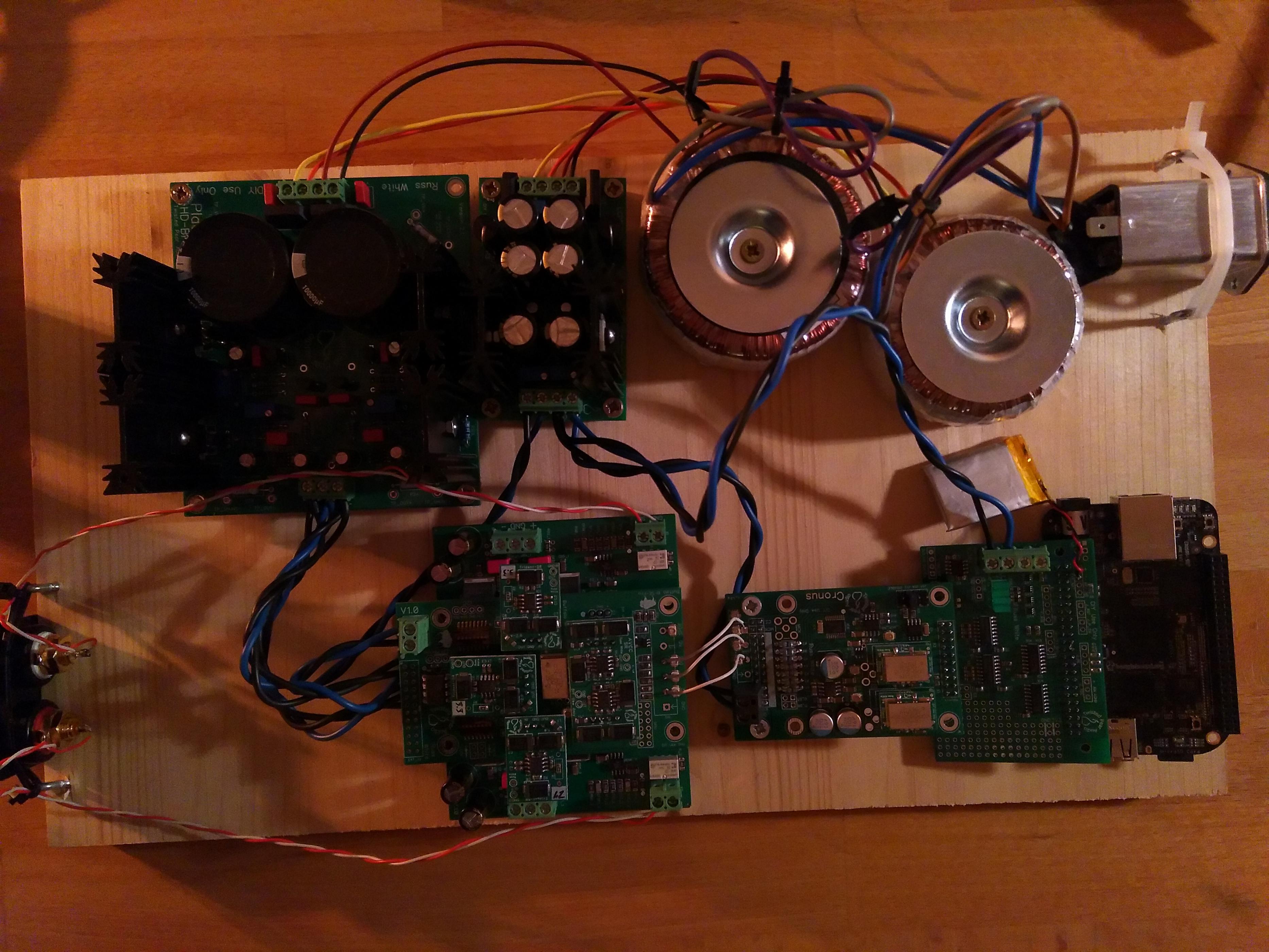

I provided a daylight photo of the whole setup and of the battery wiring also. I thin I took it from some online documentation. Could this be the reason for blowing up the BBB?
Surely not, but it could have a significant role in reduced sound quality or even ground loops

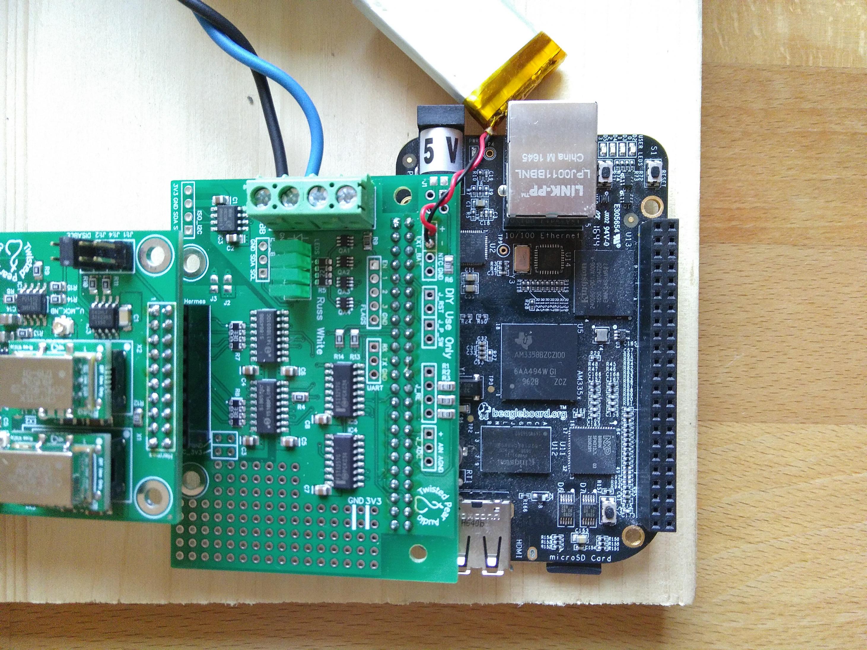

I think there is a misunderstanding about the small external battery used to avoid BBB damage in shut down.
I see in the pics that the two square 4-pins connectors (male and female) that should connect hermes to BBB external battery pads (near the barrel psu connector) are not soldered, so the protective action from the small ext battery did not take place. More, the battery has not to be connected the way you did: the ext_bat connector has a different purpose, for what i can understand.
Without protective action from external battery, BBB has to be switched off using the specific button onboard, otherwise it can be seriously damaged. Did you always switch it off using the onboard button?

You mean the four 2x2 connectors I circled with red? Where do I have to connect the external battery then?
So far I always powered the BBB with its dedicated power supply. This was the first time it was connected to the Hermes and the damage obviously occurred when I turned on the Hermes for the first time (as I said the Hermes LED's turned on for a brief moment and went out again).
