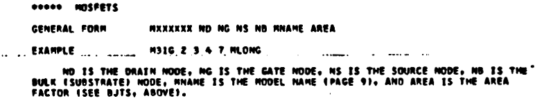

of course the names must be in the right order for the model, normally G D S . . . .
However that's not quite the correct ordering(!)
BJTs are C B E and MOSFETs are D G S
The authoritative reference is Larry Nagel's thesis; he wrote the original SPICE program and got a Ph.D (Don Pederson was his advisor) for the research. UCBerkeley reprinted his thesis as a technical Memorandum, which they included as part of the package whenever they gave away a copy of the source code. Screen capture images below.

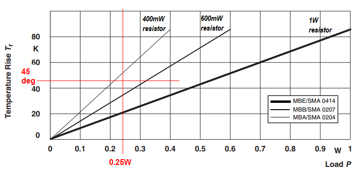

I opened this metal film resistor datasheet and found an incredibly useful figure that I've copied as an attachment, below. It quantifies something we already know, but tend to forget: when a resistor dissipates power, it heats up. When it dissipates a lot of power, it gets very hot! And there are the numbers, in that figure.
To choose an appropriate wattage rating, the circuit designer must
  1. Calculate the average power (over a 1 second averaging window) that the resistor will dissipate
  2. Draw a vertical line on the datasheet curve, at this power dissipation
  3. Make a human judgment decision: how hot is too hot? What temperature will we allow the resistor body to reach? How many degrees C above the ambient air temperature?
  4. Draw a horizontal line on the datasheet curve. at this temperature rise above ambient air.
  5. Choose the resistor rating equal to or greater than the intersection of those two red lines.
EXAMPLE
Suppose we have a resistor whose power dissipation is 250 mW. Suppose we will allow its body temperature to rise up to 70 degrees C, hot enough to burn a finger after 5 seconds. This is (70 - 25) = 45 degrees C above the ambient air temperature of 25C.
We draw a vertical red line at 0.25W and a horizontal red line at 45 degrees C. They intersect at a point where a 500mW resistor curve would go. So we choose a 600mW resistor and sleep soundly.
NOTICE that the circuit designer in this hypothetical example has chosen to let the resistor get very very hot. But in real life, you may not be so lenient. You may insist that no component can get hotter than 60C; or whatever your human judgment feels most comfortable with.

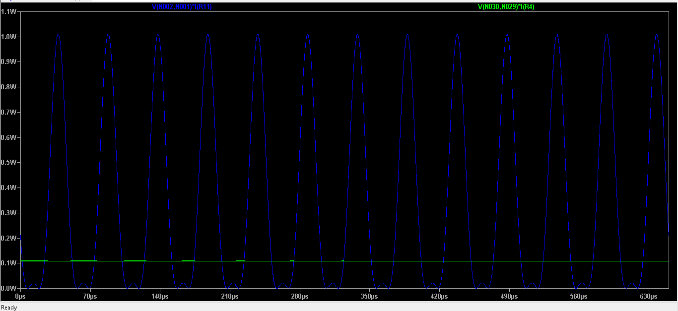

A resistor in a power amp is dissipating power like attached (R11).
What power rating resistor should I use for all practical purpose ?
regards
prasi
Depends. Is this with full power? Then remember that the average power that a power amp delivers with music is often only 10-20% of it's max power. Music has low average level.
Mark mentioned an average 1 sec value; that value will be (much) less than what you show, assuming you show at max power. In your case, I would be very comfortable with 0.5 or 0.4W resistors.
BTW Mark's curves are for very specific resistor types, and not all resistors are created equal in this respect.
