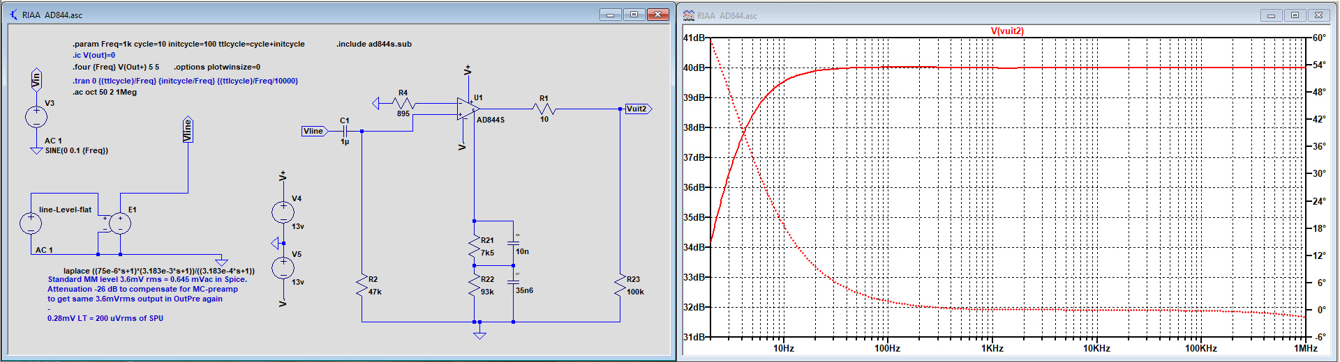

Thanks, it now works with the .cir as spice directive
And redrawing helped!
I have macos which is more difficult than windows.
Yep, the circuit acts and shows me the filter compensation effect of pin 5!
Here used as RIAA, [can be used for other filters too].
The circuit comes from LC Audio. I will try to get the .5 dB blob away here in Spice. The trick for now is using the input cap that is needed anyway as pole.

Jan, I know it is a different context but I just liked it a lot. Just a bit of play with words and ideas. It points to the special status of this device. No words enough to show that (translated from Dutch, you understand).
Ray: Sorry for any confusion this might have caused.
I got it to work just like the other circuit, but after the posting. It is great too.
Hans, this is great, wow, 135 Hz bump down to 21 mdB!, And yes, tailor the gain with R4 till it matches line level, in my case a Hiraga/Kanéda preamp used 'flat'. What I like about the approach using the AD844 is the 'isolation' of the circuit from any loading on the output and absence I expect of slew rate distortion (harshness).

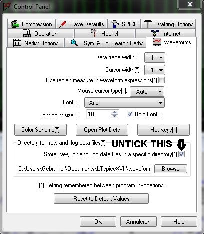

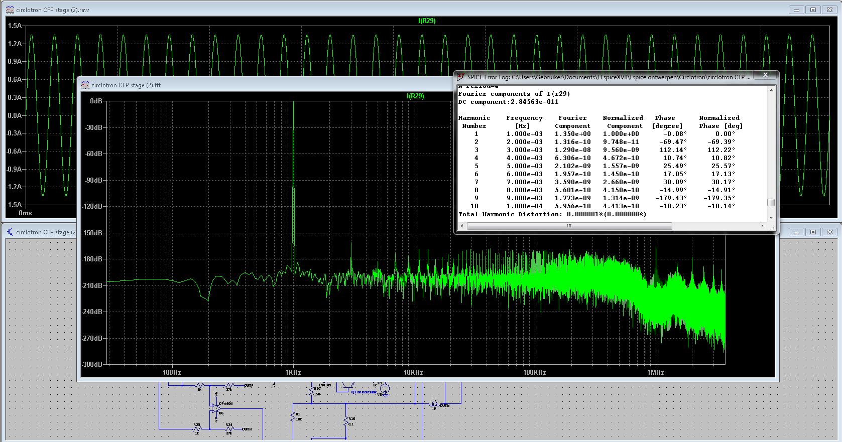

Hi All
I have never that problem but now I see error log is grayed out and can not plot the harmonic distortion.
Maybe I did something wrong, I did set the plot data on delete after close program, aii, I go look at that.
As I thought! Now I remember it was caused there, I did set a other (bigger) save drive for these plot data,
but then it refuses to open error plot, maybe a bug?

Kees, with all due respect, every time something doesn't go like you want you say: 'maybe a bug?'. How many bugs did you have so far? ;-)
How can you plot anything if you delete the file? Did you look whether the file is still there when you try to plot?
Jan
Non, because the last one was away with a update. This one is some strange why I mention this, if I choose a other directory then the error log is graying out, that was the question not these before because can shure be a bug.
I had contakt with the program author past year he was thankfully because the bugs are found by me when the 64 bit version was just come out and did crash a lot.

Did you have change the pad where the files get written? if that is ticked then it is grayed out, I do not now why , but untick making it much easier to read in ltspice itself.

It make no sense, normally you can set up a directory, I did this because the need of a bigger disk, I did get errors and crashes because the hardisk was full, so I did use the other hardisk where no windows resides, but then error log is grayed out, as I say it make no sense why it is grayed out.
Yes Mooly when updating you get afresh install, after that I do set it up to a other disk, but now because of that error I did put it back.
regards
