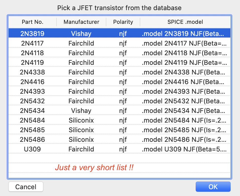

However, I still have the old (say 10 year old) list of components. For instance, I know there are modern FETs included now; is there a tip what to delete to get a up to date component library?
Should I manually delete the old installatie location? Where?
  • I See that the Standard.Jfet is from 6 juli 2014. The screen grab below shows the contents in readable form. I know there is a more elaborate list (around);
  • It is stored at user/lib/appl supplort/LTspice/lib/cmp --
- hope the MacOs is not left behind in developed new contents.

If you look carefully at what happens while you install or update, you will see that lots of files are updated, including models and sub-circuits. The latest installation will have the latest and updated models. No need to delete anything.
This is also the reason why you should keep your own models in a separate directory, otherwise they may be overwritten at with an update.

The problem is as follows:
The new TLSpice installs at /appl.support; but the old /lib data is found under
  • /users/documents/audio/software/ltspiceXVII
I have now copied the versionLTSpice XVII CMP to where the software is looking:
  • user/lib/appl support/LTspice/lib/cmp --
and now the software does see the expanded list.
So it seems the app folder points to a 'wrong' list somehow c.q. that it does not update the list in appl support/LTspice/lib/cmp when updating the program. The program is of course in ... application folder; there is a new Standard.bjt there (date: 10-7-20) and that ís the long list (up till SST5301).
So to put it differently, does LTSpice just check for a 'standard.jfet' and just find the first instance as stored under user/lib/appl support/LTspice/lib/ instead of looking at the contents of /applications/LTSpice? So should I delete the files under user/lib/appl support/LTspice/lib/ (just saving and leaving the newly added AD844.asy to the contents of /applications/LTSpice?

OOPS - now after deleting user/lib/appl support/LTspice/lib/ the list of components (pick a new transistor) is totally empty/B] :eek:
Solved that
OOPS- now after deleting user/lib/appl support/LTspice/lib/ the list of components (pick a new transistor) is totally empty/B]
I now also deleted the whole lib structure under the /users/documents/audio/software/LTSpiceXVII path (I had made that in the past, probably from migrating from windows to MacOs, anyway, long long ago)
So now the LTSpice might only be looking in the HD/apps/LTSpice subfolders .
And having put my AD844.asy there it just works flawlessly. Now I have to rethink where to store the files like AS844.asy to retain them in a next upgrade . . .:eek:
Deleting the whole under /user/lib/appl support/LTspice/ again gives me an empty list. So here we have the active referenced files. Not the data that has been updated at the HD/apps/LTSpice location where MacOs installs the new software. The update did not repeat not touch the data under /user/lib/appl support/LTspice/.
  • So what do other macos users do, copy the data from a new update to the applicationsupport path manually?

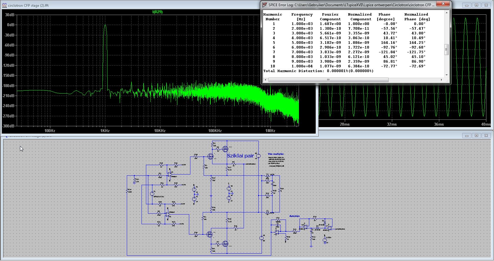

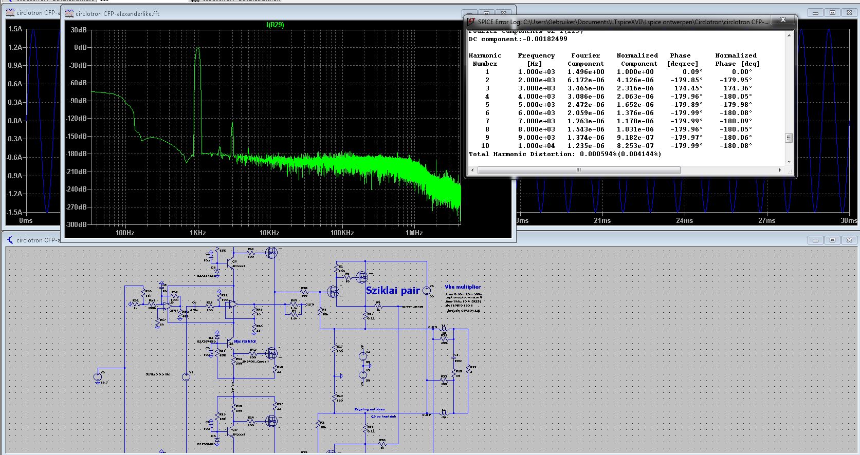

Maybe someone is willing to look at your .asc if they can probe current.
What goes wrong when you probe the current into or out of a pin?
Jan
it just do nothing, can not probe on the mosfet pins.
Maybe some error somewhere, did see empty pins and other errors in error log.
But schematic is some strange, I did a alexander circlotron haha, yes I combine things all the time, maybe a cascode for the preamp mosfets for more openloop. interesting.
regards
  • circlotron CFP-alexanderlike.asc
That did work fine I can probe on that IRF530 mosfet in your schematic.
I do use others in mine schematic like the irf 9610 who is also in the extra directory.
Here is a schematic included with mosfets as I did use in the powerstage, here I can probe fine.
This is not a ltspice program error somewhere it is wrong in schematic
regards
  • circlotron CFP stage (2).asc

Well this I do do now afcourse, I have put already more models in, the shape is not of importance I can draw a block with three pins and call it home, and it works.
The models are I think sometimes troublesome.
But I have found another trouble maker, an opamp, did change it for a 074 and it did work fast and oke.
the autobias did also well. distortion also, in sim that is.
