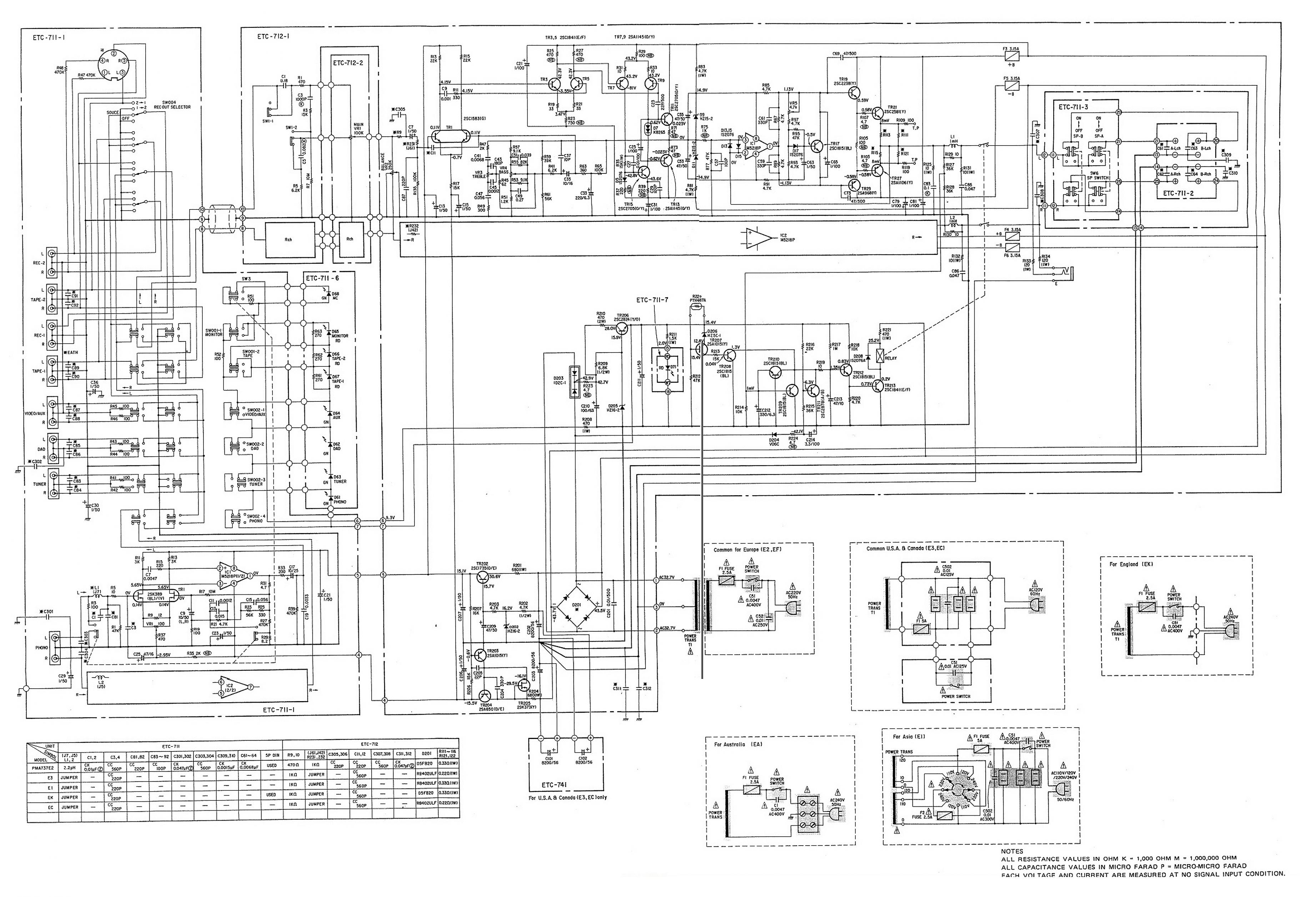

BTW, please post a big picture of the whole amp board circuit diagram so we can check it out.
This is the biggest I could get.

Now it can be seen. Your true input cap is C7. What value is C305?

C305 is 220pF 5% 50V, ceramic.Now it can be seen. Your true input cap is C7. What value is C305?
Karl, besides the caps you already removed (the ones marked red in your previous post) I'd remove C305, eventually also C87 (carry out a listening test after each mod), and increase C7's value replacing it with no more than 10uf.

Search for RF using an oscilloscope at 8, 9, and 10 at the interconnect between boards 711 and 712. You should have the amplifier interconnected to the preamp or any other module you are using as source, have them ON with no signal (just idling). If you don't find RF there then all is fine (I bet you won't find any RF)

I recommend you keep C305 and C87................ I'd remove C305, eventually also C87 (carry out a listening test after each mod), ..............
They are your RF attenuation at the amp input.

Karl, yes, C7 should be electrolytic. Regarding C305 and C87 I meant the caps in board 712 next to C7 (it's strange why they use the same labeling for components in different locations.
Remember as said above, to modify the right channel as well!
If you were to put the caps back may be you just use the same you removed, but in any case if you want to replace them ceramics would be fine.
I agree with Andrew that all those caps mentioned (except for C7) are for RF control, but many times they are overkill and do have an impact on sound since they are in the signal path.
I do strongly recommend not removing those in the input connectors negative side to ground though.

Okay, here are the two input caps C7 (left ch.) and C8 (right ch.) in board 712 to replace with a value to max 10uF.
And C87, C88 to possibly be removed after some tests. C305 and C304 (not shown here), too.
I'll do it in the next days and will report back. Thanks!
P.S.: Any further tweaks/improvements on board 712 will be welcome.
