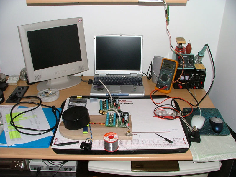

Hi P-A
Both PCB's are ready to test. One monoblock is temporarely wired up, altough without the op-amp and LM3886. On the first attempt the 1A fuses blew as soon as I flicked the power switch. For the second attempt I used 2A. This is what I measured so far:
AC to primary winding= 235V
AC from secondary winding #1= 27.8
AC from secondary winding #2= 27.8
DC voltage after rectifier= +37.6 / -37.6
DC voltage after regulation= +13.94 / -12.19
These figures look good enough for me, altough the regulated positive voltage is a bit far of the 12V target. I will check these again when the op-amp is in place and therefore the power supply sees a load.
And now I'm going to bed.:angel:
Walter

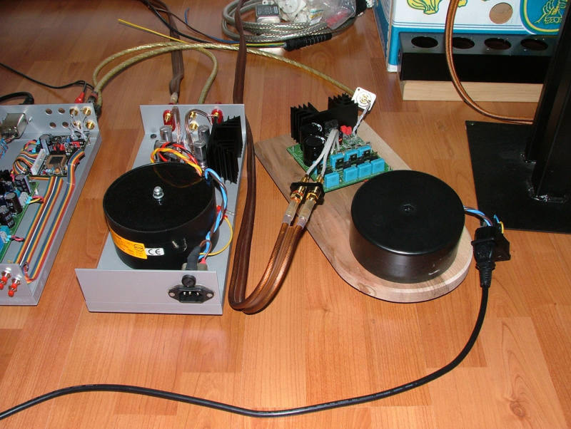

IT'S ALIVE!!:bigeyes:
One channel is playing for the moment! Nora Jones has the honour to brake in the new chipamp. What I can tell sofar is that this one sounds smoother than my other GainClone. Voices are clearer, even with only one channel playing this is noticable.
On the technical side: DC offset must be low because I can't measure it with my DMM!?;)
A big thumbs up to P-A. You managed to create a nice sounding amp, even if it's with those eyesores called SMD. Before I finish the other channel I'm first gonna concentrate myself on the chassis.
Sofar I'm a happy fellow.:)

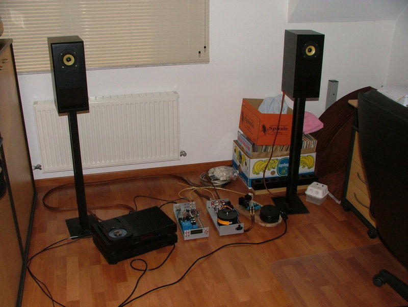

Hi P-A
As you can see in the picture, the two monoblocks are now playing side by side. As I already mentioned in a previous poste the sound is less harsh, more relaxed compared to my other GainClone. Another thing I've noticed is that the soundstage is much wider, more air to it. I'm gonna let them burn in now for a while and listen how things progress. In the meantime I'm gonna concentrate on the housing.
Cheers
Walter

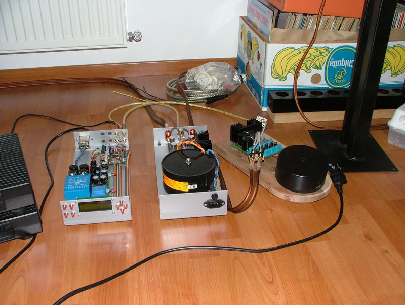

Anders, this is a mono block. Signal in + signal ground, 2 x AC, speaker out. You ought to have 8 wires in total. Do you have that?
Walter, Im happy that you are pleased. :up: :birthday: :cloud9: :drink::nod:
Walter, if you are going to measure the output offset voltage your voltmeter must be able to handle 0.01 mV or less. My APPA305 have 0.001 mV as the lowest number. Isn't it disturbing to have a voltmeter connected and it reads 0.0 mV? Is the voltmeter really working. Is the amps swicthed on? :)
