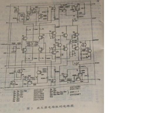

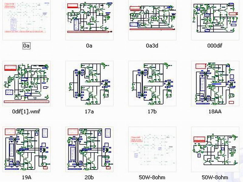

I have the pleasure to present you, some antecipation of Symassym...class AB.... 50 watts RMS also and using same voltage as GEM and AKSA...here is the diagram, without values..next week...wait for it please.
Mr. Graham Maynard made the kindness to simulate and compare with GEM, he said specifications was better to GEM...i do not know the percentual difference, and the details...he did not assemble...the ones that assemble was the designer, Michael Bittner, Mr. John Mateus, and I only.
Hugh Dean made his evaluation and told that he apreciated the schematic, and also apreciate the GEM schematic...he is a Lord.

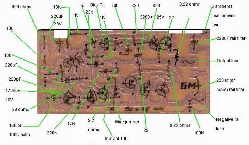

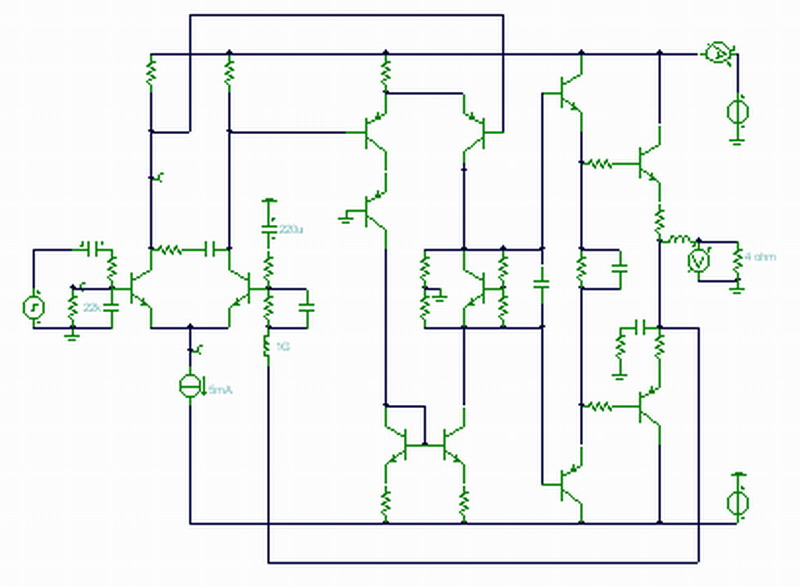

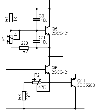

Re: Greg, here is the sketch, Graham will check for us.
Carlos, thanks for the sketch. I have looked through my books and stolen a few ideas. Anyway, here's my sketch. The values are just ones I picked up as the most common, I don't know if these values apply in this case. I need to know the current flowing through the VAS bootstrap resistor but it is just too simple for me to work out.
destroyer X said:If some error, Graham will correct for us.
It is missed in the sketch, but the Q5 lower resistor, the 470 ohms, is in the reality one trimpot.

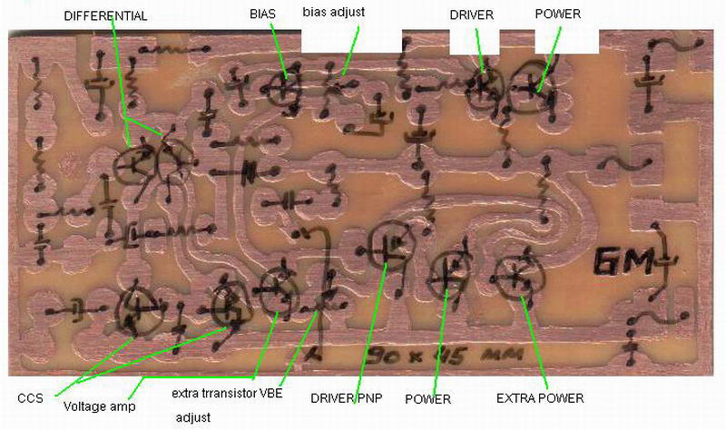

Hi Graham and Carlos,
I've been having a look at a layout for the GEM. I like to have all the components mounted on the PCB (excluding PSU). The output transistors are mounted on the PCB with the heatsink ledge between the transistor body and PCB. Like Rod Elliott does in some of his projects. (e.g. option 2 for the P3A)
I am wondering where you guys are mounting your 10,000uF filter caps (50V are big). Are they really on or near the amp PCB or am I misunderstanding and these are actually the PSU filter caps?
Could these be mounted on the PSU PCB and smaller decoupling caps used on the amp PCB. I suppose I'm asking if having large filter caps close to the output transistors are an important part of this design.

I am using small electrolitc condensers directly over the amplifier board.
My PSU is inside a metal case, and many parallelled caps are inside.
In the reality Greg, there are two transformers, each one with their own full wave rectifier, and if i remember (do not know exactly) there are around 15000uF capacitance each rail.
I am using 40 centimeters of very heavy gauge wire from PSU to circuit, so, keeping wire resistance as small as possible..but always some tenths of ohms exist there... and this can create a charge-discharge cicle in the amplifier board... the oscilation will start because of that, when having too much wire resistance... one of the possible causes to start oscilation.
This was my first important information (my case Greg) when i was 9 years old...having any resistor to reduce voltage, in any amount, have to install condenser after to avoid oscilations.
Was very important to me, that experience in real world construction.
I think Graham, and the ones that can see schematics alike a color movie picture inside their brains, that will never accept an amplifier without a very close condenser...directly installed over the main amplifier board, and having very small distance from the board rail voltages.
Not only Graham, but also Michael will not accept small condenser over the board, as i use to do, and half world use to do.
Well, those guys, alike some hawk, have other "vision" and use to put those "Aircraft Carriers", those enormous electrolitics over the board.
Despite that i do not bother about appearance...in my point of view this is too much uggly in appearance...and i use to not do this way....but this may be result of my ignorance related this need.
I think you have the rigth to install your Condensers directly over the board, as suggested by Graham.
I will try without them over the board, but really i will be a little afraid, that i can be loosing something without install them over the amplifier board.
Let's see, if someone will run to help me to "kill" this doubt.

Thank you Greg, i will use your schematic, and i am sorry, the one i suggest was "with inverted logics"....was wrong, i am very sorry.
The 100 ohms trimpot, that you substitute with a 47 ohms trimpot, with a resistor in series, i think 50 ohms will complete the standard value, and can be installed in the place you put interrogation marks.
The clever resistor network you made, for the bias adjustment, will be better to have a result of 1K ohms when you add all resistors together....but will work also, as normally this network is calculated from 3 to 10 times the real base current..so, will work great!, and protected against mistakes that can produce enormous current.... depending on supply capacity...the 220 will be the main protector.
I use 35 volts condensers to 35 volts rails, but industries never do this way, always bigger voltage ratios are used....normally 50 or 70 volts condensers to 35 volts rails.....i think will be more safe, and more expensive, more big and more ugly too...unfortunatelly. Decoupling 100N caps are very safe, to help drains starting oscilations to ground... electrolitics are coiled inside, as you know, showing resistances to high frequencies travell inside them going to ground.
Greg, if you know how to make, having a good CAD tool to help you, please, make this board you are telling that will prefer to use..this one with power transistors installed over it...and publish that board here, will be a very good cooperation.
I know my boards are ugly and strange... i first created them when very young and doing the same now a days...my board was created in 1970...this was made to be simple, fast and to go checking while assembling...to use glue to fix boards, to avoid shorts...but it is not the kind of work people prefer, as the guys majority in this forum, are producing diy work but alike professional does...not as home made diy work, without more pretentions are beeing done here...so...having the chance to help us...please, go ahead and prepare a more professional board, that will be very well received by the community majority.

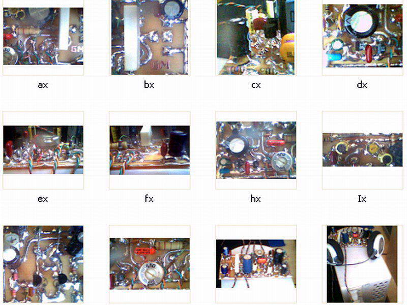

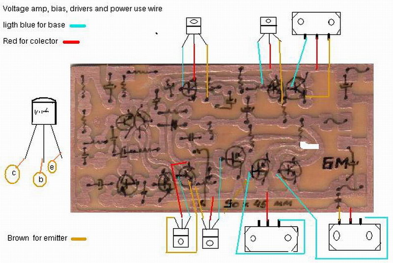

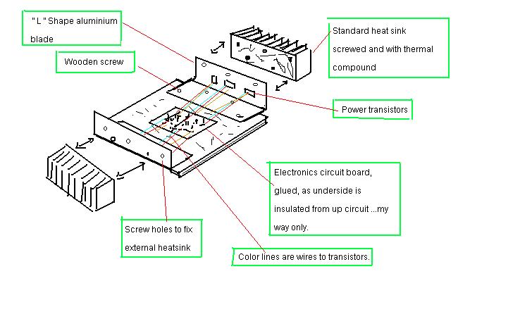

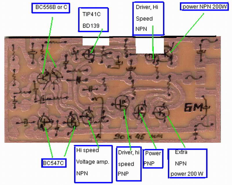

A new GEM board already assembled
Here is some distant images...not to see defects.
Twisted wires produce capacitance, have to keep them small in length.
Better than run 3 wires to each transistor, produce interconnections between them, from transistor emitter to colector.... joining colector using the heatsink conductivity and avoiding twist them.
Monday i will put it to run.
regards, and good weekend to all.
Carlos

Hi Greg,
Regarding your bias sketch.
I use a clear bodied 15 turn 1k and 50R Bournes Multi-turn cermet trimmers. The adjustment is very extended for the class-AB adjustment but a little more critical though still easy for the class-A biasing.
I have not used those little horseshoe shaped horrors for bias adjustment for some time, and thus it did not occur to me that I should mention anything.
Just use 15 (or 10) turn pots as they are; it much more simple.
I don't like mounting power transistors on a pcb and then bolting them to a heatsink.
After a working lifetime of bad words related to thoughtless designers who turn simple repairs into ten times the work stripping everything down, well, what more can I say; there's clever/smart and there's common sense ! Swopping wires or trying a completely different device type when the are heatsink mounted is just so easy.

Hi Greg,

Graham Maynard said:Hi X.G.
Didn't get the chance to post this yesterday.
Thanks for your feedback, I'd love to see the circuit - can you show a copy ?
I have seen class-AB + CCS before, and I have seen claims that it maintains class-A operation.
To me all it does is maintain class-A in one half and offset the zero current class-AB crossover for the other, though such an arrangement can work better when the load is a *resistor*.
Here I have a separately active class-A device helping error correction at all times, and particularly during class-AB crossover at whatever voltage the loudspeaker might induce a class-AB current crossover. The lower class-A device is constantly working with the upper output half in the same manner that a JLH class-A amplifier operates.
I also retain JLH class-A bandwidth and low output inductance.
Cheers ....... Graham.
Hi,Graham
you are right.the Janpanese Power amp what I say just is Class AB output + CCS,like the OPA set in 'class A ' by many DIYer....but to me,it is the first amp using this method.
I can't find the original article now.this is the same circuit in Chinese magazine:
cheers
X.G.
Hi Carlos,
You mention me fitting some electrolytics on the board.
I have indeed, and up to 1mF for the rails.
This time I am fitting only the parallelling capacitors, with the 10mF beside the pcb and them held in place with double sided sponge tape.
And I agree with you, neat boards do not always mean neat performance.
A correct topology is more important than a pretty board.
Circuits. I have so many on different floppies it can take an age to find any one. I don't keep them in the simulator folder because I keep running out of modification numbers.
Actually I am not thinking about any more power amplifier circuits.
The last one works nicely, and that is it. Search over.
Hi X.G.
Thanks for posting the circuit.
When the lower class-AB output half of that amplifier is not conducting, the output control is unilateral, ie. only the upper output half is active.
With my circuit the class-A drive is actively continuous in both halves, no matter what the class-AB arrangement is doing.
Cheers .......... Graham.
