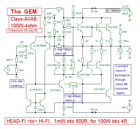

Hi stocker,
It already is the final circuit. Now named, as attached.
I could do many things to this circuit, but every option has an associated disadvantage.
At <0.01% this circuit does not have the super-low thd performance that some designers claim, but then nor does it have the NFB loop created output inductivity or poor phase coherence they don't even mention !
At present it has approximately 125W - 4 ohm maximum output, but I recon it could be taken to +/- 45 V rails for 100W - 8 ohm simply by changing the 390 ohm bootstrap feeder to 680 or 820 ohms, and I will try this, but not just at the moment.
I want to think about a novel variable input filter where you can gradually pull down the hf response for less dynamic background/leisure listening, though this would not be just a simple tone control.
I'd be happier with auto-speed silent fan cooling, though no problems so far; its just that an automatic fan would give total peace of mind.

Couldn't get page to 'submit'

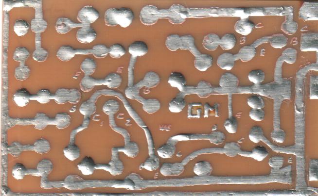

Fresh brand new dismounted board, "I will be back"
A good friend knowing that i lost my Sankens told me nothing.
10 minutes ago he called me by phone... and say, already gone.
Then i asked him what is gone?
He told me one pair of Sankens gone to my home adress by mail..hehe...in 24 hours more Sanken...and will hear GEM again!
Here is the board dismounted, one of them, will make it again.
This board was made for the second Graham circuit published in this thread, and missed one trimpot to adjust bias.
This board is not for the last GEM version.
Never give up!
I will be back!
regards,
Carlos

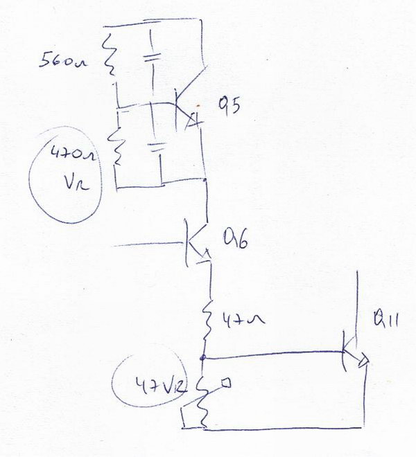

Graham,
Thanks for the feedback on my schematic of your amp.
I don't quite understand the implications of the low input impedance. Most amps range form 10k to 100k but the GEM is only about 600 ohms or so. Does this mean you must use a pre-amp? Also, the lack of an input cap means the device connected to the input must be free of DC.
You mention bypass caps, which I assume are the 2 rail filter caps but should the feedback cap C6 be bypassed as well.
Can you give a few details of the PSU? Carlos has sort of hinted at what you have but I'm not clear. With big caps at the amp you don't really too much on the PSU.
What sort of DC offset can I expect?

The extra transistor can be measure the same way....install a resistor in series with the colector and measure the voltage there...lets imagine 40 milivolts for instance,...using ohms law, you have to divide that voltage expressed in Volts (0.040V) divided by the resistance expressed in Ohms (0.1 ohm).. this will result in 400 miliamperes.
To first power on, install 5 ohms resistor, 5 watts in series with positive supply and another one in series with negative supply, this is some protection, because 5 volts will be over that resistor when the current reach 1 ampere...check if both rails have the same voltage over those protective resistors.
They can be used to obtain the current that is circulating, as you can divide the voltage you find over those resistors by its own value to obtain current...let's imagine you found 7 volts:
7 / 5 = 1.4A
In this case, have to reduce current in the main bias trimpot, the one that have the auxiliary transistor.
If something was wrong, and enormous current cross the circuit rails, the voltage over the protection resistor will be enormous..let's imagine that you measured 31 volts over the resistor... this have to be done fast, if not the resistor will melt or explode..too much power over it... the supply switch must be near your hand...or install fuses to burn and open the circuit if something turns bad to you.
31 volts measured over 5 ohms resistor will be 6.2 amperes.
The interesting is that only some volts will be applied to the circuit, this will limit the power circulating... if 6.2 amperes are flowing, and 4 volts are measured (35 the supply voltage less the 31 volts that was developed over the 5 ohms resistor give the result of 4 volts....or the supply lost voltage and over the board only milivolts or you can reach 4 volts there.
Power is voltage multiplied by current...so.... 4 Volts multiplied by 6.2 amperes result in 24.8 watts...no doubts that 100 watts transistor will be alive in that sittuation.... reason why people call that resistor protective resistor to power up.
Well, save this to future references...needing more details i can do it and send direct to your mail adress...just tell me if you need something more, telling me your mail adress to.
If i am explaining something that you already know..something you are tired to know.....very basic informs to you, excuse me, i am sorry, have no intention to disturb you...but will use that to inform some details to the very beginners that use to read our forum to learn some...as i use to do also.
