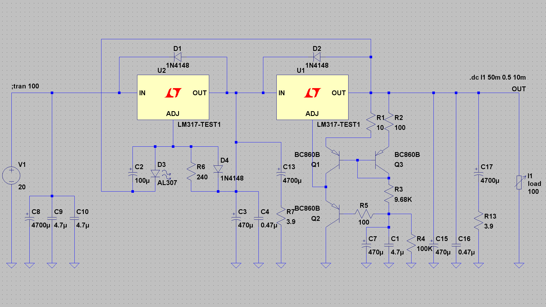

Need a good model of LM317 for simulation program LTSpice IV, all known models in internet work bad.
I tested 17 different models of LM317 in LTSpice IV and the results were bad and very bad for models.
When simulating the LM317 you have to remember that the voltage is referenced between Vout and Adjust. (i.e. not ground)
Put a 1 ohm resistor between the voltage divider and the adjust pin and drive 1mA across this resistor. Gives you 1mV of perturbation voltage.

Hi Jenyok. I assume that you're not happy with the output voltage dropping with increasing current? Have you done any real world tests to ensure that this is not something that happens with a real LM317?
I ran a sim on the model I had and the results seem well within spec for an LM317
15.27566V @20mA
15.27147 @ 500mA
actual difference = 0.00419
0.3% of 15V = 0.045V (load regulation is specified as max 0.3%)
Picture attached. Or have I missed something?
Tony.

Yes, simple tests are of the output voltage dropping with increasing current from 0 ... 0.7 A .
Value 0.3% and 0.00419 Volt or 4.19 mVolts seems to me, that LM317 is a very bad as a voltage regulator (stabilizator).
I am very unsuccessfull that current value from 0 ... 20 mA gives about 10 mVolts dropping of output voltage. I don't understand, why ?
You have to pull *at least* 10mA according to the datasheet for the regulation figures to be accurate. No regulator I know of gives +/- 0mV at zero current draw. You can avoid this by ensuring a 10-20mA minimum current pull (e.g.load suitable resistor permanently accross the output) or maybe your circuit already draws this minimum amount; in which case you don't have cause for concern. Beleive me, I've done all sorts of discrete regulator circuits; it's one of the first things you learn when building them in PRACTICE.

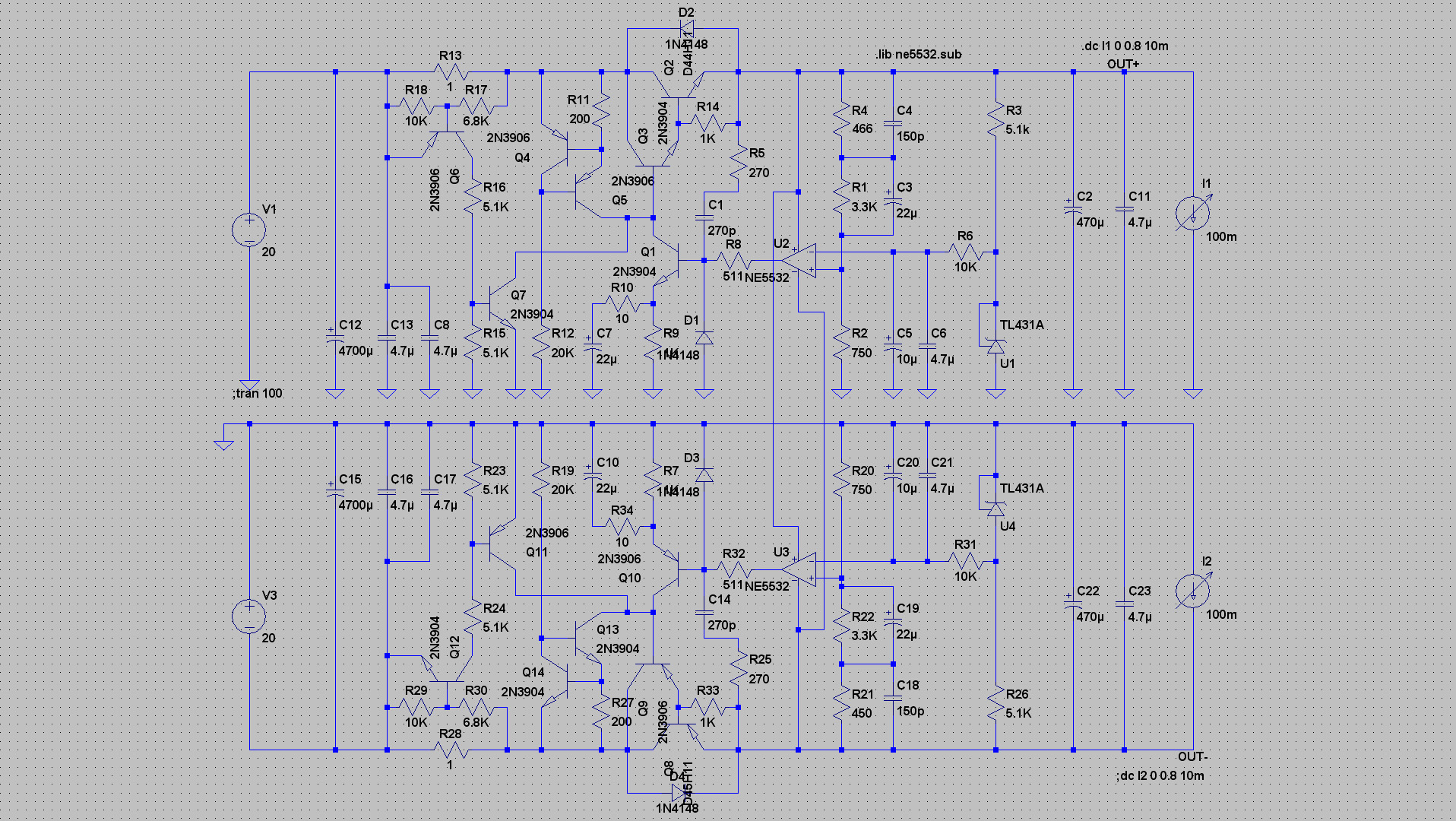

Try to simulate our Russian circuit of power reg, see results of simulation and compare results with LM317 as a power reg.
Output voltage ~= + - 15 Volts .
Output load current ~= 0 ... 1 A .
ASC file of circuit for LTSpice IV is in ZIP file.

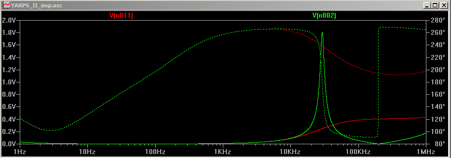

Zobel network at LM317 output
I have noticed that Morgan Jones uses a 2R7 resistor in series with a 1uf capacitor at the output of the LM317 circuit. Is it there to prevent possible ringing or oscillations? Are LM317's notorious for such incidents?
By the way, I have built a simple guitar preamp using 30V regulated with the aid of a LM317 circuit. But when turning on the amp, there is a high frequency audible noise (close to 20kHz - maybe 15kHz? - I don't know) for 1 or 2 seconds, and then normal conditions - just like charging noise of electric weapons . I have noticed that it happens when the electrolytics have been completely discharged. When turning off and on again quickly, no such sound can be heard.
Is it possible that this is a momentary oscillation? The sound is like a pure sine wave. I am using two 100k resistors at the output to cut the 30V in half, putting a 220uf cap in the 15V joint. And of course this cap charges slowly, could it be the cuplrit of the transient?
Thank you for any input!
Yes the resistor in series with the cap on the output is to suppress a resonance that occurs due to the output inductance of the regulator forming a tuned circuit with the output capacitor (normally only an issue if you use low esr capacitors of fairly large value).
2.7 ohms seems a little on the high side (I used 0.33 ohms on mine, which was right on the edge in the simulation).
I am using Nippon 22uf (63V, KMG series) - I don't know if these have such low ESR, but I don't know if this is the problem. I can experiment using an additional resistor and tantalum cap. Thanks for the answer!
Any tips on the weird charging noise? Could it be the resonance you mention?
Not really, here's a handy graph:

Thanks Martin! I suspect that the inductance in the model I have for the LM317 doesn't reflect reality I just simmed with 22uF cap (with no esr to get a really obvious peak) and the resonant peak was at 29Khz..
Attached pic to give an idea, red curve is with 0.5ohms in series with the 22uF cap

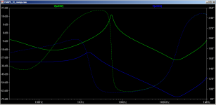

Have you taken into account the fact that the o/p inductance of the LM317 reduces significantly as Iout increases? I think Erol Dietz's measurements of resonant frequencies were for a datasheet implementation of the LM317 circuit with 5mA or 10mA Iout, but doesn't your circuit have a larger Iout and therefore a lower o/p inductance?
Hi Gopher, I tried the sim with low current, as you are correct the sim I posted above was using a 1A current source. I ran it at 10ma and there was virtually no difference.
However, I then realised that I was using my YARPS config (which is an implementation of Fred's 1 transistor upgrade earlier in this thread) and when I ran with a standard implementation the resonance peak indeed comes down
Blue is with 10ma load and yellow is with 1A load.
The version with the transistor shifts the resonant frequency up by quite a margin and also has very little difference between minimal and higher current.
Tony.
