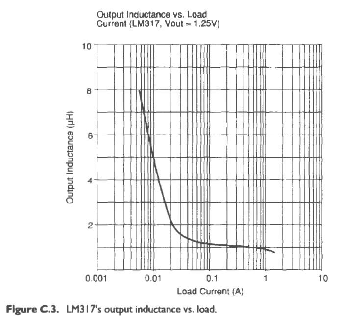

Have you taken into account the fact that the o/p inductance of the LM317 reduces significantly as Iout increases? I think Erol Dietz's measurements of resonant frequencies were for a datasheet implementation of the LM317 circuit with 5mA or 10mA Iout, but doesn't your circuit have a larger Iout and therefore a lower o/p inductance?
Actually Dietz' paper covers this as well
- so beyond about c. 50mA I'd expect very little change in the modelling ( - as I posted above)
NOTE - this graph is at 1.25v out, i.e no 'lower' R to 0v for voltage setting. That means the graph only holds if you use the optional Cadj bypass cap at higher voltage outputs (Yes, using this cap drops the effective output inductance at higher voltage output. Obvious once you think about what it does)
I have sometimes deliberately added power resistors to '317 regged supplies to push the total draw toward or well past that 30-50mA mark - on low-demand items when the raw supply / heatsinking will comfortably support it. Sometimes it seems to help by measurement, even audition.
Similar things are true of more complex regulators, too: it seems mostly to do with re' and beta in the output pass transistor IME.

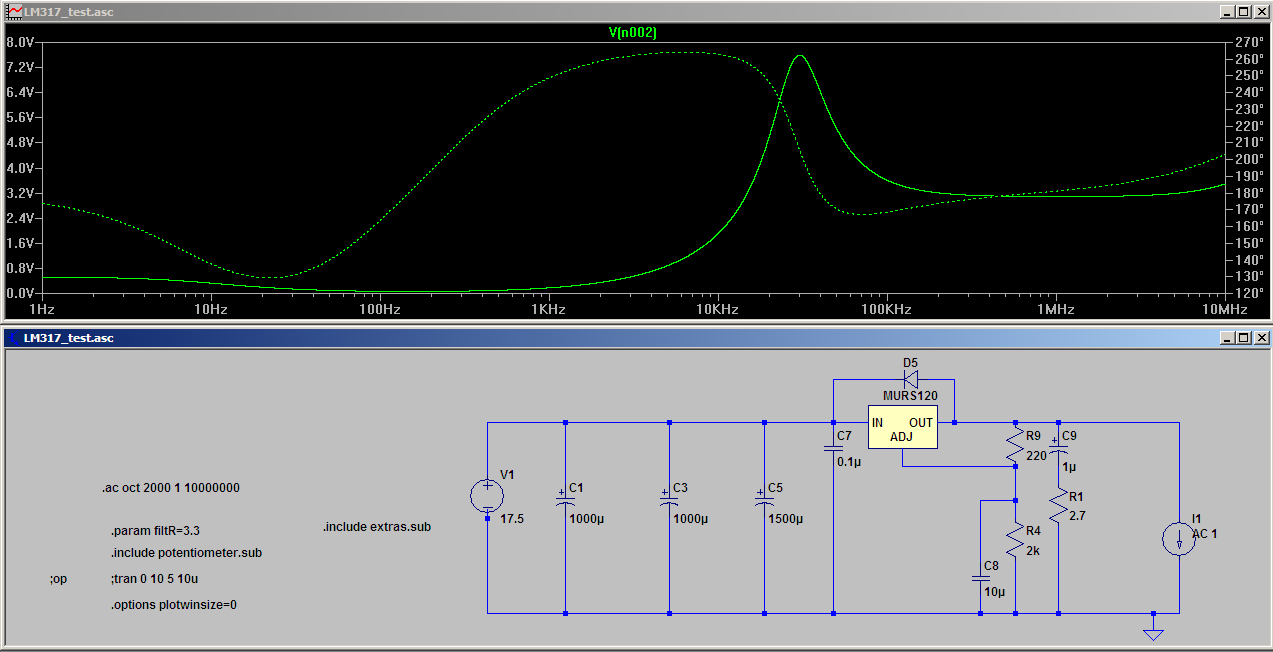

I ran the sim of my reg circuit with a 600mA current source as the load and the power dissipated in the resistor (in the case of the sim a 0.5 ohm and cap was 100uF) was 270 pico watts. I believe that this is from the residual ripple still present on the output.
With a real (varying) load this may change a little but I don't think you are going to see any significant power being dissipated in this resistor. I actually used some small SMD resistors in this place.
edit: I re-ran the sim with 1uF and 1 ohm and the power dissipated in the resistor dropped to 56 fempto watts. I guess since the residual noise is 100Hz and it's harmonics that 1uF is going to struggle to do much about it.

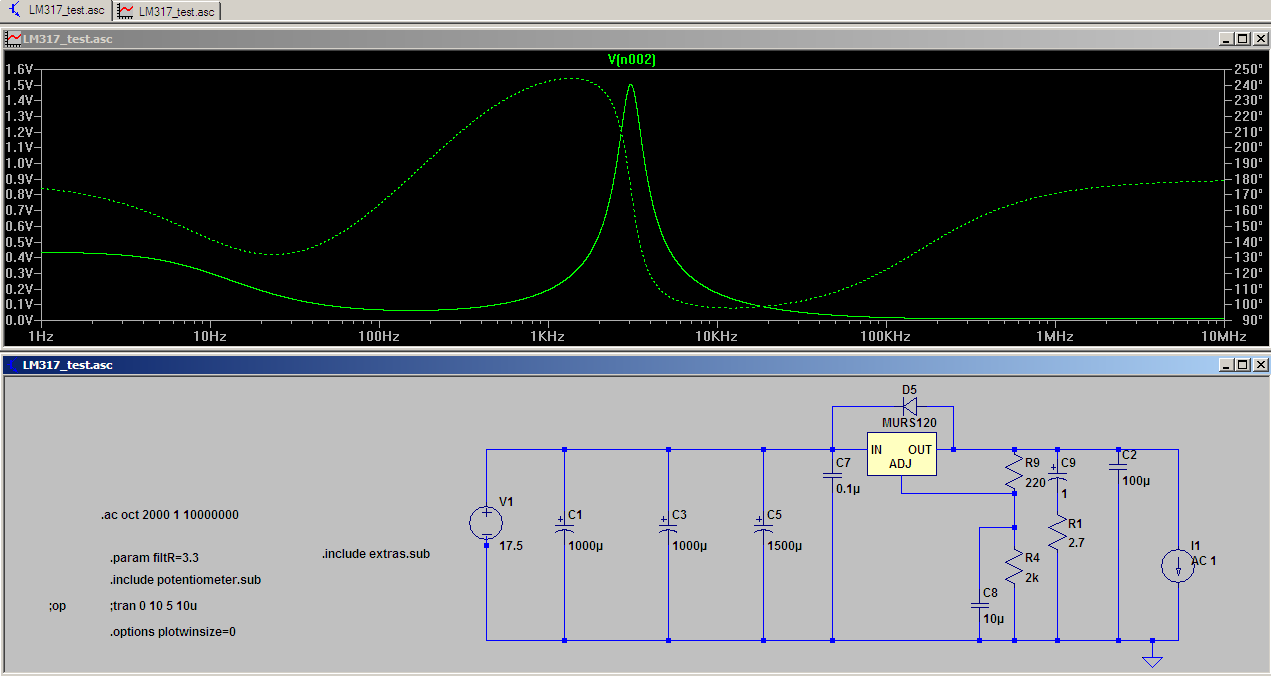

I will also add a 100u cap on the output, in parallel with the RC series network.
I assume that this is not going to ruin the damping I will aply using the 2R7, am I right?
I will try a 1/4 watt metal film then!

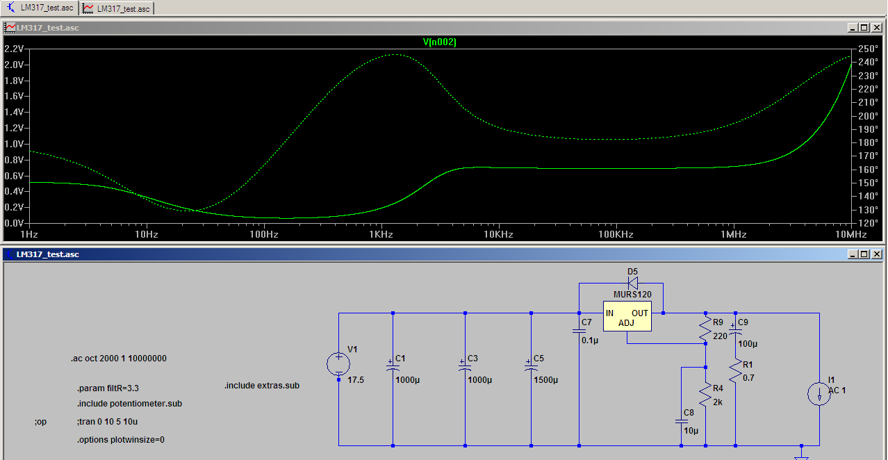

Not exactly. If you put a low esr 100uF cap in parallel with the 1uf then it will still have a resonant peak, it will be lower in magnitude and shifted down in frequency though.
On simming the 1uF with 2.7 ohms in series even that apears to give quite a peak. 100uF with 0.7 ohms in series seems to be a much better option.
edit: that last one I forgot to put in some inductance in the 100uF cap so it does not show the rising impedance with frequency.

Interesting. In one case we can see a 7.5v resonant peak. How does that "sound" or manifests itself?
It's placed at about 35KHz, so there's no chance anyone will "hear" that, but I wonder how it does affect things, directly or indirectly.
My understanding is that the power supply will be less able to maintain proper regluation at the frequency of resonance. The lower the output impedance the harder it is for the load to modulate the supply. Thus if you have a resonant peak the load will be more likely to be able to cause the PS to modulate at that frequency, and I guess if it is bad enough it will oscillate.

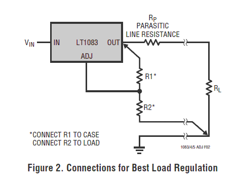

Yes, I can't remember which ones but some of the LM317 datasheets also show this. Along with the suggestion that the sense resistor (R1) above should be should be connected directly to the case of the regulator. The selection of the ground point for R2 also apparently makes quite a difference.
ok attachment is from the TI datasheet (it has a good explanation as to why), I think that the original Natsemi or possibly the Linear Technology one have a diagram almost identical to jackinnj's one. (actually I guess it was the LT one because jakinnj's one is an LT one )
I've read elsewhere, that this is probably the single most important thing for getting max performance out of an LM317.
Tony.
