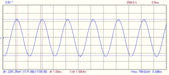

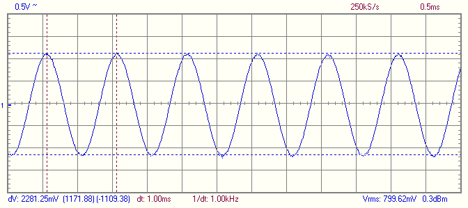

SCOPE OUTPUT NUMBER 2
Now the output was set to 3mV 1kHz. Notice there's a drift and it shows 0.3dbm.
Does this lead to any conclusion?? As I see, the output seems OK even at low oscillator levels, and maybe the problem lies in the oscilator, right?

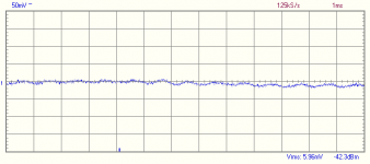

OSCILLATOR OUTPUT 10mV
Here is the output of the internal oscillator set to 10mV and 1kHz. Im no expert, but to me, doesnt look good. The wave keeps 'oscilalting' on my screen, as if there was another lower frequency behind it. My spectrum analyzer says 260Hz.

I just found out a few more things...
1-Even at 3V and 1kHz there are lots of 260Hz coming from somewhere.
2-Noise is definitely higher at lower levels, according to my spectrum analyzer.
3-It looks like theres a cover missing inside my unit. I just noticed that the oscillator part has a top cover, but mine seems to be missing the bottom one. This could be causing number 2.

Not terribly surprising if you think about it. As your signal level drops, circuit noise will make up a larger percentage of the signal. I have no way to know if it is normal or not as far as the values are concerned.
Now for the more interesting problem. Where on earth is 260 Hz coming from? Check all signal amplifier stages. Open capacitors will cause them to become unstable and they make simply be oscillating. Again, not terribly surprising here.

I haven't looked inside my analyzer in a while, but a lot of this kind of thing has internal shields referenced to some specific ground or circuit point. You definitely have to make something up, but be sure it only contacts where the original did, and doesn't short to the chassis unless it's supposed to.
bsgd said:[snip]1-Even at 3V and 1kHz there are lots of 260Hz coming from somewhere.[snip]
Could it be 240Hz? Harmonic of the 60Hz line, coming in from supply ripple? Not unusual with a) low signal level and b) missing screen cover.

At last, what I did was exactly that, connected my scope across the 680R load. You can see the output on my posts on page 5 of this thread.

Could be 240Hz, I'll have to check again since now I have the shield in place.

The 240 Hz is interesting. it 60 Hz * 4 so its unusual to be strong from the supply. Thats almost always 120 Hz. What readings to you get with the input shorted? Does the low pass filter change them?
