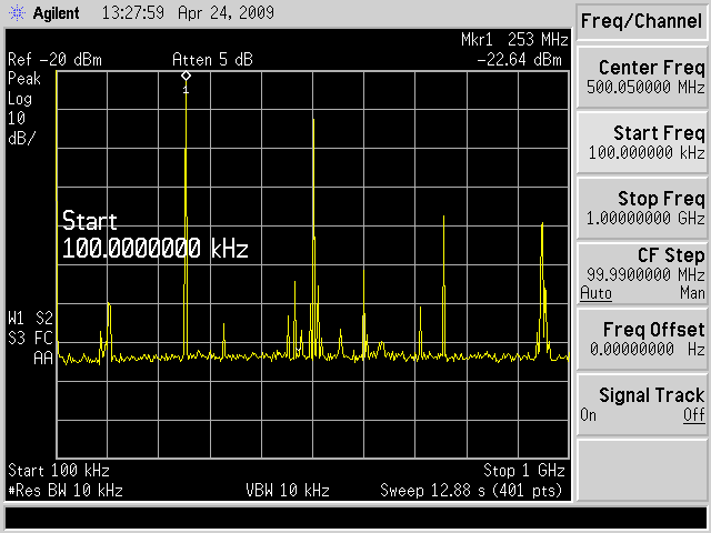

What is the frequency response we need into an osciloscope?
Also, if we need a very high frequency responsive instrument, what is the reason for that need, when audio goes to 20K and interesting harmonics does not goes above 1 Megahertz.
The reason of this question is that i have a 20 Megahertz one, and i would like to know their limiting factors... also if only the frequency response is the an important limiting factor.

Re: What is the frequency response we need into an osciloscope?
Carlos, I measured this in an audio link stage. 20MHz scope shows straight line.
