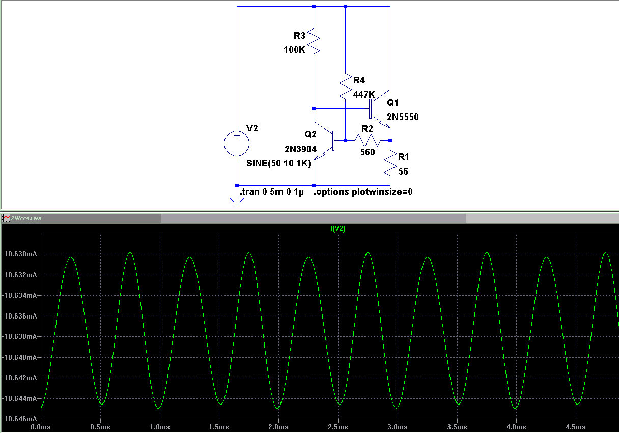

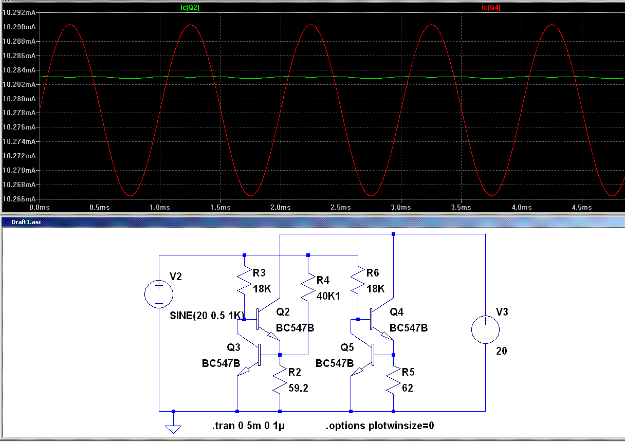

Here is a simple trick to improve the performance of the two-transistor CCS.
This type of current source has a good regulation vs. variations of the output voltage (= high output impedance), but behaves rather poorly wrt. variations of the auxiliary (bias) voltage (= non-zero transconductance).
By adding a single compensation resistor, a huge gain can be made.
In this example, a 10mA current sink, resistor R4 has been added.
The circuit on the right is the regular CCS used as the reference for comparison.
Without R4, the current variation amounts to 24µA for 1V.
With R4, this variation is only 0.27µA, almost a 100 to 1 improvement.
The value has been fine-tuned for the optimum, and R2 also had to be altered slightly to keep the same current.
I have found the values empirically, it should be possible to derive a formula.
I think it should look something like this:
The ratio of R4 to R2 equals 2(Iout/Ibias)(Vbias/Vbe) (to be checked, at first sight, it seems to work).

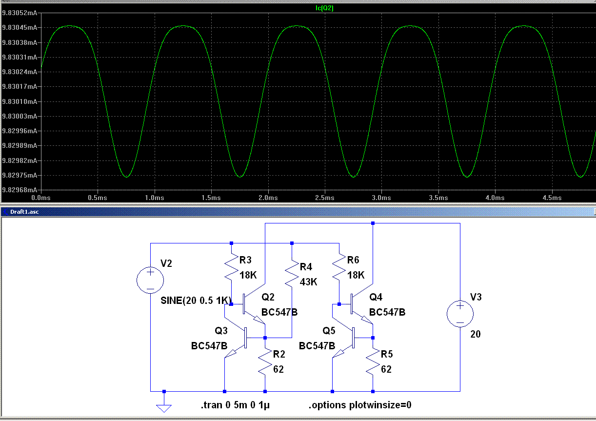

It is not necessary to use exact values: the second example uses the nearest standard values, and the delta current has increased to 0.7µA, but it is still a worthwhile gain.
With this method, the PSRR of an amplifier could be improved by 20 to 40dB.

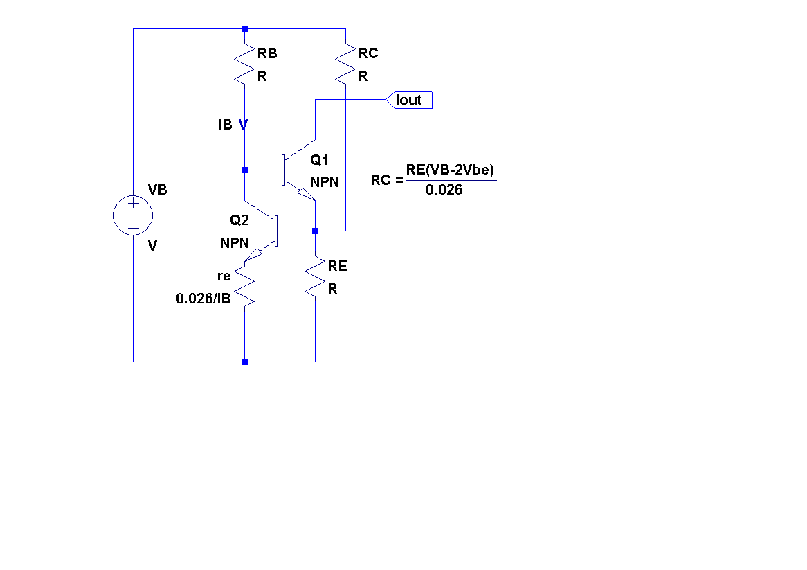

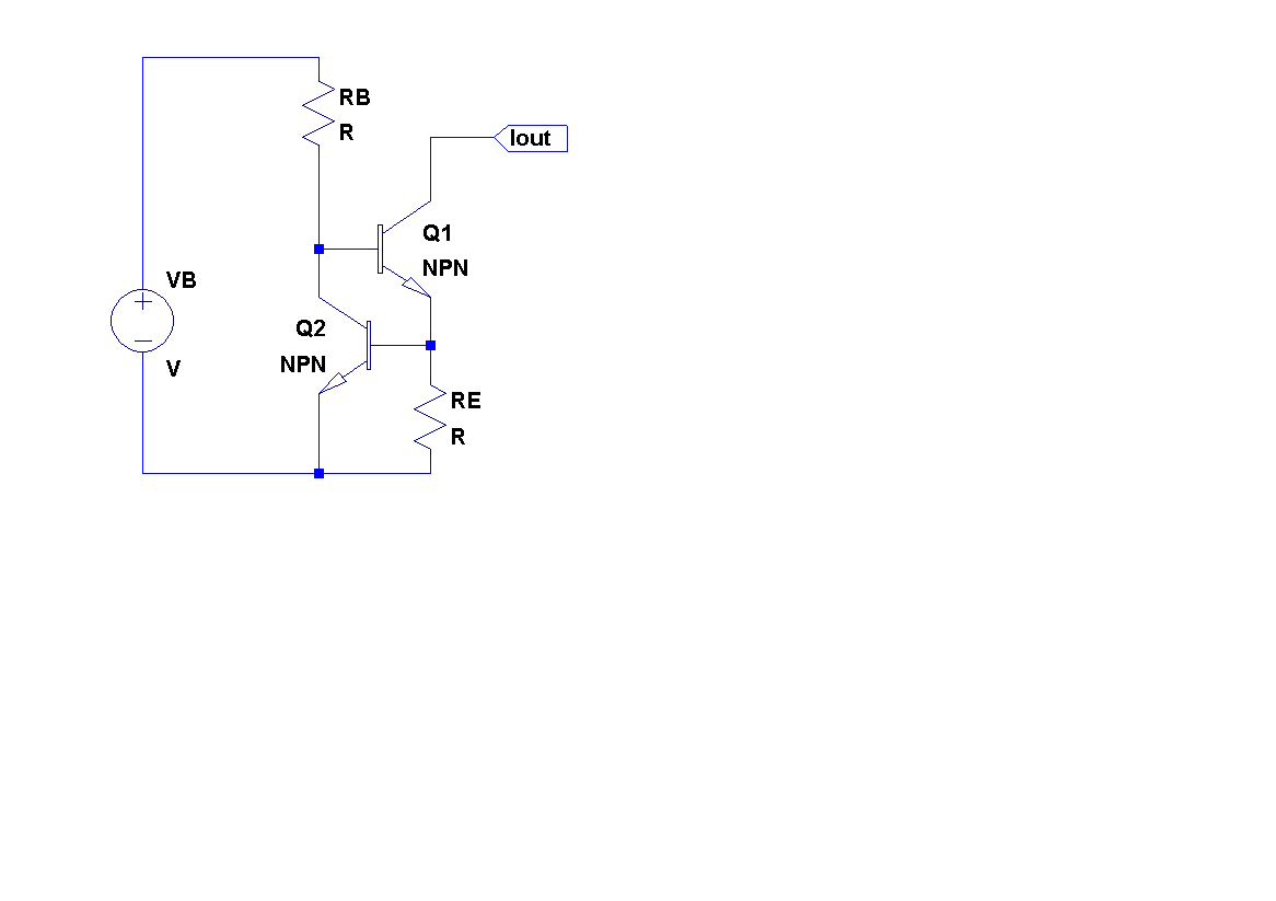

OK, let us do it properly: the formula I guessed in the first post was incorrect (I am becoming lazy with age).
If we look at CCS1, we see that the output current is determined by RE and the Vbe of Q2.
This Vbe is in turn dependent on the bias current, provided by VB and RB.
Because there is a logarithmic relationship between IB and Vbe, this means that this circuit is in fact a (crude) logarithmic converter: Iout is the logarithm of VB.
CCS2 shows the situation with the compensating resistor RC. The dynamic emitter resistance of Q2 is shown explicitly, and we can see that for the compensation to occur, the division ratio of RB to re has to be identical to that of RC to RE: this gives the relationship indicated on the schematic.
This is a first order simplified analysis, valid on the conditions variations are small, and bias current is sufficiently high, etc, but it shows the compensation is essentially device-independent.
With the values of the previous example, the formula yields a result of 43K, which is not too far off the mark.
Obviously, the compensation cannot be perfect: a linear compensation will never cancel a logarithmic effect, but for practical purposes, it is useful enough as the example shows.

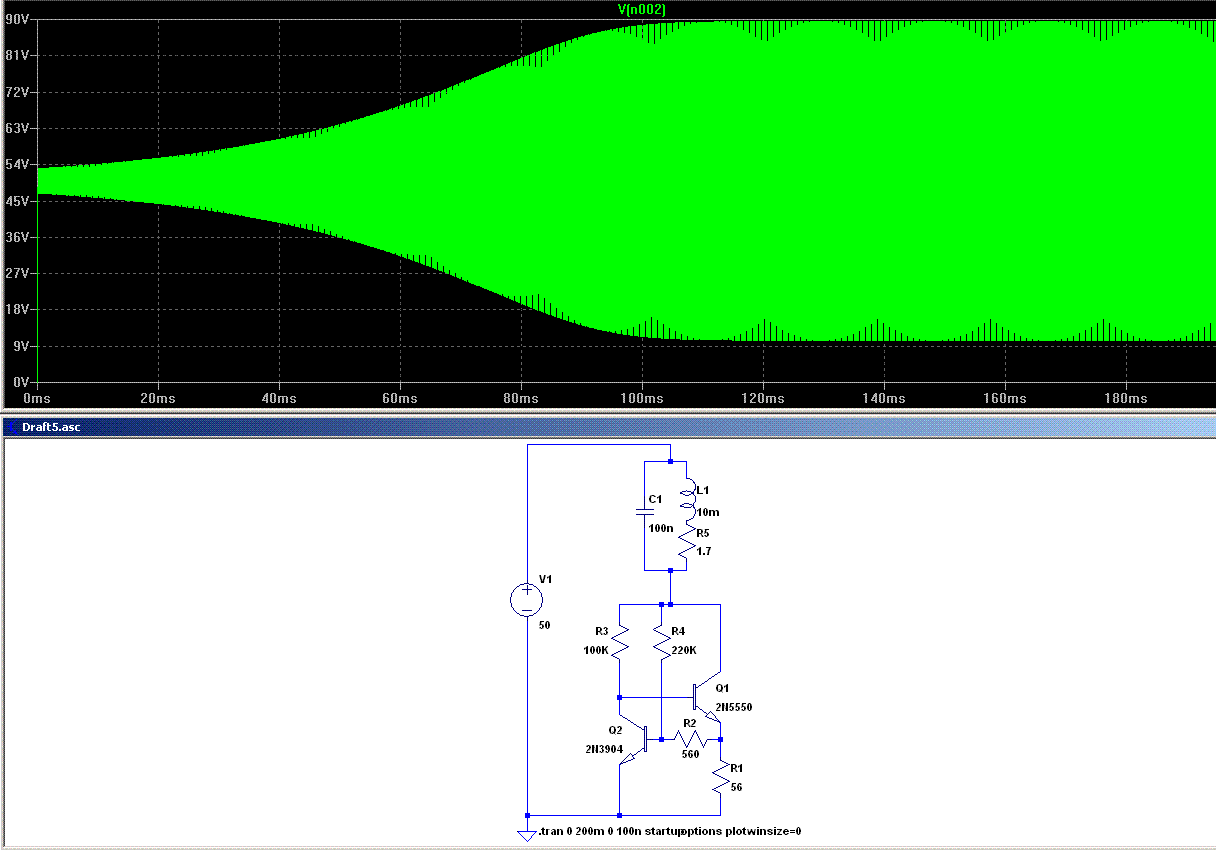

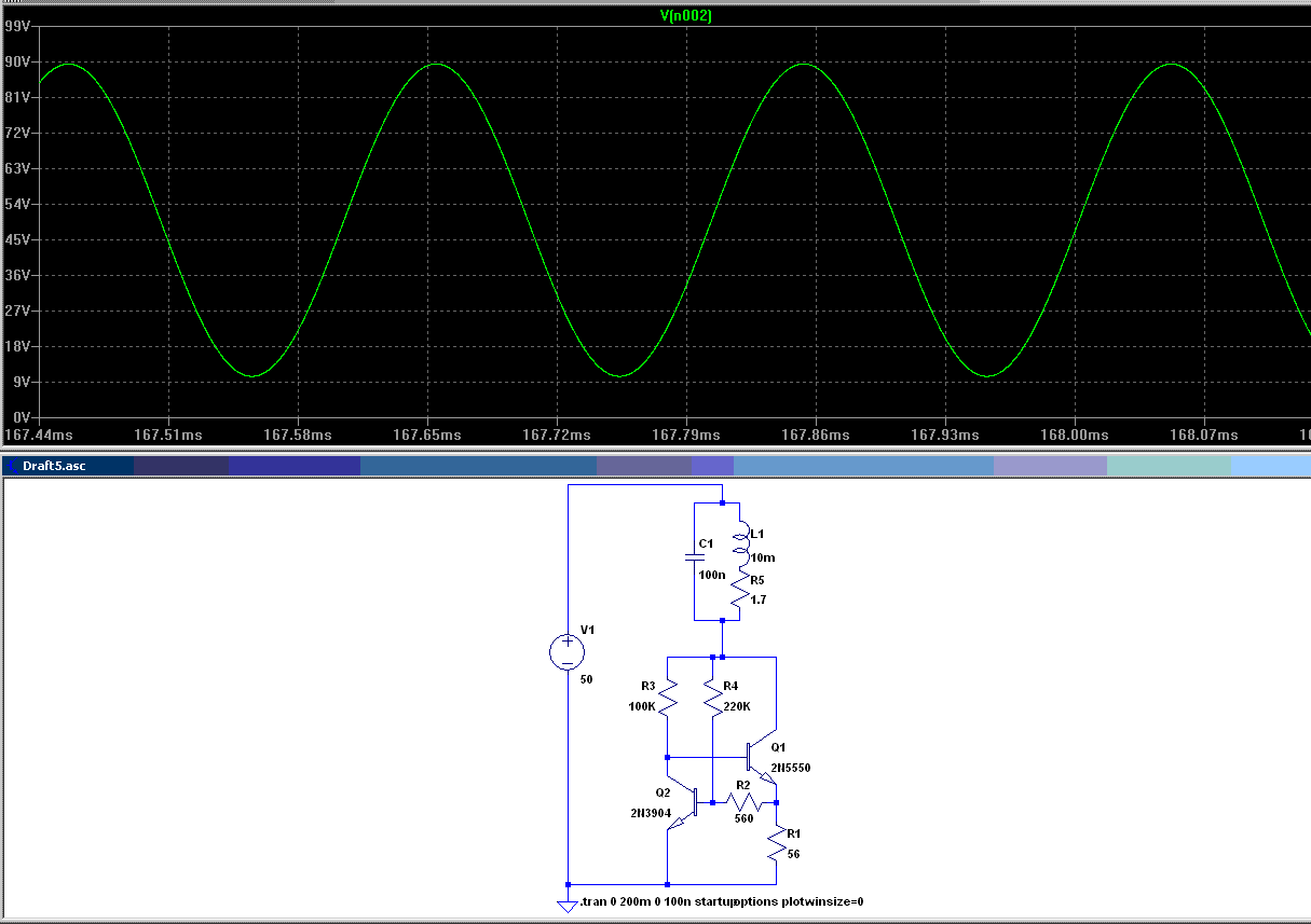

Further applications
If the circuit is overcompensated, it becomes a negative resistor.
It is the functional equivalent of a lambda diode, but capable of operating at much higher levels.

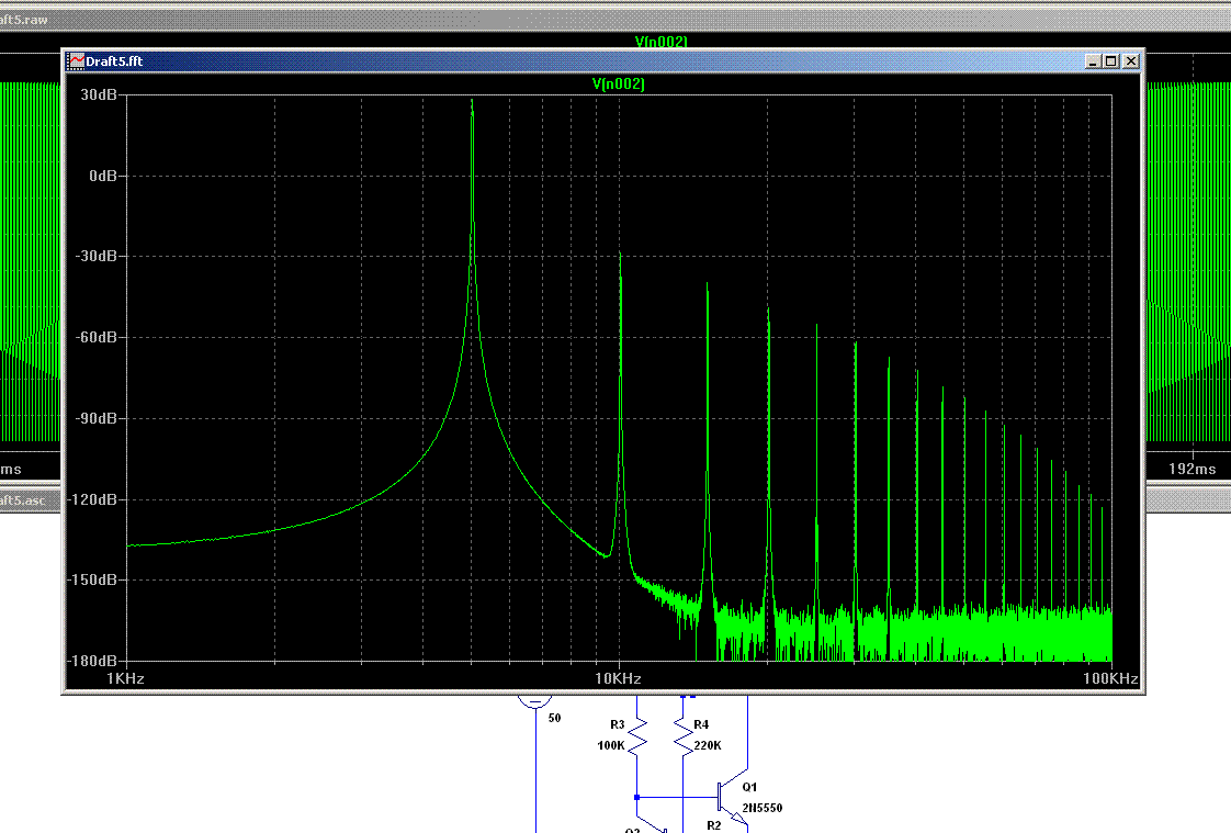

Like the lambda diode, it can be used as a two terminal oscillator in conjunction with an LC tuned circuit.
Such an oscillator is capable of providing a very high output level at a low distortion, thanks to its inherent amplitude self-stabilizing property: the negative resistance effect only exists within a limited part of the characteristic.

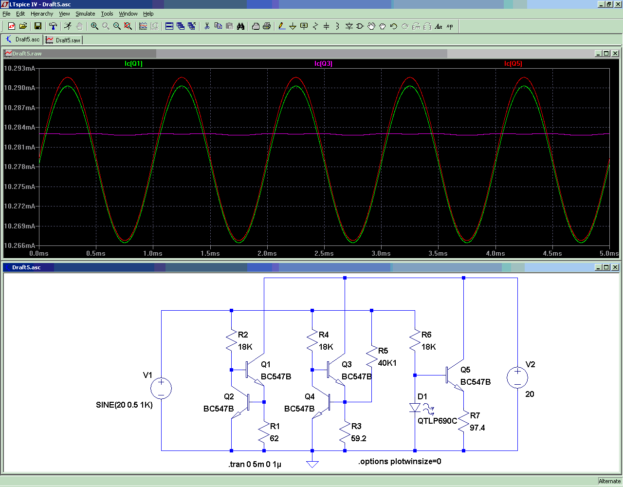

Your "normal " CCS is hardly ever used because the referance voltage (current) is the rail, compare your improved CCS to the standard LED (with a cap) voltage referanced CCS and I would bet theres very little improvement.
The performance of the LED ccs isn't better than the regular two-transistor CCS, in fact it is slightly worse.
Using an arbitrarily large decoupling cap, performances of either of the three versions can be made perfect. But if there are degrees in perfection, the LED one will always be slightly worse (and the improved one will always be much better).
Additionally, the improved CCS can be built as a two-terminal version, which means it is polarity-insensitive, and can be used with high voltage N-devices and yet be attached to the positive rail.
