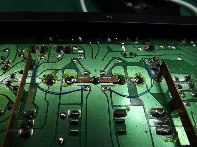

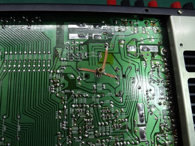

But they do take up more space and you should take great care in ensuring the lowest possible resistance between the caps, or you could easily lose all 'advantage'.
The RA-980's 1 sec 'on' delay is purely anti-thump protection, it does not restrict the reservoir cap charging (nor should it, or you'd never get the blessed thing started).
There are 'soft start' solutions using a Mosfet with a R-C filter to the gate - or even the crude old series thermistor rod used in early TV sets (but then your amp would of course only play in black and white).
As I have said before, with a Rotel's quality PSU components - I wouldn't worry about increasing up to 20,000uF, although I must admit that I have only tried up to 15,000uF.
And gone back to 10,000uF because I found the actual audible difference at domestic listening levels to be very marginal.
What is important is that you replace the old caps with high quality low ESR types and where possible decrease any resistance between the caps and trafo.
Even a broad 35um copper pcb track does need some help, see what I always do on the GND tracks in RA-820 and 931's.

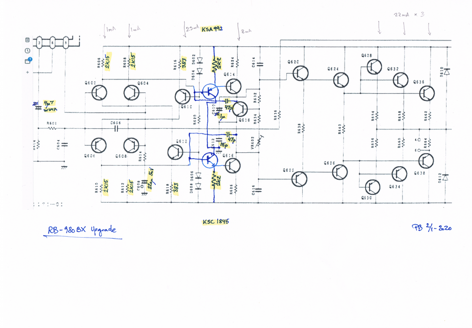

Hi Tony,
Ok, I did a RB-980 repair and upgrade for an retired music critic called Dave here in the UK and he was totally over the moon with the result.
All that really was done was putting in a couple of emitter followers and changing a few components to adjust various voltages and currents, see schematic.
Although I must warn that this is quite fiddly work (drilling and cutting tracks, etc.) and you really need to keep your concentration throughout (I am sure that Paulus would agree with that).
The new modules should make this a simple de-solder/replace procedure - I hope.

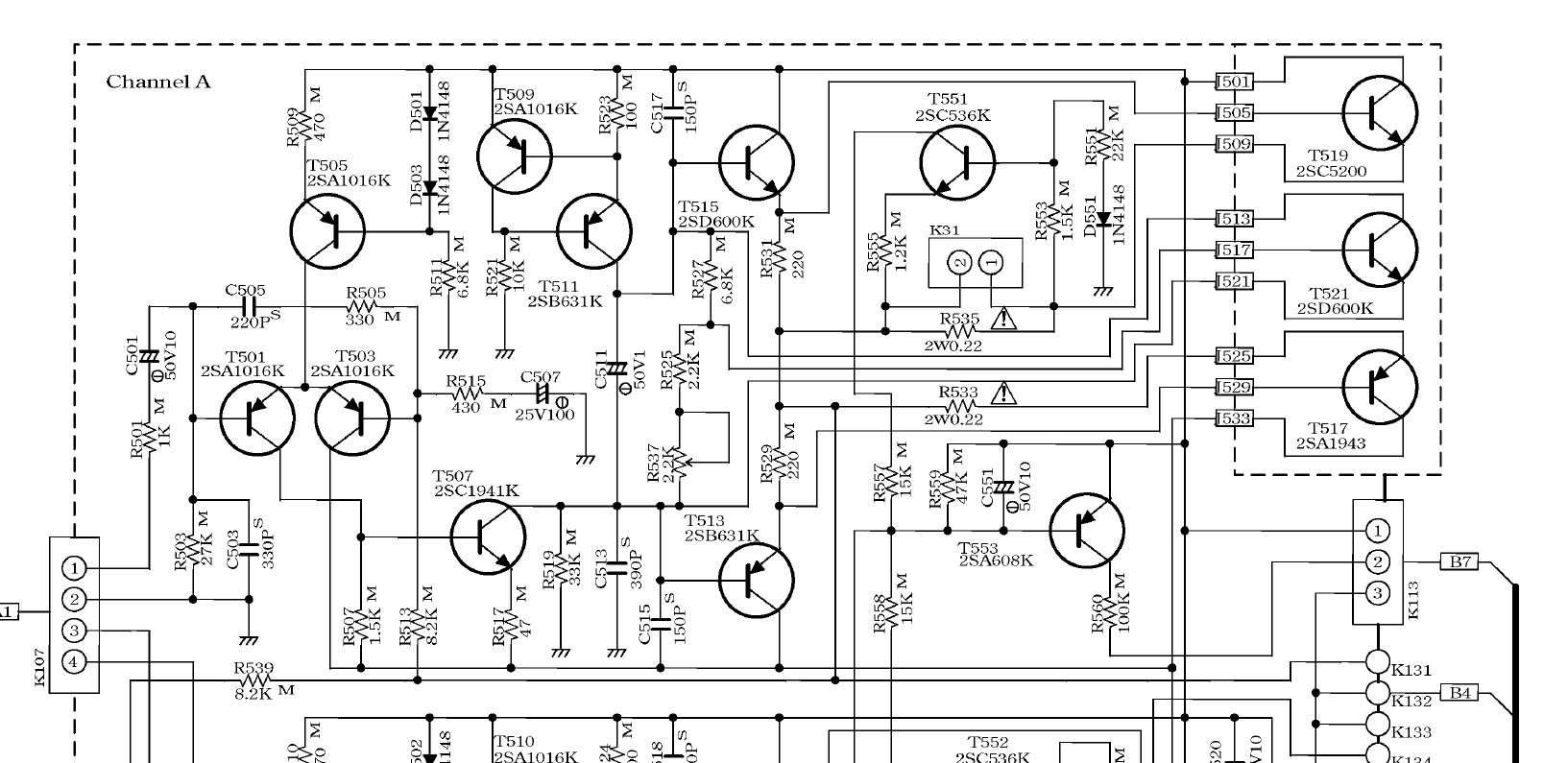

Hi Lars,
Yes, that power amp circuit schematic is exactly like the 820's (actually more like the 930 where Rotel started to put the input RC filter in (see post#363).

Great thread just found it and analyzing. Did you had chance to think about RB-976?
Just comparing schematics and tring to pick what parts of 820 stage 3 can be passed to that one.
Actualy I have MK2 version which has slightly different power output stage.
RB-976 MK2 actually looks identical as RMB-1066.
For start I plan to decrease input load and replace input trans to matched pair.

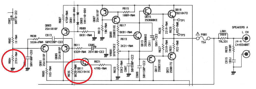

You have dropped out local power source filtering capacitors near input trans but probably I'll add them too.
Actually I have MK2 version which has slightly different power output stage.
It's really niece amp. As opposed to previous multichannel versions it has 3 separate boards, each per stereo pair. Actually I don't hear any humm on it with 105db/w speakers.
The RB-976 is a basically a box with three RA-820/RA-931 power stages inside. All the upgrades that I described for these would work well.
You'll need three full sets of CM1 and VAS3 modules, ie. 12 in total - and I have currently run out of these, awaiting a new production (actually CM2 and VAS4) from PCBWay.
I have found that if you manage to properly match the LTP and balance their dc loads, there is little to be gained from the input stage rail filters. The resulting vastly increased PSRR takes care of any 50/100Hz ripple.
