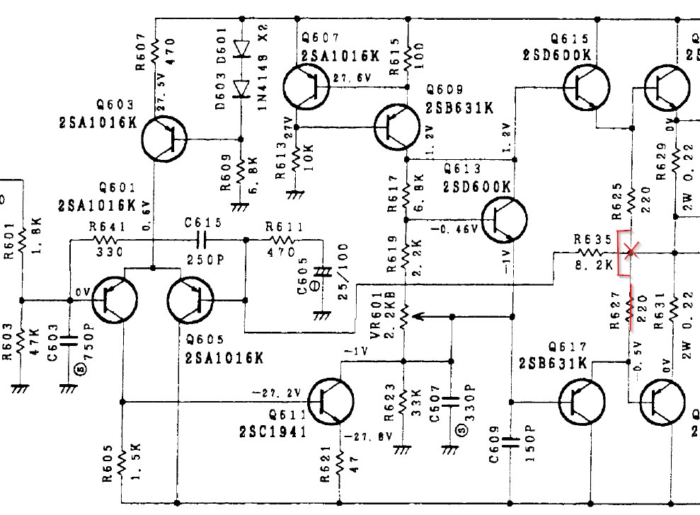

2. Some time ago you published a composite VAS including a third T3. In your example, T3 acts at the same time as the buffer for T2 and also as a "current splitter" by T3's VBE paralleled by the 330 ohm resistor. In your example, this might set the IC for T2 as some 0.7/330=2.1mA. I first saw this option in D.Self's power amplifier book, and then tried it in a Yamaha AX590 VAS modification. But that lead to some oscillation, so I discarded it again. My first question then: Do you still use this theoretically elegant modification, e.g. is it successfully long-term stable/safe in your Rotel mod's?
I am very surprised that you got any oscillation from adding an emitter follower in the circuit. I have now upgraded umpteen Rotels with the VAS3 module without any issues - and I have indeed tested and subjected the amp to some of the most difficult loading combinations I could think of.
Maybe think of it like this - if the amps has two driver stages (as eg. the RA-971) - the first low power driver stage acts as an emitter follower to reduce the load on the VAS to uA levels. You wouldn't expect any problems from this?
I did however have oscillation issues when I simply tried to replace the original 2SC1941 VAS transistor with a darlington type (to do a quick EF-VAS fix). Probably because of feedback into the EF from the collector not tied to a stable V+ or GND.
3. Did you try to include improved CM's in your modifications? I am especially interested in the EFA current mirror as published in Samuel Groner's 2011 comments on Self's designs. I have not tried this one out, and I am wondering why I am not able to find any implemented and working examples of such avariant when searching by Google. Does this EFA CM variant come along with serious drawbacks in practice?
On the RA-931 the simple CM1 current mirror works a treat.

4. Did you try to include a output-stage including Miller Cdom variant? I did this in a Yamaha AX592 and it works fine. In this mod, the Cdom of 100pF is split into two serial 220pF, and the midpoint is connected to the power device's emitters resistors's common connection point by a 1k4 resistor. Result: See the two Arta graphs.
Yes, and also found the improvement to be marginal.

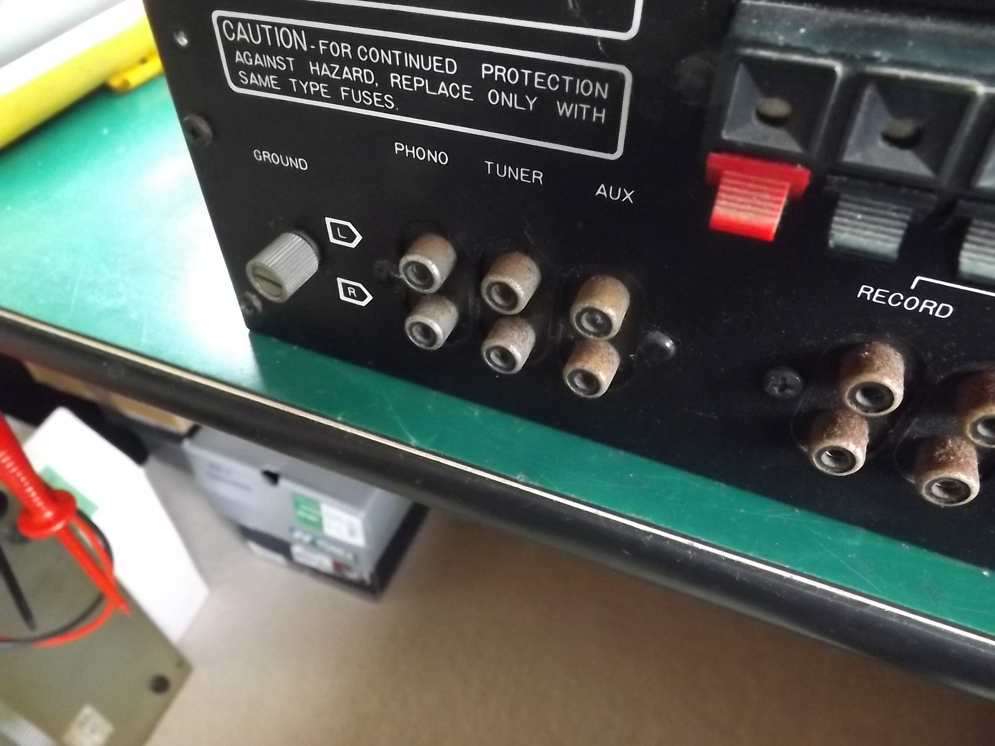

Heavens no, the old RCA's in the NAD were way past their use-by date and pitted beyond polishing up. And if you try to pull them out like rotten teeth, their brittle plastic base will crack.
So I designed and drilled an aluminium panel, painted it satin black and put new gold plated RCA's in. If more NAD3030's come through my workbench I will consider to have a double sided FR4 board made which would make things a lot easier.

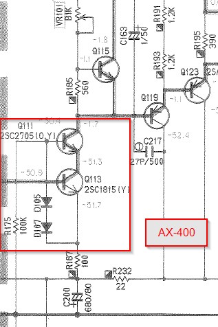

Hi Simon,

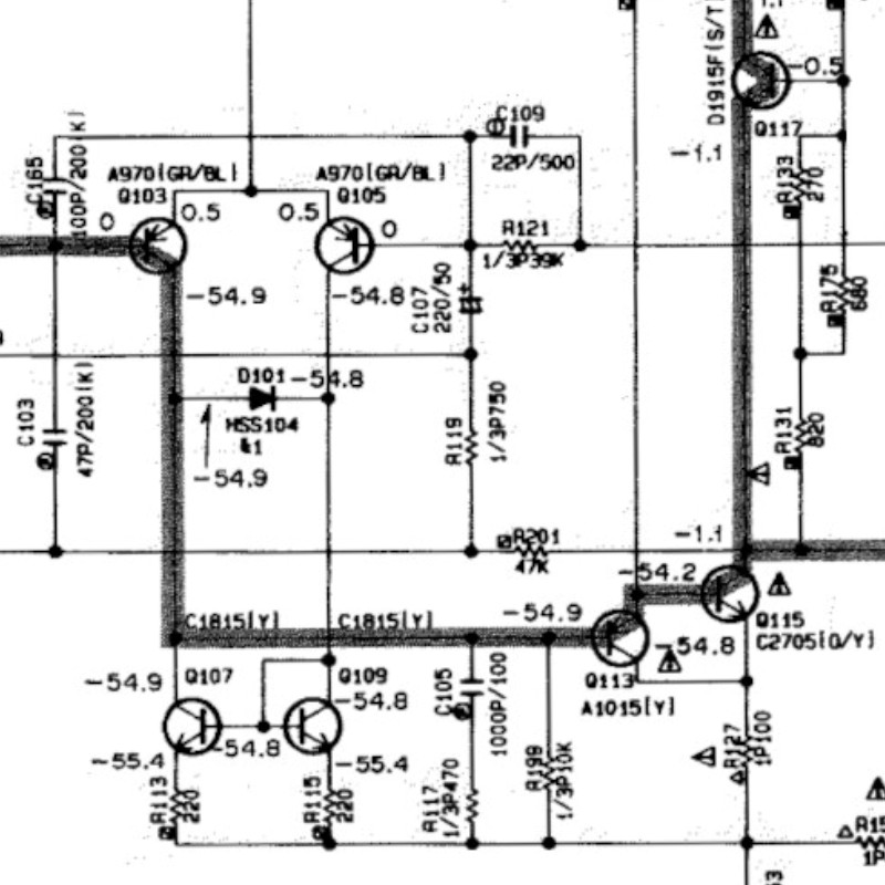

just as coincidence I have 2 Yamahas at home so I can compare sound of them and I can tell that earlier model AX-400 sounds more interestingly (for my taste) than AX-450. AX-400 sounds a bit open and a bit wider.
One significant change between those series - Yamaha in newer series introduced "EF-VAS with inverted EF" while in AX-400 it was "Cascode VAS". And the same "Cascode VAS" was used in Marantz PM80mkII which I also have and can confirm that it sounds very good.
The other change AX-400 has a bootstrap, so maybe some amount of bootstrapped PFB gives to sound something interesting...

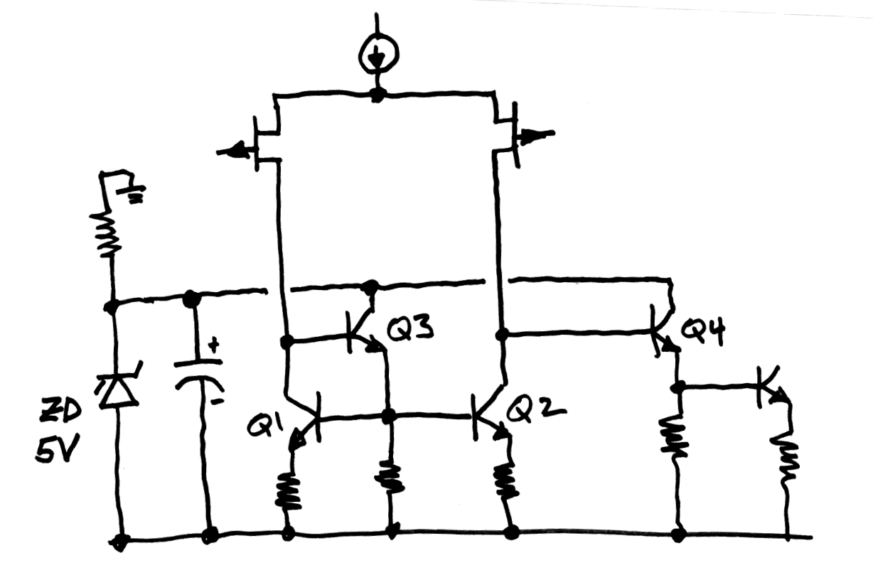

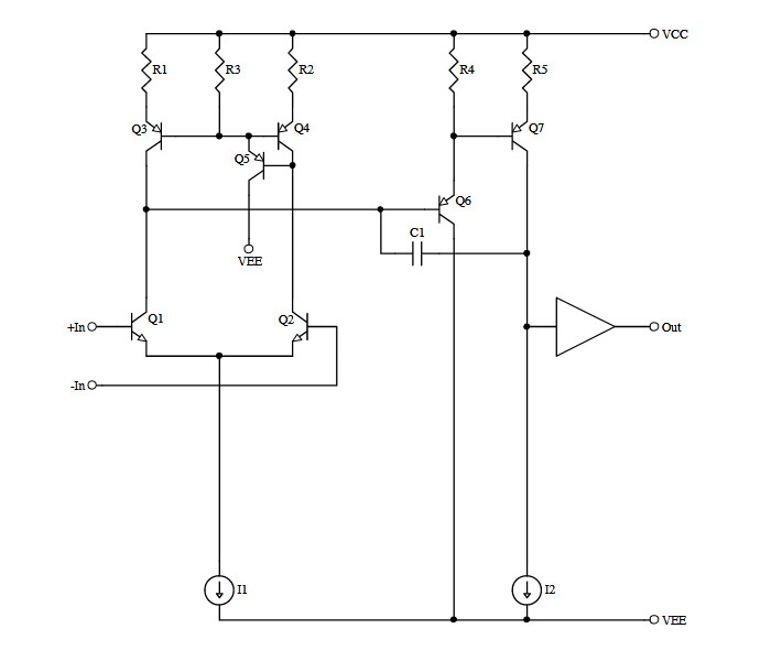

You may also take a read in Bob Cordell's great book (thank you Joe from Hamburg for pointing me to that), he describes the issue quite well although not in as much detail as Doug Self normally does.
Yes. And S.Groner, in another publcation, refers to a Paper of D. P. Laude: A Low-Noise High-Precision Operational Amplifier, IEEEJ. Solid-State Circuits, vol. SC-16, no. 6, pp. 748–750, December 1981. Unfortunately I was not able to get hold of this one.
Samuel Groner's Paper "Comments on Audio Power Amplifier Design Handbook by Douglas Self" (2011) said:
Better cancellation and more freedom for VAS biasing is achieved with theEFA mirror (figure 1). If R5 is chosen such that Q1 and Q2 are operated atequal collector voltage and R3 and R4 have equal value the error introducedby the base current of Q5 is cancelled with the base current of Q6. Overallthis topology leads to very good input stage balance and offers low drift (seee.g. [1]).
This scheme to balance out the input stage currents seems very appealing to me. But, as neither me, nor you have tried this flawor (yet?), this discussion becomes rather more and more theoratical, now. And this thread here instead started and bewared itself as a refreshingly practical thread ... No practical experciences with this one, anyone?
Maybe it might be better to move these questions into anothter thread, more prone to theoretical design issues? Anyway - The attached picture is from Groner's paper, also, and refers to to the aforementionned text. I Hope this is ok from the copyright's point of view.

I tried cascoding in the LTP current source. It did work extremely well, but I found it quite fiddly to do in practice.
For the same reason I haven't done any cascoding in the VAS stage.
Could you explain please: What was fiddly with your cascoded LTP current source? Was it the physical setup? Or some values tweaking? Something else? My own iteration of black-boxed, cascoded LTP current sources with +Rail-RC-filtering look quite fiddly/ugly, indeed.
Then Cascode vs. EF for the VAS: I would distinctly vote in favor of the EF variant, because of the two and stacked EF-VAS VBE's giving the CM more VCE to breath than a single (cascoded of not) VAS VBE ... This better CM VCE headroom was also the reason why I modded the exotic looking PNP EF of my AX592 into a more familiar NPN EF: The original PNP-variant for the EF was even worse than a single (cascoded or not) VAS in terms of VCE headroom for the CM. And also this PNP-to-NPN mod, ressembling some kind of gender reassignment for the EF, was some kind of fiddly ... Life is not meant to be easy, indeed.

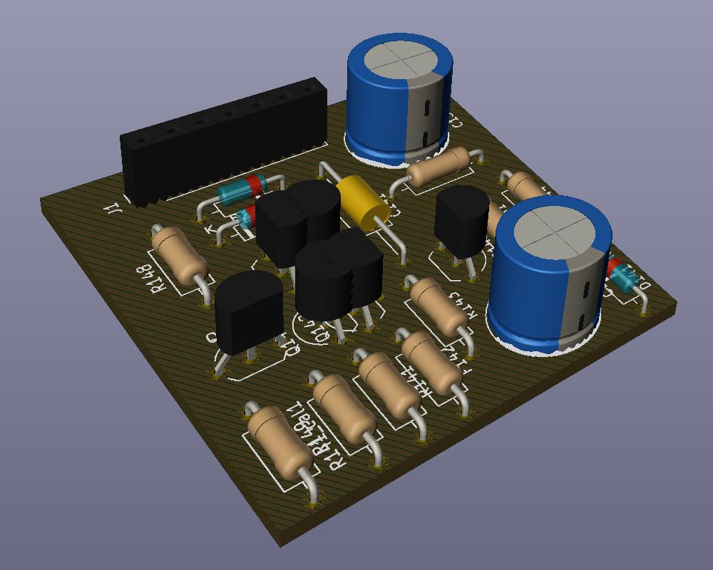

Joined 2012

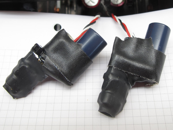

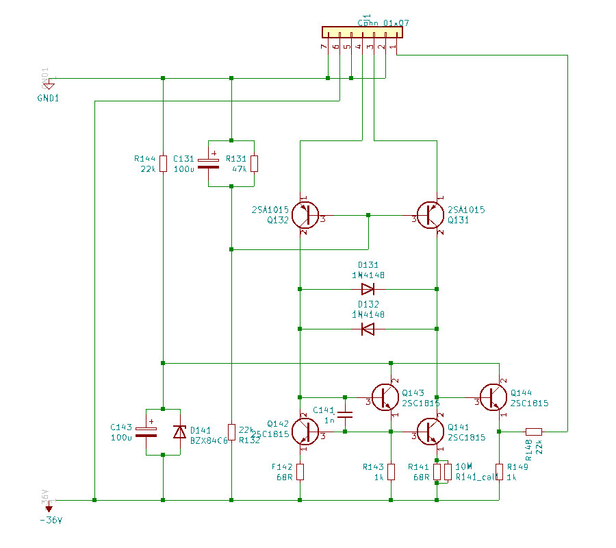

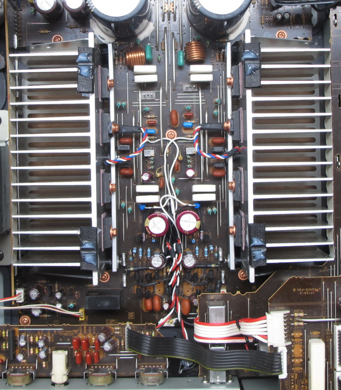

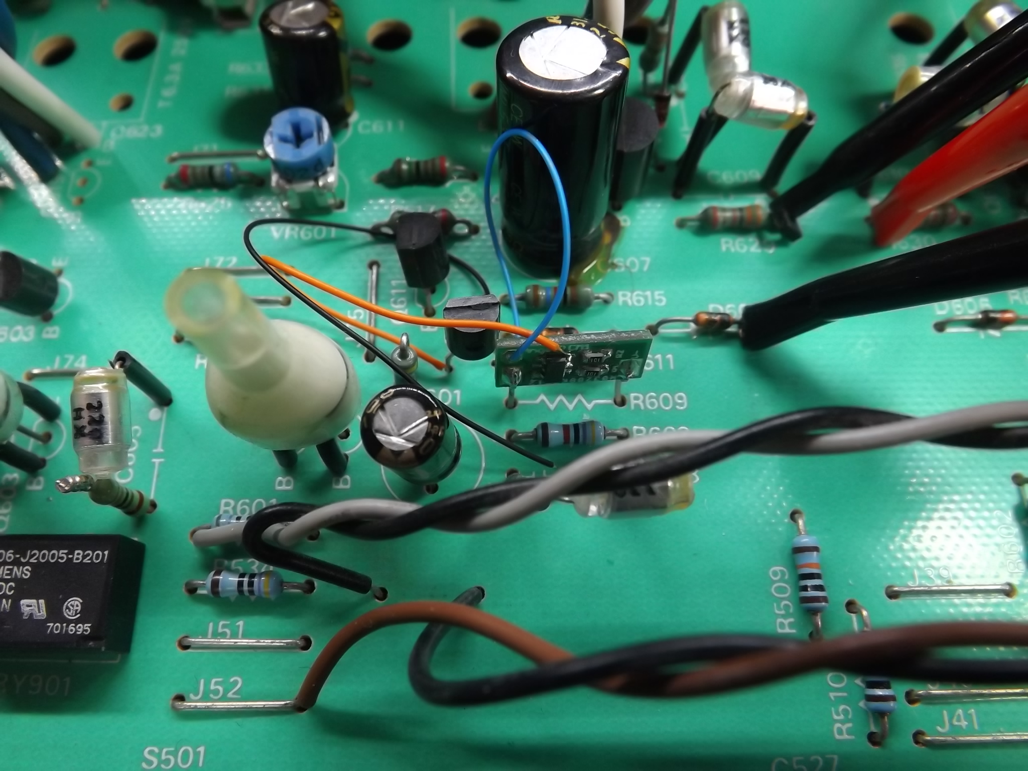

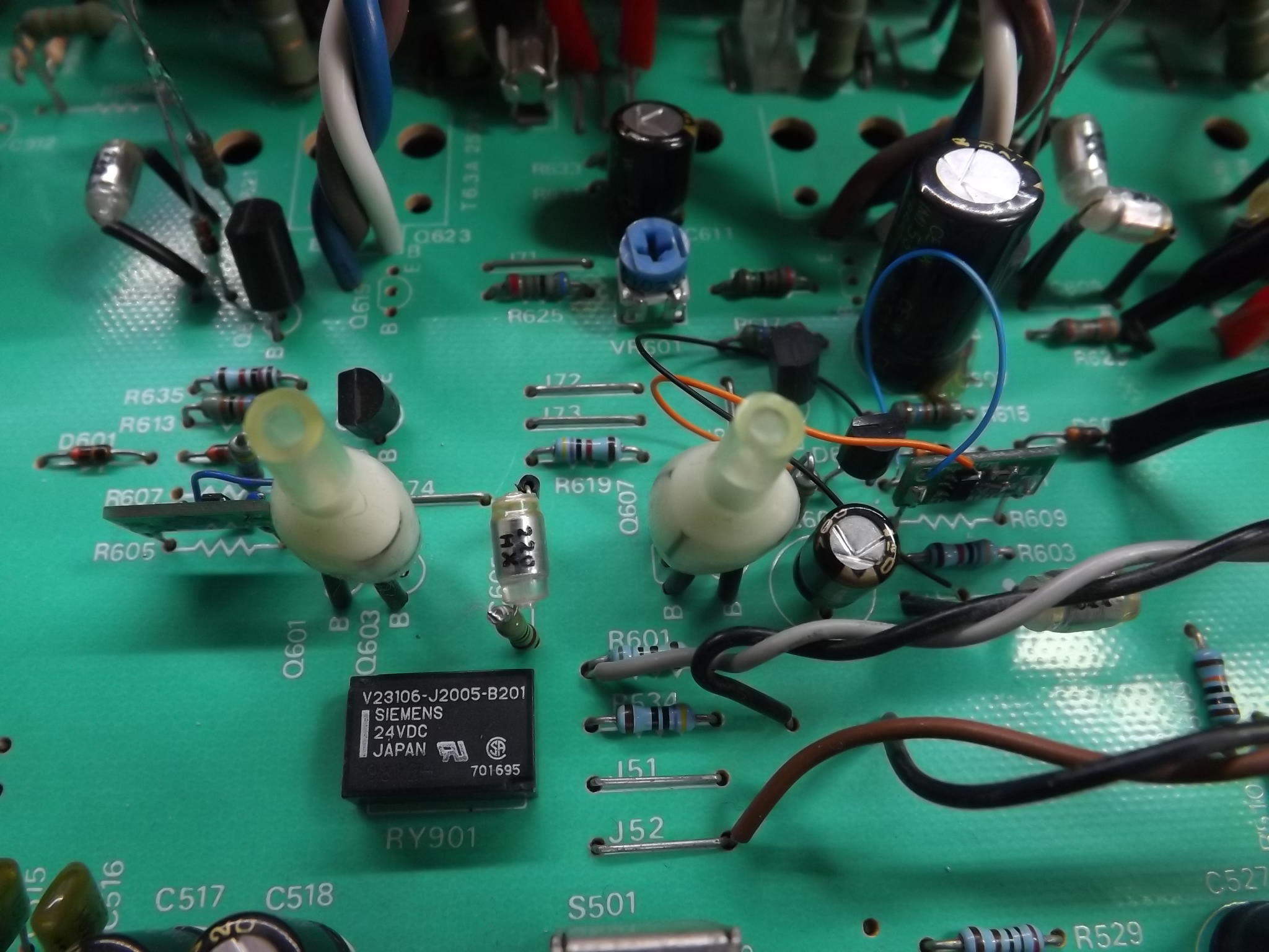

I can assure you that for me it is currently indeed a very practical issue, see pics.
Cordell suggests adding emitter followers on both the NPN and PNP current mirrors - but notes that due to component differences it could lead to some infighting over the current through the two VAS transistors.
He indicates that that would lead to an offset - for me it has led to blue smoke.:bawling:
So, my:idea: was to only use EFA in one of the mirrors - which should set a single defined VAS current.
And that is where I am at the moment.
I think someone (was it sgross?) mentioned that this issue had been covered in a thread here on diyAudio, but I haven't been able to find it.
And yes, I found the LTP cascode solution to be a practical issue, easier to do on paper than pcb.

Do you know these two links?
1. Featuring mirrors only:
Current Mirror Discussion
Much theoretical talk there, but no data of real-world implementations. Have a special look at Mark Johnson's thumbnail at post No. 327 (which is re-thumbnailed here)
2. Featuring mirrors and about VAS current setting by tweaking mirror(s) components:
2016 Burning Amp Festival speaker: Bob Cordell - YouTube
Bob Cordell in full action at the burning amp fest 2016, with focus on enhanced mirrors especially from 17:20, from 33:55 and from 47:00
After all this current reading and mirror watching and along with a modder's spirit, M.Johnson's thumbnail made me think of the EF (Q4 on M.Johnson's schema) as a component potentially nicely fitting next to the CM onto the same modding-boardie. Along with some more components providing an extended functionality. I had this idea for four main reasons:
1. Because both EF (Q4) and CM "helper" transistor (Q3) could be seen as a functional, mutually depending pair providing current and voltage symmetry for the input LTP's collectors. Therefore both Q3 and Q4 can be regarded as functional partners providing a further improved mirror functionality.
2. Both Q3 and Q4 might be supplied from a common rail/point. So, besides adding Q4 and it's emitter resistor to the CM-piggyback-board, also add the properly decoupled power rail for Q3/4 in terms of another one or two resistor(s), a capacitor and maybe also a zener to the board.
3. Last not least, as another profit, Q4 would provide some uncritical low-impedance connection from this board, to the "regular" VAS on the motherboard.
4. No need to "fiddle" an EF in/onto the main board if there is no original EF yet.
To complete the board, there might be a place provided for Cordell's UHF-stabilizing Cstb and for the two clamping diodes (Cordell's video from 48:20) for better clipping recovery.
There is one slight drawback: This 5-legged FEPCMMPU would make for a far bigger board than your original, nice tiny CM boardies. The 5 connecting points by themselves are not so critical: Of these 5 connections 3 of them would be quite low impadance (Gnd, V- and CM_out). Only the other 2 of them would connect to high impedance points such as the input LTP collectors, which would call for some care when mounting the FEPCMMPU onto the main board.
PS: FEPCMMPU means FunctionallyEnhancedPrecisionCurrentMirrorModPluginUnit.
PPS: And hey - by the way - what does RAP mean? RoastingAtPowerup - or the like?

Hi
Sorry for maybe being some kind of self-indulgent ...
These pictures might illustrate what I meant with the idea of a functionally extended, modder's current mirror board: The circuit, which relates to the aformementionned links, comfortably fits on a 40mmx45mm board using standard tht components.
It includes a helper Q143 (along with C141 for stability at high frequences) for better current and voltage symmetry of the base current mirror Q141/Q142, the Q144 EF for the VAS, two diodes for better clipping recovery, and two cascode Q131/Q132 to provide a GND-referenced, PSRR-friendly connecting point for Cdom. Caveat: The component values are very approximatively chosen and maybe not suitable.
Regards
Simon
